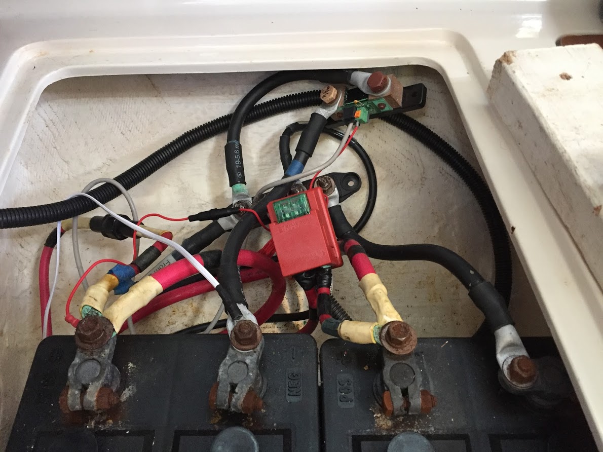

Batteries.JPG Here's a picture of the corrosion. The stainless nuts on the battery posts were all new 6 months ago. (I haven't rebuilt the hot side yet.) I also added about a quart of water to the two batteries yesterday. That seems like an awful lot to me. I'm worried that the charger is over charging, although I don't know why. I'm hesitant to upgrade the batteries until I know I won't have the same problem with new ones (probably 4 GC-2 6V, still deciding if I want to use all 4 of them for the house with a new 27 for "starting", or keep them wired as is).

Here is what I find most interesting about the picture, the corrosion on the battery terminals seems far more sever then the corrosion on the grounding buss in the picture. What are the relative ages of the buss vs. the nuts on the batteries?
My first thought might be cheap Chinese stainless steel on the washers and nuts, where did you get them?

I'm pretty sure I replaced everything (except the battery clamps) at the same time. Can't remember where I got the nuts for the battery terminals; the buss nuts came with them (Blue Sea). Of course the buss is farther away. All of the new crimped terminals (negative side only) look about the same-not as bad as the nuts, however.

Your batteries are likely shot. You will need to determine at which point they start gassing by opening up the cells and looking in with a flashlight (wearing eye protection). Use the custom settings menu of the charger and start at 13.6V and re-program & work your way up to 14.4V +. If they begin gassing/bubbling robustly below about 14.3V then the batteries are the problem. The other problem could be high shore side loads bumping the charger back to an absorption cycle, or faulty dock power that blacks-out and regularly re-boots the charger. I have boat loads of those chargers out there without corrosion issues & many of them are set to 14.8V for absorption.
Any time you do work on batteries a terminal protection grease or spray should be used on the terminals, lugs and busbars etc.. That said I suspect it is your batteries that are the issue..
One of the safest solutions for shore side charging, to avoid inadvertent bumps back to absorption, is to program the charger to not exceed 13.4V by using the custom menu and setting both absorption & float to 13.4V..

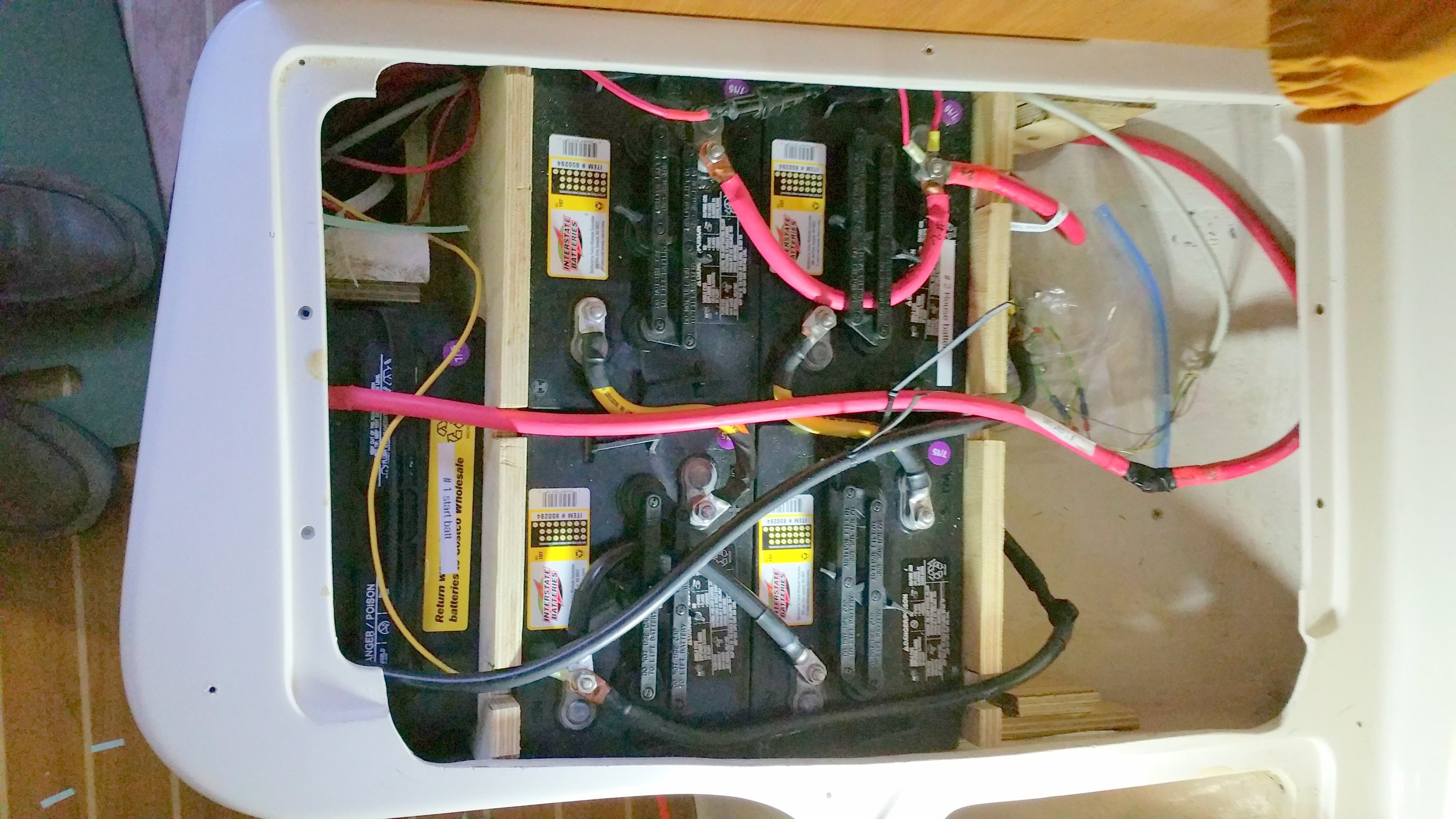

My new batteries, Aug 2015.
paulj
:hook2:
Paulj, it looks like you've wired the 4 6V batteries as bank 1, with a separate 12V bank 2. Your battery orientation isn't what Maine Sail suggests is optimum (http://www.pbase.com/mainecruising/flooded_battery_orientation). Maybe not a big deal, but did you consider orientating the 6V batteries the other way? Looking at KZW's batteries his are also bow/stern, rather than port/starboard.

Well now there is a picture on........ how not to have your batteries orientation.
I had a 50 % chance of understanding on how to place the batteries...but I did get the 12 volts:plus:.
paulj
:hook2:
As long as you don't heel the boat it won't matter!! It's certainly easier to get them to fit your way, and Catalina Yachts installed the original 4Ds the wrong way too. And I agree, 12 V is much better than 6, 18, or 24!
