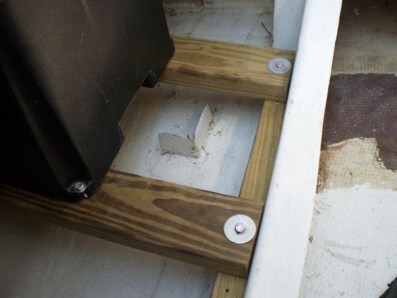

ODay 25 Cambridge
I have an oday 25 with a 9.9 yamaha high thrust. I installed two agm 6 volt batteries in a battery box under the cockpit. The batteries are just aft of the cabin bulkhead. AGM batteries do not require as much maintenance as lead-acid batteries. I have to remove/loosen the lag bolts holding the box in place to maintenance the batteries. The install was done using pressure treated 2x4s bolted thru the stringers running parallel to the water line.
