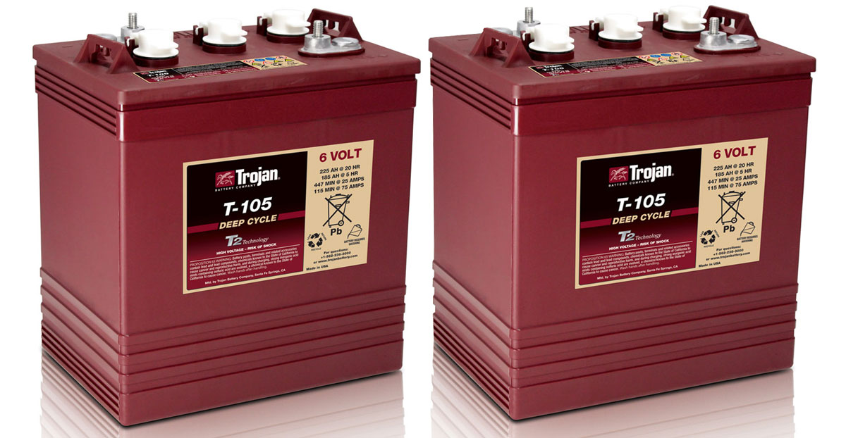

Yea, I think these are the old almost square 4D group batteries. I couldn’t get a good look at the label. I just recognized them as 6v with only 3 fluid caps. They look almost exactly like these.
After much research I replaced my 4D batteries on our ship with the Trojan T105's, they are the best bang for the buck, true deep cycle batteries, there are no better FLA batteries for a sailboat than these.
