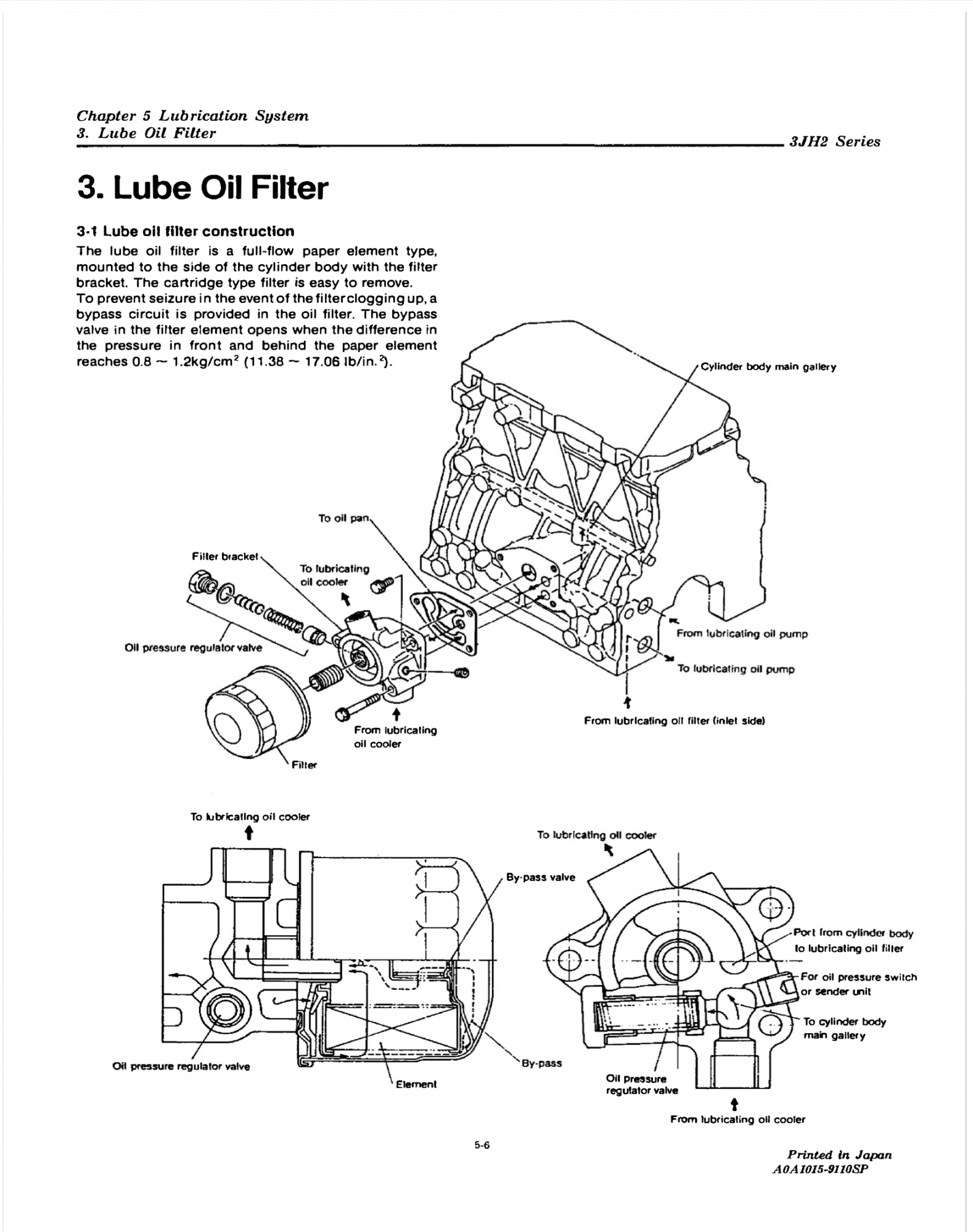

The pressure relief valve, as I understand it, isn't a function of the absolute pressure; rather it's the differential in pressure that it's functioning on.
The actual pressure across the filter -- is different because of bernouli's principal. The bypass has a different flow within the filter, anyway (greater the flow, lower the pressure -- lower the flow- greater the pressure.). IF the system is STOPPED-up (or essentially so), then the pressure is (more) even -- one of the laws of hydraulics. When thinks are flowing, different things are happening. The closer to STOPPED, them more it's even in the system.

...SG I’m not getting you point on the oil filter post it has lost me, sorry, the video clip first one demonstrates principle related to fluid dynamics and hydraulics. The second one is part of my point. Your oil pressure gauge if you have one show the oil pressure in the system, Are you trying to tell me that pressure is not sitting on the relief valve.. If so please explain for dummies. (or perhaps we should open another post ? Also in fact older diesels did not operate at higher oil pressures, ala tractors buldozers etc. My understanding is oil pressure should roughly relate to RPM, diesels typically slower so pressure can and was less often below 30 psi. Modern day diesels aka Yanmar are typically higher. Anyway happy to agree to differ or be corrected.
The bypass in the filter is regulated by the difference in pressure of the oil on the pump (before filter) and the engine (after filter) The bypass is a small plate that has oil pressure on both sides and the difference in this pressure is due to the thickness of the oil and the degree that the filter media is plugged. There is a small spring that controls at what difference, the bypass opens. When the filter is clean and the oil is warm you will have very little difference (60psi/59psi i.e. 1psi difference) so almost any spring will work. The primary purpose of the bypass is to prevent oil starvation on cold startup. In very cold weather with a high bypass valve pressure(55psi), the oil is like molasses and will not go through the filter media so you get a large difference (60psi/10psi i.e. 50psi difference) so a 55psi bypass will not open and the bearings get nothing until the oil warms up enough to go through the filter.

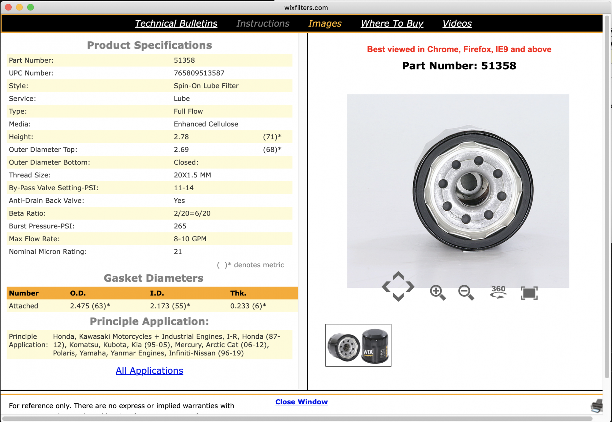

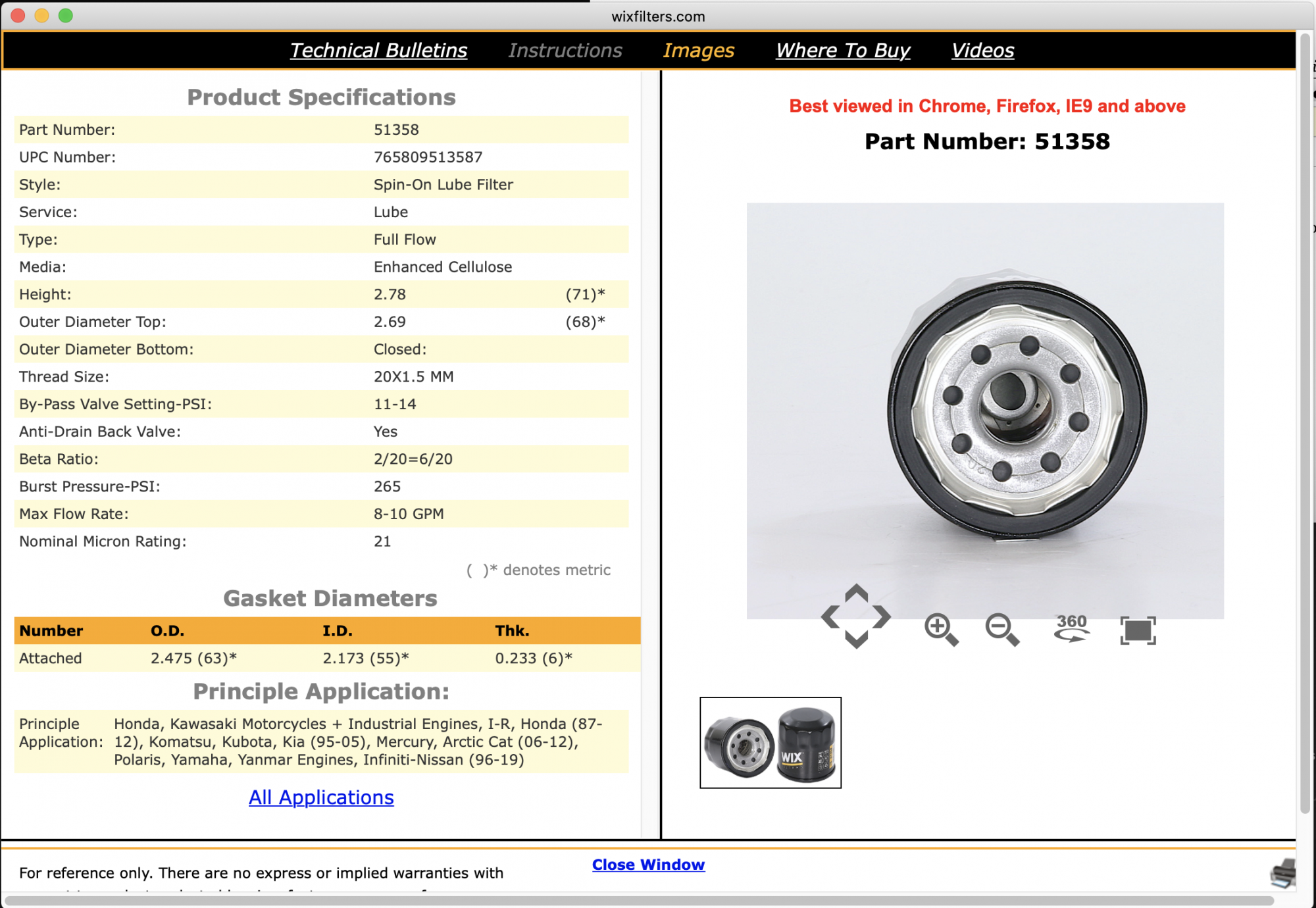

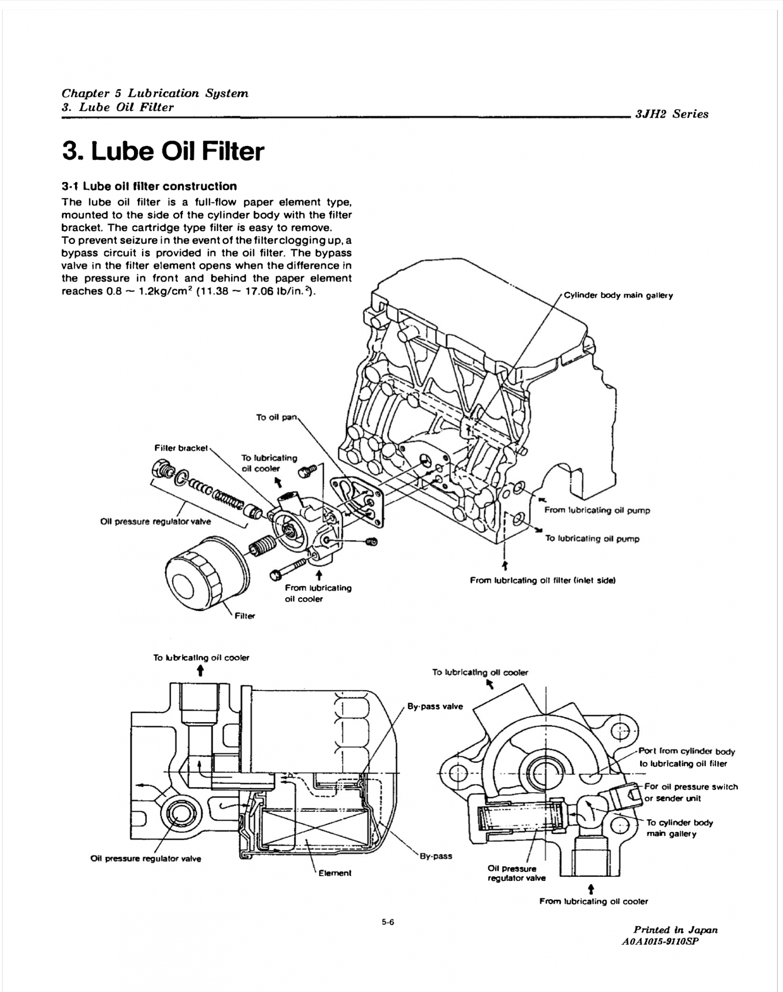

Had time to look up the specs.
According to the Yanmar Service Manual for the 3JH2 series, the oil bypass valve setting should be between 11.38 to 17.06 psi.
According to the WIX website, the 5138 filter has a bypass valve setting of 11-14 psi.
The WIX 5138 certainly seems to meet the Yanmar specs. It will potentially release unfiltered oil before the max pressure that Yanmar specifies, however, dirty oil is better than no oil.
Edit: Added the original quote from @screensaver about oil filters.

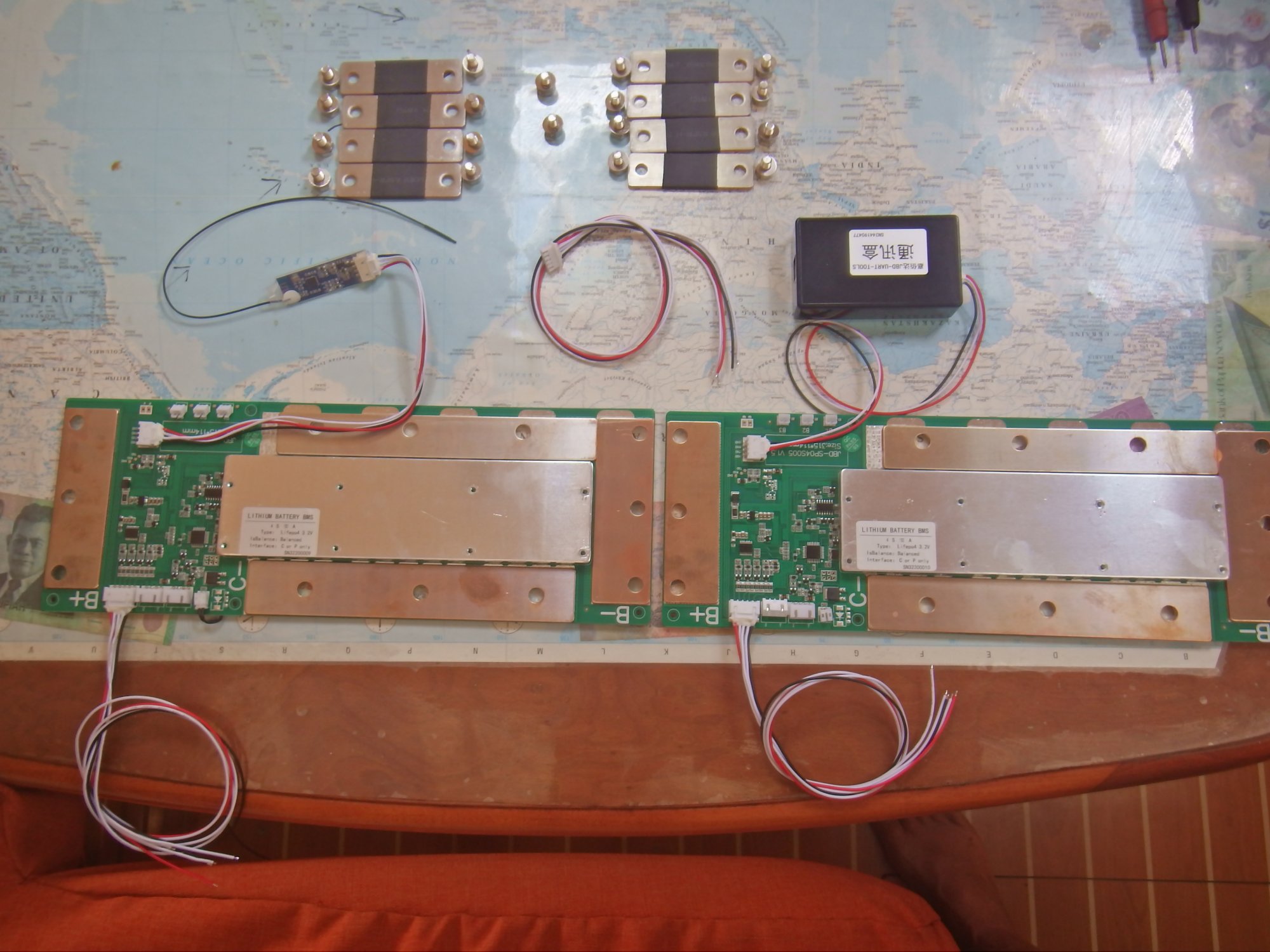

Update 11/3/2020:

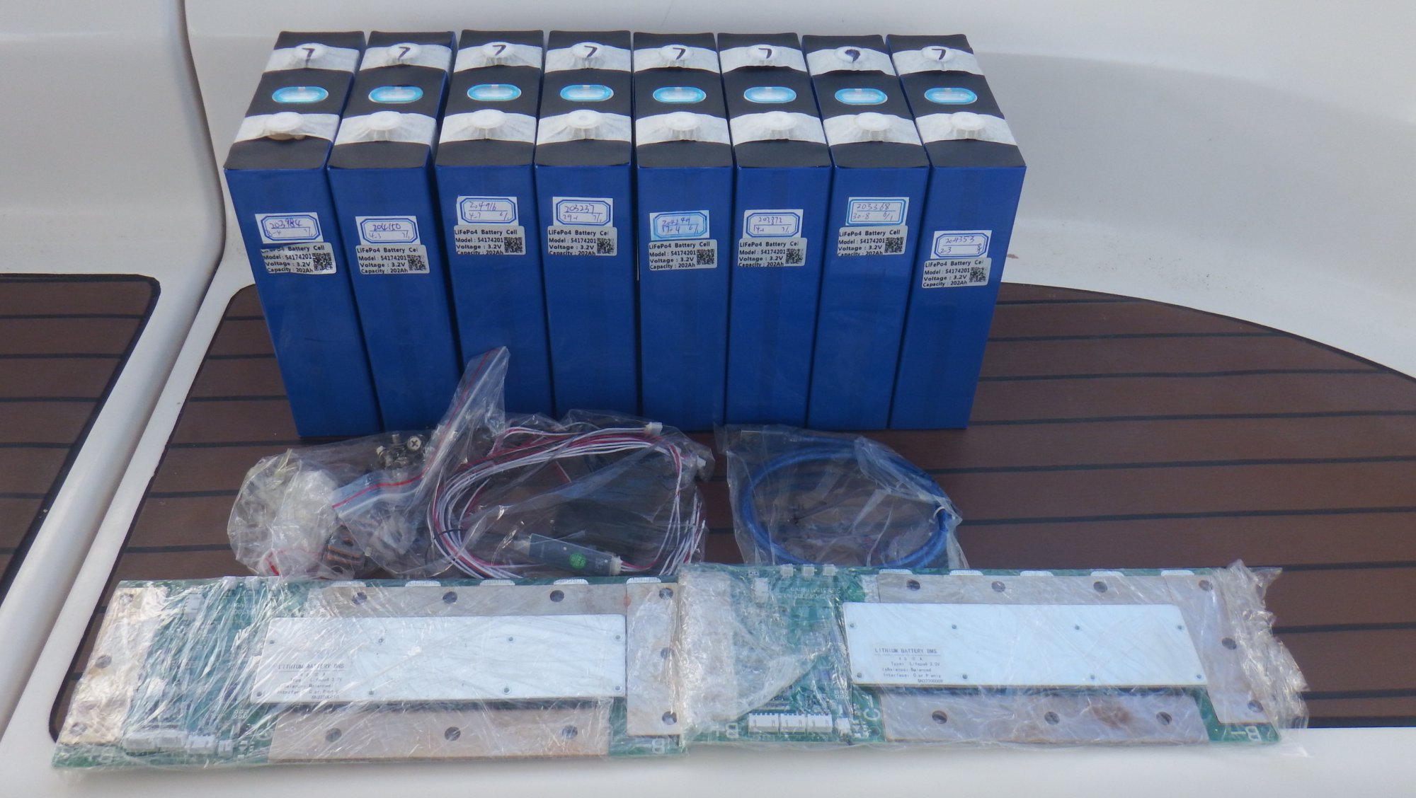

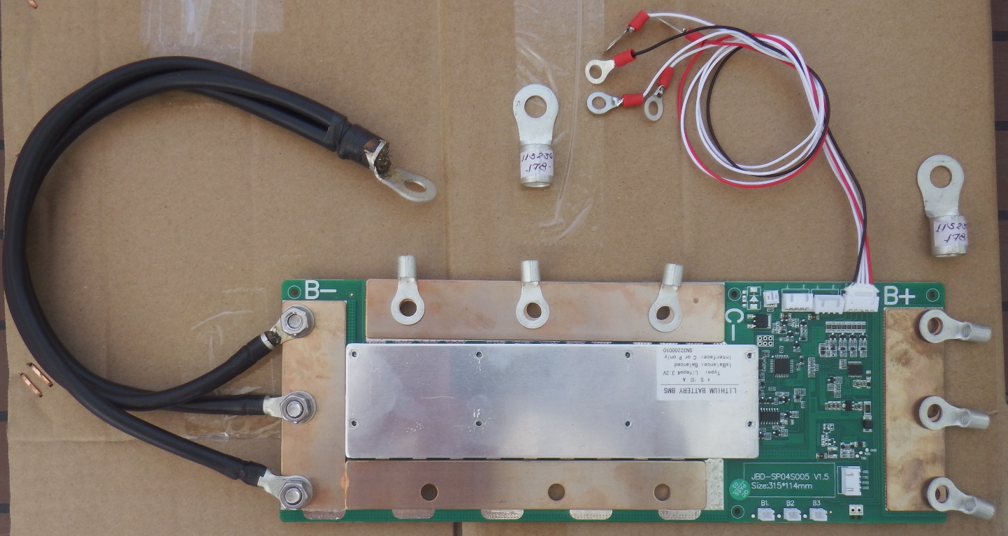

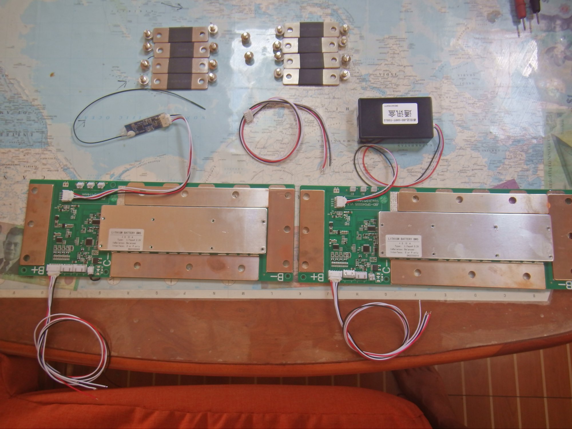

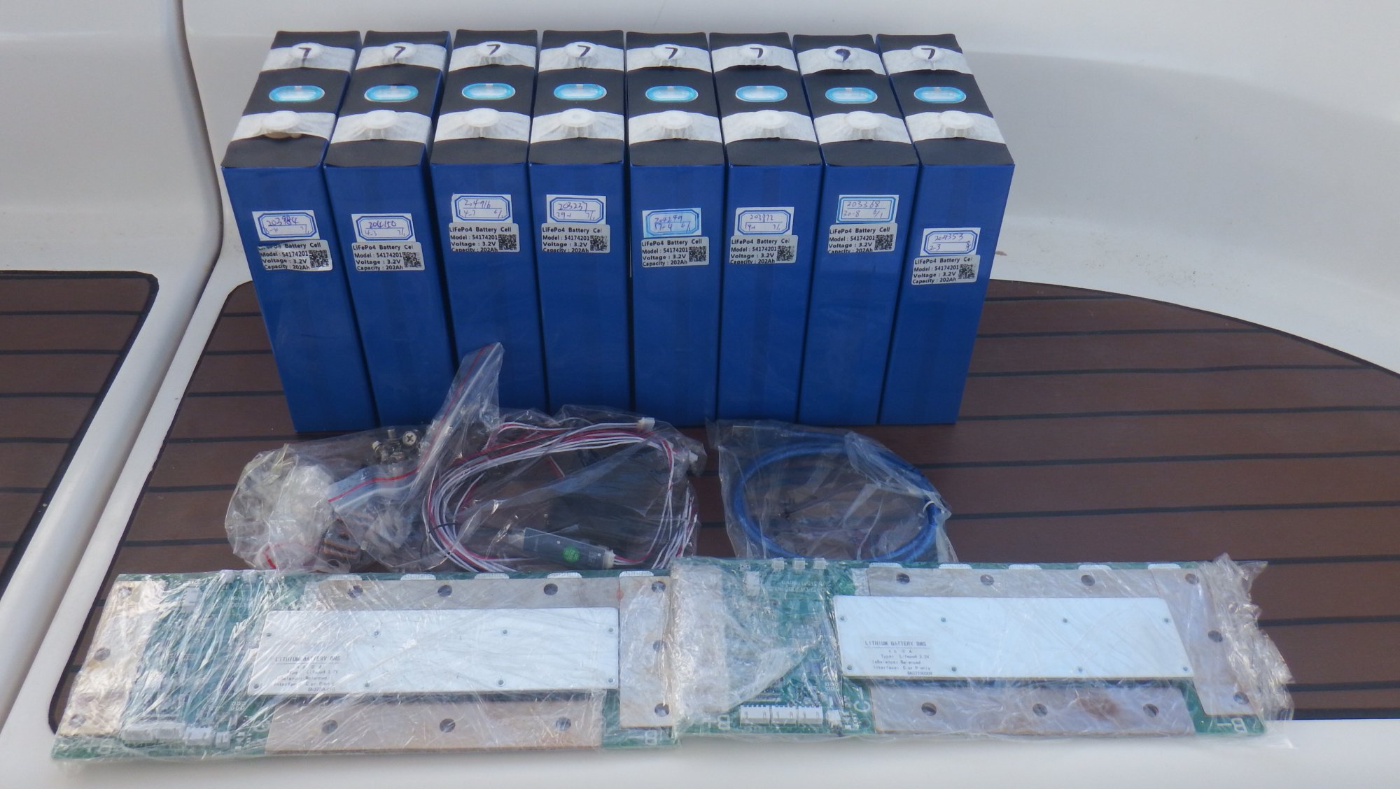

So I finally received my LifePo4 Batteries and BMS, Battery Management systems. As of this moment they are installed and running for the past 2 or 3 days. Although physical lock down is yet to occur.
Attached you will see what I received. 8 x LifePo4 batteries (total 400amphrs ), 2 BMS units, 1 Bluetooth module (should have been two) 1 USB interface ( should have been 2)
Some slight damage to the connector pins on the board, but no damage to the external packaging.

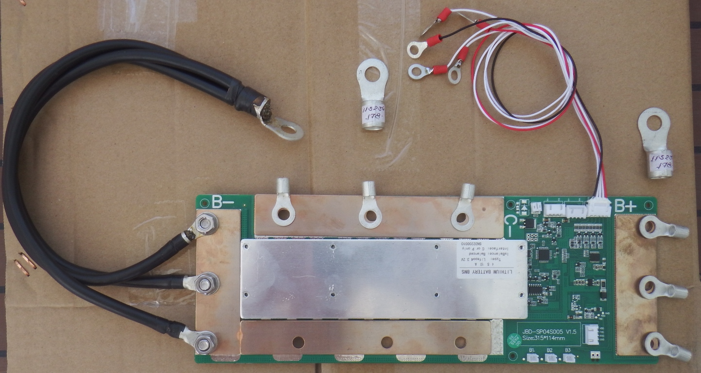

Each BMS is capable of delivering approx. 150amp continuously.( so 300amps in my case)
So the instillation is effective 2 x ( 4 lifePo4 cells @ 200amps, 1 BMS unit, 1 Bluetooth module, 1 USB Module)

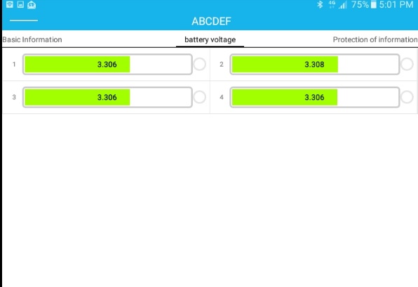

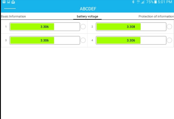

The Bluetooth or USB modules are used for monitoring a pack of batteries at a cell or pack level.
On arrival all batteries were within 0.01 volts of each other.

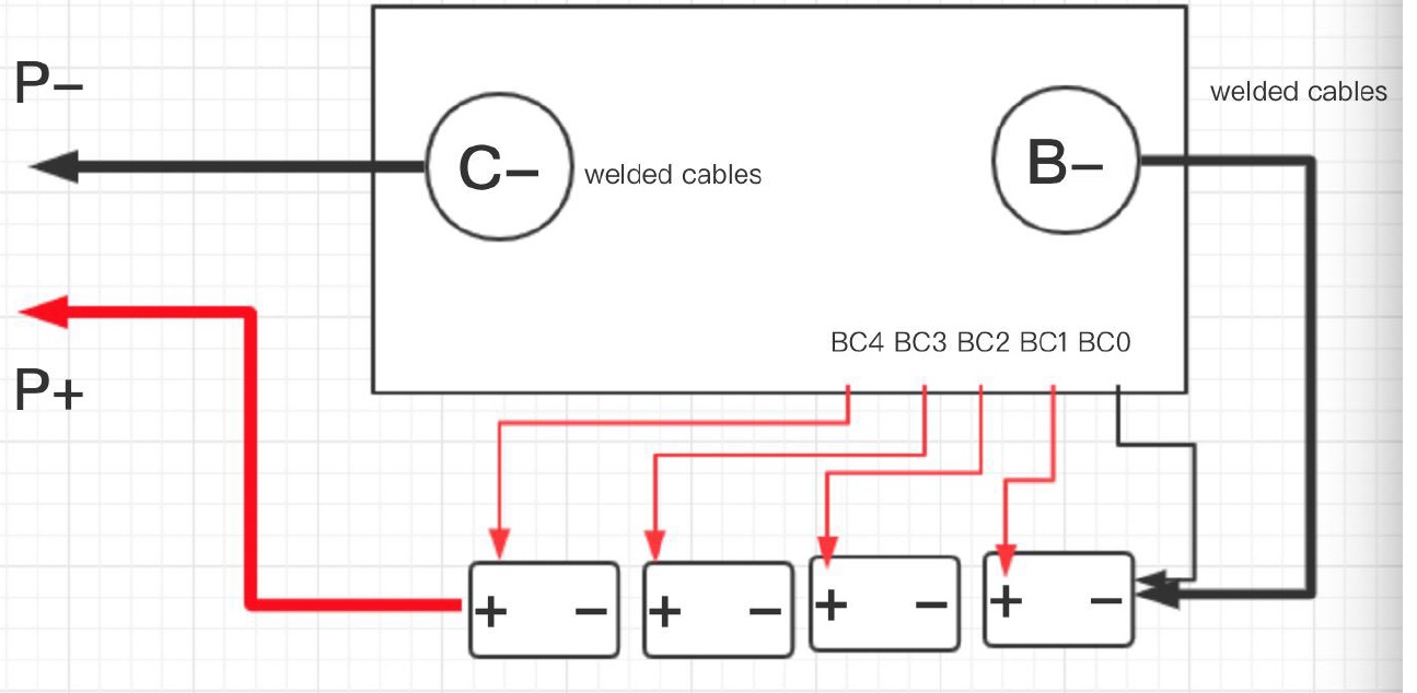

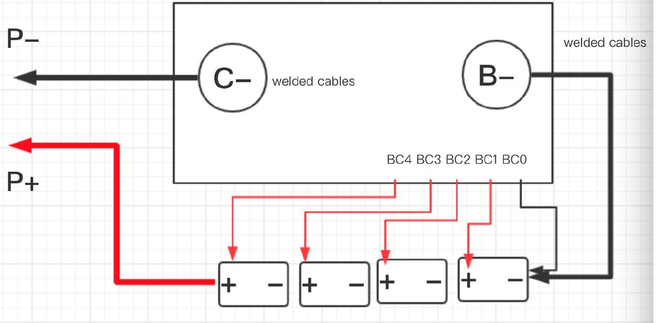

In order to pass 150amps through a circuit board it needs fairly substantial
cabling and or connection points. So in my case I used 3 x 6mm cables for each high powered connection on the module and ran those into 1 x 000guage lug that was used on the original AGM batteries. You can see this in DSCF7431 along with the small leads that go to the individual cells for monitoring each cell. So quite simple really once you have the cable and lugs etc. In my case each was crimped and soldered.
All 8 cells (400amphrs) fitted in less space than the single original AGM (220amphr) battery was, and of cause I could actual lift the 400amps of LifePo4's easily, where as I could just with much effort lift the 400amps of AGM
Having got them in place with the small monitoring cables connected, the instruction suggest to make sure the output at B- & C- are the same. In my case they were not. So effectively no output from the BMS module. After installing the BMS monitoring software on my Android Tablet it became apparent that the BMS thought the temperature was -30c and hence disconnected the BMS, so no output. This turned out to be because the temperature sensor on one BMS module has been left off in the factory. So that is on its way to me as I write. However the other module worked fine. I later discovered that within the BMS software you can control many things, one being temperature shut off etc. So on the BMS unit without temperature sensing I simply change the parameter for cut off to -50c and it fired up no problem.
As you will may know part of my intention was to try a highbred system of LifePo4 and AGM. In order to have a stable and supported installation at this point the old AGM's are disconnected. This will come latter.
So at this point they are in connected and running the boat.

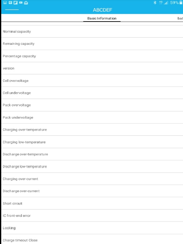

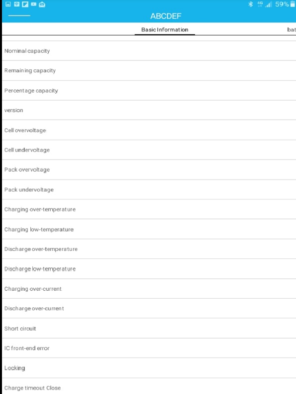

11/3/2020. Configuring my installation of LifePo4's

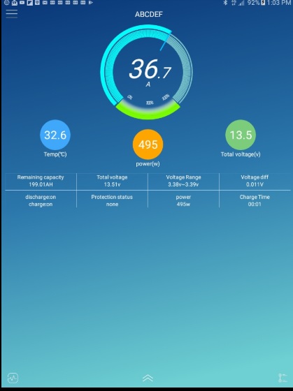

The BMS software, in my case xiaoxiang V3.1 is essential because if for what ever reason the BMS shuts down, either discharge or charge sides then at least at this moment it doesn't restart again until you switch it off and on via the BMS software. So as you may have read before elsewhere its is possible that the batteries become disconnected and hence you lose power. Just one reason for retaining some other battery, perhaps AGM/Gell for the start battery bank. So far mine has disconnected twice, once on intial install due to the temperature sensor missing, and once when I disconnected the negative lead of the batteries to re-route the cable. When I reconnected the negative lead it did not automatically come back. I suspect this is a setting in the BMS unit.
So effectively you can change all most every parameter, which is both good and dangerous, so one must be careful.
So in my case I have left the majority of BMS parameters as they came with its defaults for LifePo4.
However I have made the following changes;
I have changed temperature sensing due to a missing sensor.
I have also configured AMP hrs of the pack to 200amp
Overvoltage to 3.65, (14.6v) they should be able to sustain undamaged at least 14.8 for a relatively small period
Under voltage to 2.7 (10.8v) Both of under and overvoltage changes are I have done at cell and pack level
In essence the above changes are less stressful than the defaults it came with.

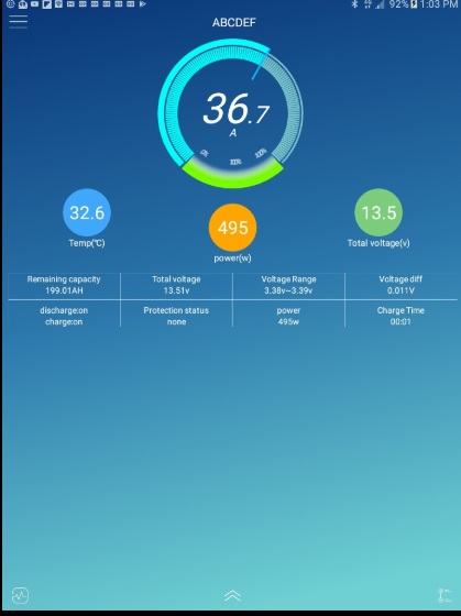

The software tracks and plots by graph all of the above, so once I have run for a weak or so, I will make more favorable changes, ie reduce overvoltage and increase under voltage. So these were my starting points.
Next was charging off of mains. I have a Link 1000 capable of around 150amp sustained charging. However at that rate even my AWG000 gets warm, so I typically contain charging to under 120 and ideally around 100amps. My link has no idea about Lithium batteries, it only knows conventional, Gell, AGM. So I have chosen Gell as its parameters are quite close to LifePo4, although not the same. With the Gell settings I can change the charge voltage so I have set this to 13.8v and again this is within LifePo4 specs.
When I turned on the mains charger my LifePo4's tried to suck up 180amps (90 each bank) even though they were far from flat, so I had to throttle back the charger, as I was not keen on pushing that out and also if I try that in a marina where power is not that great I will trip breakers, or possibly cook things. So it now puts out 100 amps and quickly drops back to 90 until almost full. In the case of my mains charger it considers full when it reaches the charge voltage and the current/amps input is less than 2 amps going into the battery. All of which is programable.
Next was the solar charger. I have approximately 1KW of solar. At the best I have noted I can produce about 80amps on top of what the boat draws at anchor. Regulation is done via 2 xantrex solar regulators. Again all 3 stage chargers but know nothing of LifePo4. On close examination and during setting these up for LifePo4 I discovered that one of the xantrex was trying to take the batteries up to well above where it should in 15volts. I now suspect this has happened probably when I was not on the boat, and it was on mains charger, and the solar took the Gell's to high causing it to fail. At least in the new system the BMS should shut this off before hand so even if the solar xantrex does this again it should not damage the LifePo4's
I discovered the above when I charged up LifePo4's on the mains charger and switch on the solar charger. Normaly both live together fine, but as I watched one charger did not stop at what should have been the top of the bulk charge. A bit of electronic cleaner sprayed on the adjustment trim pot and all was fine again. So both of these have been set to a bulk (ie top voltage) of 14.1v which should be ok AGM Gell and LifePo4.
Because these chargers do not know about LifePo4, they have float levels. In my case these are set to 13.4v, a little low perhaps for AGM or Gell depending where you read, but a good middle ground. Leaving LifePo4's on float has much debate, so in my case because we live aboard typically any float would be for a short period. If we leave the boat for some time I may need to reconsider/research float levels in regards to LifePo4.
So right now I'm on solar and monitoring all systems over the next week, both on the Bluetooth Battery Management System (BMS) and on the xantrix.
I consume 90-100amps from the time Solar stops till it starts again in the morning. So Im figuring on my 400amps of LifePo4 I probably have at least 3 days of no sun, maybe 4.

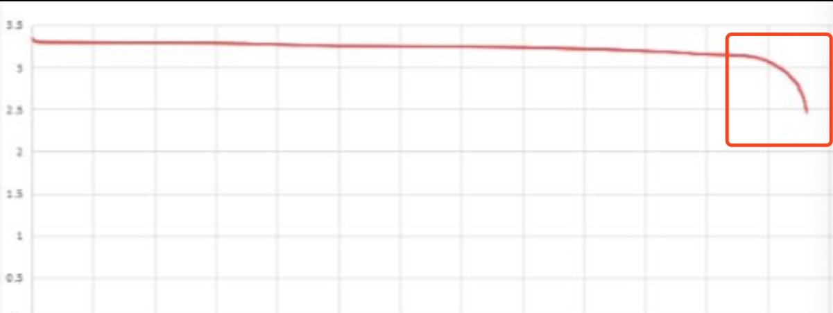

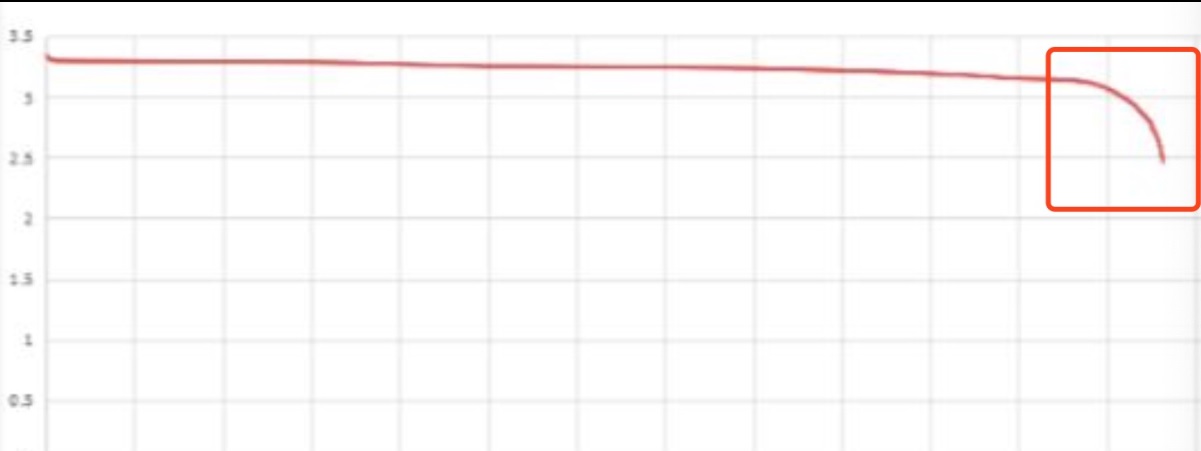

The behavior of LifePo4 under discharge is vastly different to any of the other battery types noted above. In my case I typically consume in excess of 100amp/hrs between sunset and sunrise. LifePo4 maintains roughly 90 % of its voltage, for 90% of its capacity. So with 400amp/hrs of LifePo4 which will maintain a voltage in excess 13v, very little of my 100amp consumption is supplied by my Gell.. Of the 100amps consumed over night less than 20amps came from my Gell. I assume as LifePo4 starts to run down towards 12v more and more will be supplied by the Gell.
I have yet see the behavior over different conditions or levels of consumption, but at this early stage it would seem to be a workable configuration.

I also believe we have been conditioned to the requirement of a BMS, which is effectively what takes the batteries off line. The actual real need for this is in my mind questionable at best, although it does have phycological benefit when you look at it on the screen :)
For example much of the paranoia among boaties ( and others) with Lithium is the perceived risks with this technology, and 90% of that is coming from Lithium batteries, but NOT lifePo4 a completely different chemestry. While I personally can not say I have tested there destructive or self destructive characteristics, if what the so called experts and manufactures say is true, LifePo4 can not explode, catch fire etc any more than the other batteries. Yes a short circuit can see extreme currents, also true of my Gells and other technology.
Thermal runaway I have experienced on Gell's from overcharging, it wasn't that far from burring a whole in my friends yacht. There is much tado about balancing, if you have ever run across your batteries with a heat measuring gun on your Gells/AGMs you would notice a difference in temperature, that is an out of balance cell, or the specific gravity on a led acid. So why are we panicking about this on LifePo4's
As far as Im aware I have not seen or herd of anyone having a BMS system for there Gells or AGM's other than the ability to control there 3 stage charger. So we are conditioned to think we must have this device for LifePo4's to protect them, why do we not also need it to protect our AGMs or Gells.
Im sure there will be many who will also shoot that down, but I see no bases for it, as yet, assuming LifePo4's are as safe as what is suggested. So if the safety aspect is correct why is it we need BMS and don't for the others.
Without BMS;
No need to worry or protection against the system going offline Batteries cant go off line.... as with a coventional setup.
No risk of blowing up charging devices.
No need to have an APP configured and running on some device in case the batteries do go off line.
In my case instead of 2 banks of 4 individual cells, i would build 1 bank of 8 cells by connecting 4 banks of 2 batteries in parralel, this would help with balancing.
I may consider more seriously this concept in a few months and try and find some reputable or scientific evidence to support there safety aspects or better define the risks differences and better understand what the implications are. To date I haven't really dug around for this.
Over the years I have tended to find that many protection systems are set unnecessarily high, even in very basic area's. This boat was delivered with 500amp main fuse on the 12v side. This is crazy. I replaced with 250amp, it has never blown, and probably would be fine with 150amp, but I bought two 250amps ones. My genset shutdowns both thermal and electrical were also unnecessarily high and by setting these down defiantly saved me having to have heads machined gaskets replaced, and very expensive diodes in my Xantrex charger etc.
My LifePo4's I would fuse at around 150amps. I might have to condition the wife not to hit toaster and Microwave at the same time though.
So if I was to seriously consider the non BMS road I would among other things monitor and track my actual loads and fuse accordingly as I did years ago. Given I have 2 x BMS units, I would take an interim step and leave the BMS units there to monitor but bypass them. For sure if one of these BMS units dies I will do exactly the above and by-pass BMS and have considered adding a 250amp switch just in case that happens.
I would make sure I at least had visibility of the house bank voltage and current (which I do by default without BMS), and add thermocouple so I new the temperatures was not running away, although even as I type that, I ask my self why I didn't do that with AGM/Gell. All of cause assuming I find no firm reason why I should treat LifePo4 as something that needs kit gloves or it will go bang any more than 800amps of Gell or AGM for example. If such proof exists BMS is a must I think.

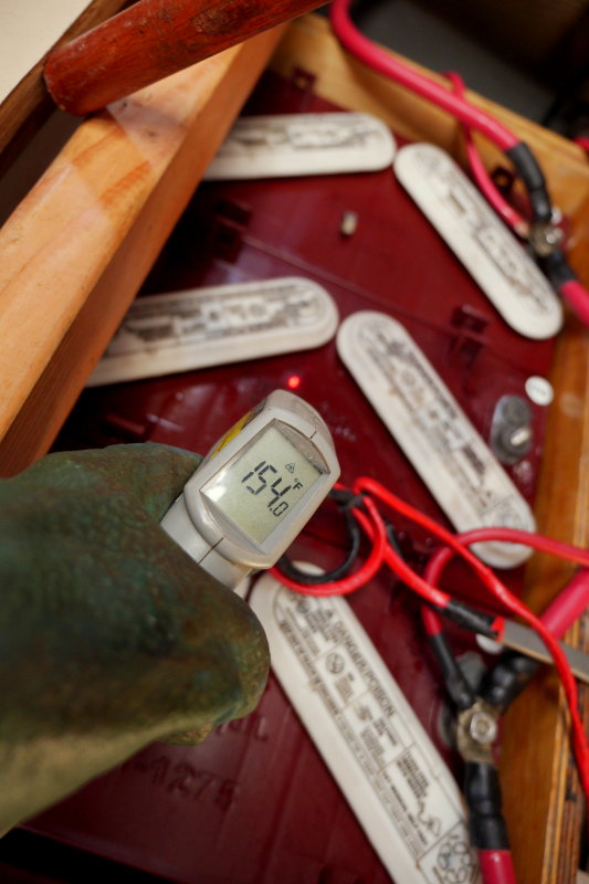

The problem with permanently paralleled LFP and LA is one of a shorted cell in the LA bank. We've seen this happen, with LA batteries, as has the OP, and even with LA batteries in parallel it can lead to thermal runaway. If we now connect them to a Li-Ion battery with an even higher voltage, and one that does not plummet even under high load, the current flow between the Li-Ion batteries and lead acid failed battery is increased.
This was after the shorted battery had been electrically isolated and cooled down a bit:
With LFP having a higher working voltage than LA, the risk of an LFP battery dumping it's energy into a failed/shorted LA battery can be dangerous. The ABYC may even disallow paralleling of LA and Li-Ion but the committee work is not yet done so nothing is set in stone.
