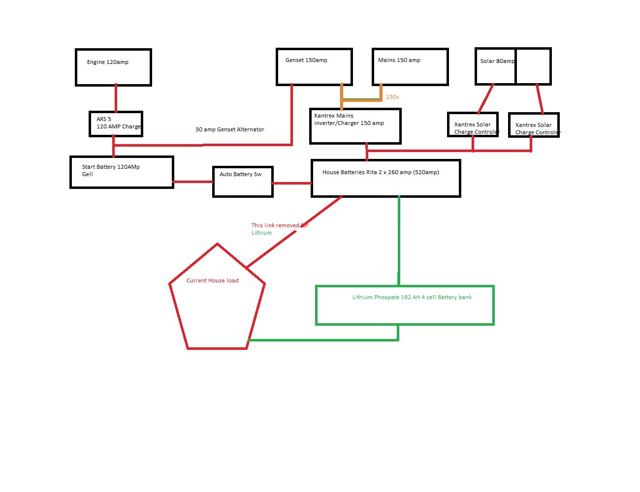

Ok, I know Im out on a limb here with the general consensus.
What I’m looking for here is a technical explanation as to why not, or how to, run a mix of AGM/Gell and Lithium
The attached shows my current setup, and my thinking of how I will integrate lithium.
So firstly some information:
My existing Gells have a max charge .equalization of 14.4 to 14.6
The Lithium’s Im looking at are LifePo4 192ah Max charge voltage 14.6 (3.65 x4) So same
My Max charge amp can not exceed its 120amps, so also within spec
I have 2 x Rita 260amp Gells ( had 3 one swelled prompting this)
Let us assume a staring point where Gells and Lithium are in parallel and fully charged So 14.6 to 14.8v on house
This is within Gell and Lithium spec. for say equilzation
Charger is removed and load applied say 10 amp for the sake of discussion.(in my case reality is around 14amps)
The whole bank will drop quickly to 13 and then to 12.8 and its likely that the Gells will carry most of that load initially.
Perhaps even a little will trickle from Gell to Lithium. ( so some loss as Gells try to put a bit into Lithium, at a guess well under 0.5amps for a few minutes)
As the load continues, Gells will drop to around 12.8 and Lithium will start to pick up more load.
Eventually because lithium tends to hold its position (approx. 12.8), Gells will do less as the voltage is dragged down and Lithium will do more.
At this point lithium will start to pickup more of the load and gells will see a voltage that is being maintained by Lithium that does not cause a drag on the Gells, because its being held up by Lithium.. So yes now some trickle from Lithium to Gell will occur.
If one continues with the load, eventually the lithium will begin to collapse and shut of as it approaches fully discharged.
Given we are not supposed to take Lithium below 70 or 80% to keep a good life cycle we should have stopped the discharge before fully discharging lithium, which would be well before we risk damaging the Gells.
If we now apply a 120AMP 3 stage charger and don’t breach the peak charge values (volts or current) they will suck up whatever they need..
Presumably the Gells being not fully discharged would suck up little and reach peak voltage before the Lithium. But in any event the set that has not reached 14.6 for example will beholding down the voltage sucking up the current.
When the bank as whole reach fully charged, the charger would return to float .
So given the Lithium would have a BMS (Battery Management system of its own to protect it, and accepting there is some disparity between the two types of batteries, I don’t see a major issue or major losses.
Given so many people have pondered lithium and I’m sure I’m not the only one to think like this, someone please give me a good technical answer as to why I’m wrong. Better still if anyone has tried this. ? Cause I think I will try it.
My fall back if I completely stuff this up is to put a DC to DC charger between Gell bank and lithium bank and move the load to Lithium
All input welcome

Feb 15, 2008
232
Hunter 49 Sydney
The response below are not for a minute suggesting I’m right, they are my thinking out loud and answers to some of the comments, in the hope that someone with better technical knowledge than I will agree or shoot it down technically.
Yes it is hammered into us for sure that one shouldn’t mix battery types., but many (not all) of these things are manufactures design spes in there closed world. I run 4 different charging systems, this was said to be a no no as well, due to equalization /float and while a completely different subject, I carry one !!! oil. This oil goes everywhere, Main engine (turbo), genset(std Diesel) outboard which is 2stroke again said to be no.. All have been fine for over 10 years now. If there is a good technical reason (which is what Im seeking) then yep I will do as I’m told, ie Yanmar oil filters, anyone not using the original yanmar oil filter would be just about the same as leaving it out completely, and there are sound technical reasons for this not just Yanmar trying to suck us dry. Your local shop where you buy your third party oil filter won’t have a clue, and will tell you it’s compatible and your Yanmar dealer wont be able to tell you why or what the difference is.
LifePo4 now days with BMS seems to be heading towards drop in replacement for most situation, even to the extent that as stated above don’t charge them to 100% which of course a car or standard alternator cant do, and many of the BMS systems are trying to make it idiot proof.
In regards to cable sizes over heating disparate discharges. All cables sizes are large (0 or 00)already in order to carry 150amp DC adequately, Uneven discharge at some level is a given, but unless it gets substantially out from some catastrophic failure this happens within any battery internally and again with in any bank of batteries. and as within conventional battery banks any dead or lazy cell or battery will have a knock on effect.
Charging for LifePo4 has only minor differences between say Gell or AGM and that difference is around threshold levels. All battery types should have charge current monitored and my system cannot exceed any of these specs especially Lithium. . All should have voltage monitored and the top end voltage recommended for LifePo4 seems to be around 14.4v ( 4x 3.6v cells) but there are suggestions that damage will not occur till around 16.2v. and also that you should not fully charge Lithium to 100% So the voltage range is quite wide.. In terms of float voltage unless your vessels sits on a marina for much of its life, which in my case its not liable to get the opportunity to sit a float voltages for long LifePo4 doesn't care. One cloud, another beer from the fridge, the ice maker or any of the systems will soon nock the float voltage off.
Yes my technical knowledge is lacking there is little doubt and as suggested and this is why Im asking. Differences in technology or internals are not that relevant so long as one follows the rules or meets the requirements of the batteries in question.. My swollen Gel is only 1 of 5 I have ,that are now 4 years old. Perhaps I am naïve but I do not put this down to my configuration. I put it down to a Gell failure. The others are running around 70% efficient which given their use and age is probably fair ware and tare.
It was suggested I was not going to be able to equalize in my proposed config. I would be interested to know why not. LifePo4 wont care. AGM is the highest at around 15.5 to 16v and in theory Lithium wouldn’t care until it exceeds 16.2, plus the BMS should shut off Lithium before it gets that high, Gels Equalization is much lower around 14.4 and in my case the manufacture says 14.6, so I think should be able to equalize.
SG/Steve; I appreciate your feedback and input. A quick look at the Relion website would suggest that in your case the ontop electronics which I assume is the BMS is packaged into the battery case. At this point I am looking at basically starting with 4 separate cells to make up the 12v (200amp) and a BMS system as all individual items. Essentially so 1 cell failure, or a BMS failure does not cause me to toss out the lot and the price is of course considerably cheaper, which may or may not be smart. Because Im looking at integrating these with Gells (if possible) as a bit of a test even if the BMS disconnects the Lithium, my Balmar alternator will still see a Gell load and hence not damage the diodes. I think I have only once run Main and Genset together. While I have the capacity to probably supply 350-400amps if I add all the charging systems together only in the event of Multiple Catastrophic failures resulting in a low resistance, hence very high current draw can I see any cause for concern.
Yes I believe in your case the joining of both banks could be a problem. Mainly because they did not start together, and or there could be a significant difference in the banks states, resulting in a lot power/current going one way or the other. However if the joining was planned, when batteries were floating at very near the same point. I do not envisage you would have a problem if you joined them.. I have done this between AGM and Gell, but not Lithium.

Weight:: For a mono its irrelevant in fact probably Im better off with the weight, given they are below water line.
Steady Voltage: The fact that LifePo4 should maintain 13.2 approximately for most of its discharge is both beneficial and important to me, as this is what my AGM in parallel will see. While not ideal for AGM (to low) my priority is to Lithium. I do not expect the lower 13.2 volt will be a problem for AGM. So in my system Lithium will be programed to disconnect before the Knee and AGM will take over. Of course the proof is in the pudding as this is pretty much uncharted ground.
Using GEL Charging profile on LifePo4. The example quoted in the article holding Gels up at 14.2v for 4 hours and thus risk damaging his LifePo4 using that profile I do understand. I would have thought any half responsible multistage charger would not do this. Mine is xantrex, not top of the line, but in simple terms as stated LifePo4 hitting this voltage is not detrimental, unless its sustained and the battery is already full, in which case it could be argued its verging on float voltage . In my case 3 factors are examined in deciding whether to hold the absorption cycle.. Have I put back the AMPhrs I took out, if I haven’t it can not be full. Is it still soaking up more than 2,5,or 10 amps, has the current been (+ or -_) stable for 30,sec, 1min, 2min. My charger will not reset absorption phase unless 20% of the amphs have been consumed. So the event described would not happen in my case, unless I screw up the programing.
Floating LifePo4’s: Yes I agree with the article and in fact have two friends that have lost 4 cells from floating quality LifePo4 cells at traditional levels. In my case as a continuous cruiser hardly ever on shore power, floating is not something that is typically maintained for long periods, plus there seems no clear answer to this question..
I think his maijor points should be the objective. Get it balanced, don’t run it at 100%, monitor individual cells and keep them in spec, don’t run traditional floats, don’t run absorption based on time.
Thinwater: I have no intention to go to freezing waters, so I do not need heaters to charge my Lithium. Im a tropical cruiser… well Japan perhaps is not but, we will see.
