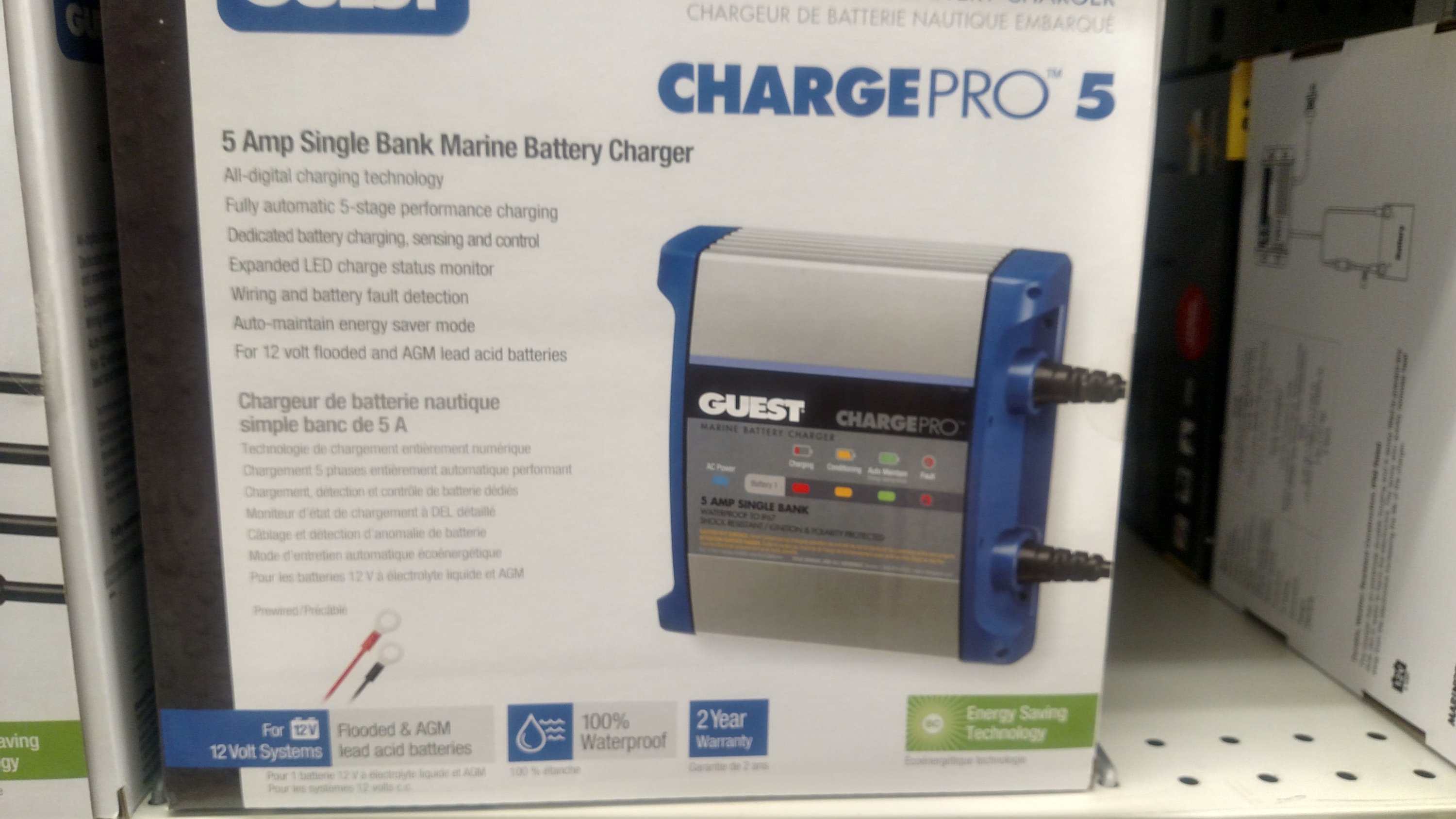

@DAVA390 Only you can be the judge of what you want on your boat. The link I provided is from a professional Marine Electrical Engineer.
The above unit is a 5AMP unit. This is what was said a the beginning of the article.
"The general consensus, & industry recommendation, is to size a hard wired charger for a minimum of 10% of the banks rated Ah capacity. A 400Ah battery bank, sized at 10%, would get a 40A charger. Sizing at 10% of Ah capacity of course assumes you have the time needed to charge at 10% of Ah capacity and no other loads while charging.The general consensus, & industry recommendation, is to size a hard wired charger for a minimum of 10% of the banks rated Ah capacity. A 400Ah battery bank, sized at 10%, would get a 40A charger. Sizing at 10% of Ah capacity of course assumes you have the time needed to charge at 10% of Ah capacity and no other loads while charging.The general consensus, & industry recommendation, is to size a hard wired charger for a minimum of 10% of the banks rated Ah capacity. A 400Ah battery bank, sized at 10%, would get a 40A charger. Sizing at 10% of Ah capacity of course assumes you have the time needed to charge at 10% of Ah capacity and no other loads while charging."​
Following the "Industry Recommendation" a 5 amp charger would serve a 50 amp battery. Is that what you are planning on your boat?

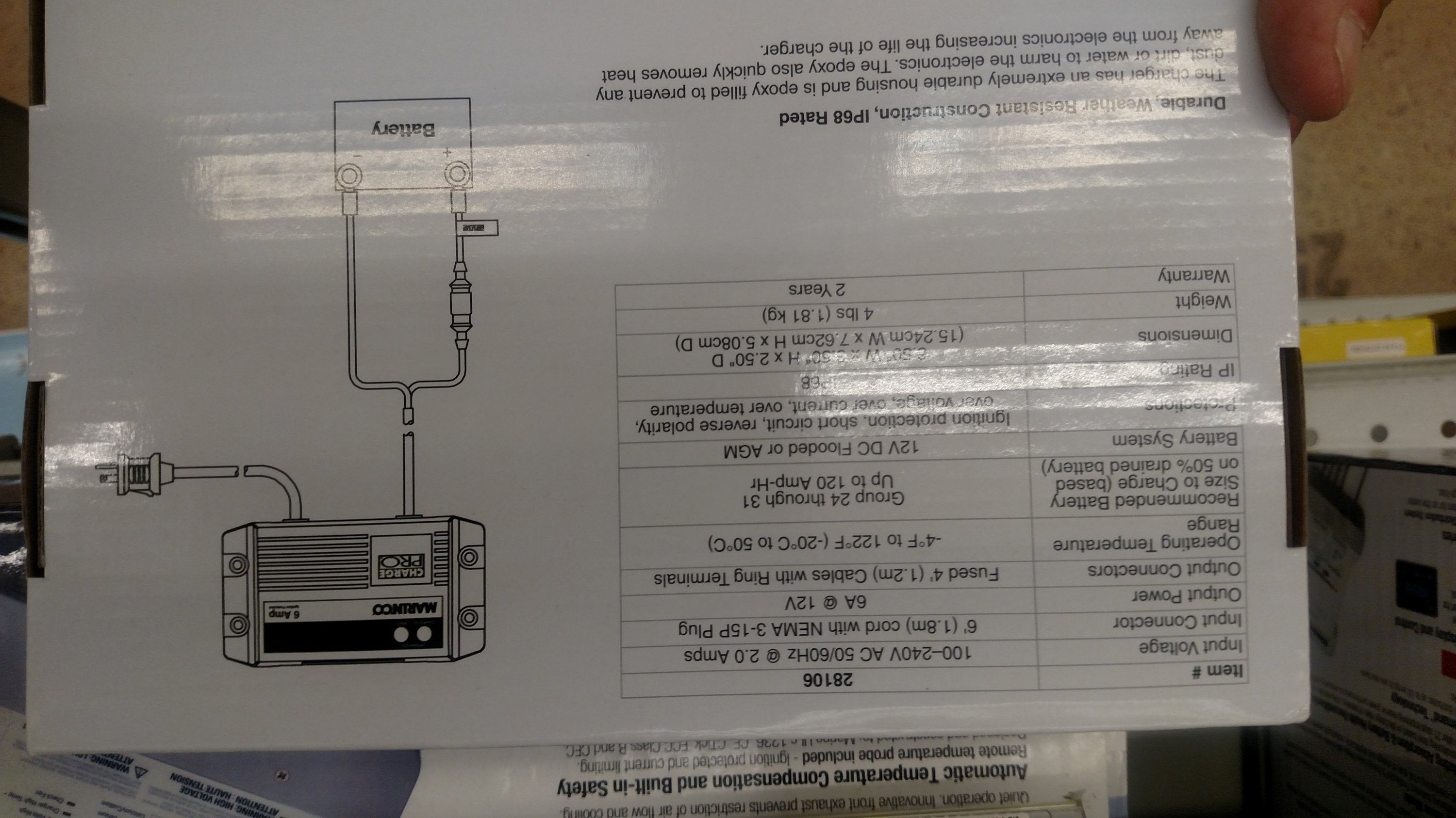

The ProMariner ProSport 6A is a better charger in that range but still not my favorite. I am not a huge fan of the Marinco chargers.
For $170.00 you can buy the excellent ProCharge Ultra 10A. These represent a very good value for this grade of charger.
By a long shot the new Victron Blue Smart IP65 chargers are the best in that class (waterproof)..
https://www.victronenergy.com/chargers/blue-smart-ip65-charger
That said i am not a huge fan of most "waterproof chargers". They don't tend to last as long because they run at higher internal temps than do dry-mount chargers. If you need a portable waterproof charger though the Victron is really tough to beat.
