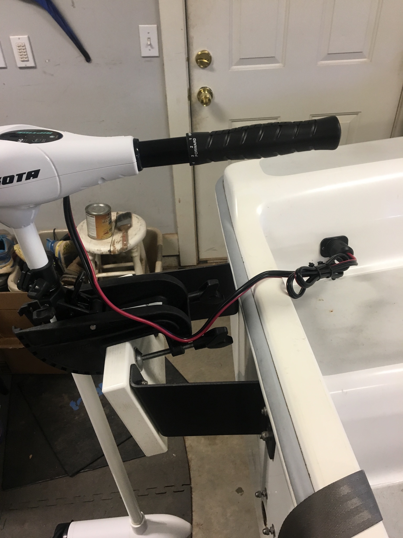

El Jeffe, can you describe how you connected battery, the wiring, the motor mount and type of mount and how you intalled it? Pictures would be great. I just ordered a Minn Kota 55# thrust 36" shaft after an outing where winds increased to 15-25 mph gusts, shallow narrow cut making it difficult to tack. Had to do the shameful walk.... so, the idea of the motor came about. I had initially planned on installing oars, but my husband liked the motor idea better.

Can you please describe your motor installation details? I placed my Minn Kota #55 trust motor on the transom, no bracket yet, but it kept the rudder from turning freely and they both kept bumping/obstructing each other. Any measurements and or additional pictures are greatly appreciated. Thank you.

I can only imagine as I use to install batteries on the 16.5 as a dealer for Catalina. Please post photos of the outside to show placement of the battery. Good location of the inlet vs. transom which can get wet back therer.
