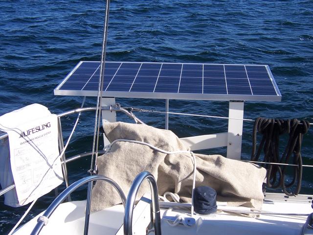

What the Admiral might go for is a good solar panel charging setup. It is totally quiet, does not stink, no explosive and smelly gasoline to carry, will not be affected by future high gasoline prices, will not rust like the generator, no oil changing required, no trips to the fuel dock required, will not carbon up the ships engine with hours of idling, etc.
