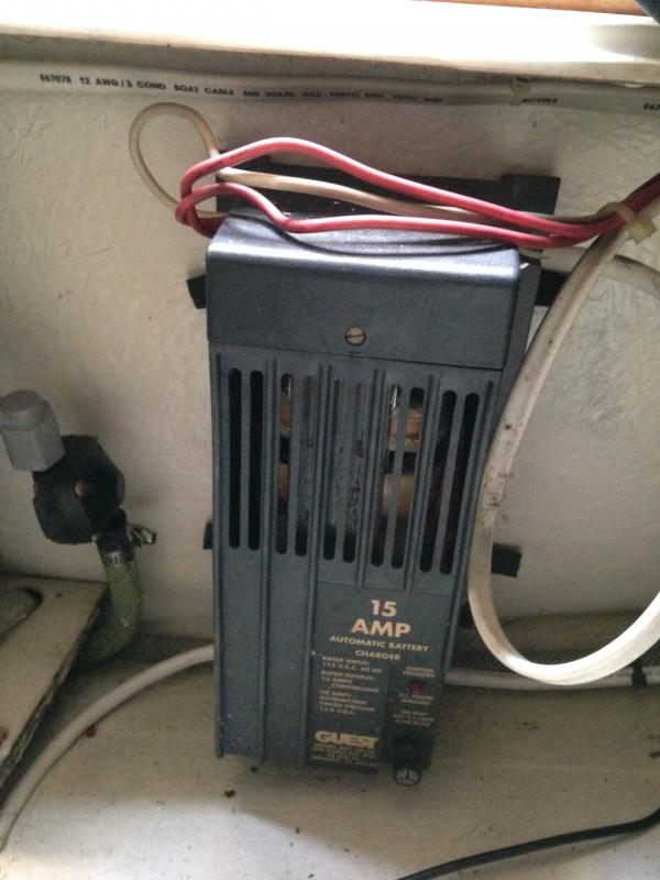

My sailboat, Catalina 30 MKIII 1994.
Had a fire, a total loss. because the battery charger, that have heated when connect to the shore power. One chance is I don't slept into on that night, if I was pass a night into the boat for sleeping, I would have died
So don't hesitate to call an electric expert
I try to found a replacement for my sailboat. I'm living in Montréal, QC.
This Guest Charger
Gave me this fire
