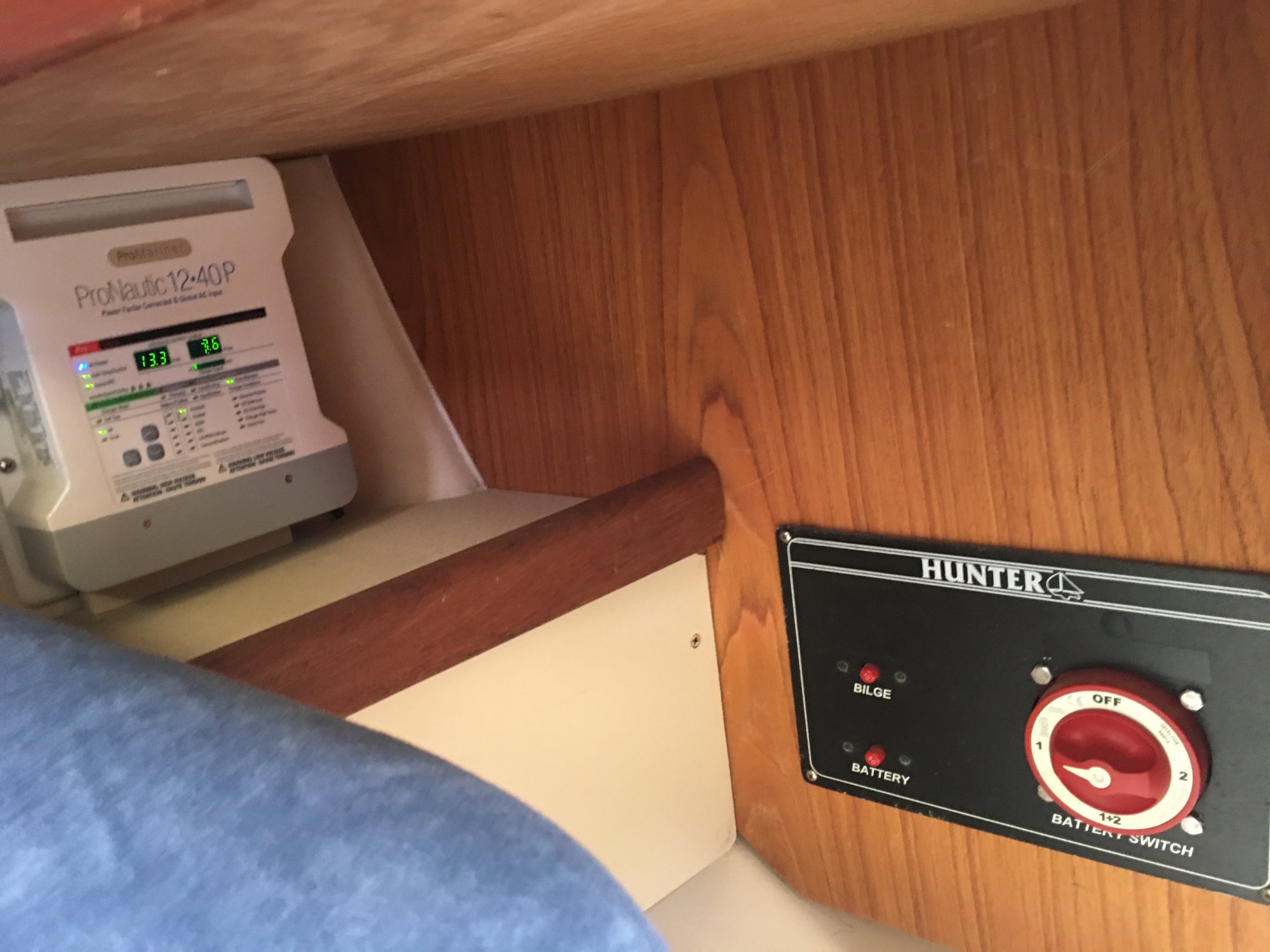

More info, boat is docked at a marina with shore power. Batteries on constant charge when not sailing, by a “smart” charger.

Before jumping into the big bucks with Fireflys, read the manual. It can be downloaded at Ocean Planet Energy. Your charger may be a tad small for 2 batteries.
