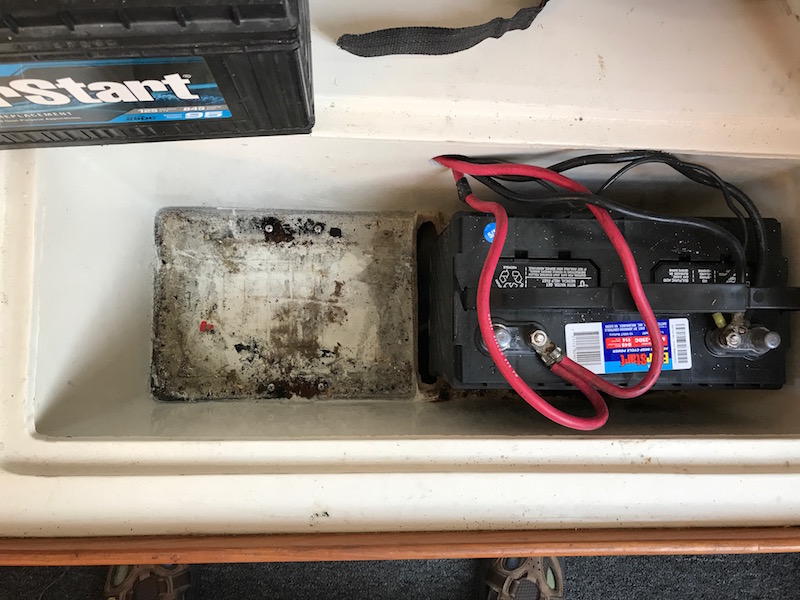

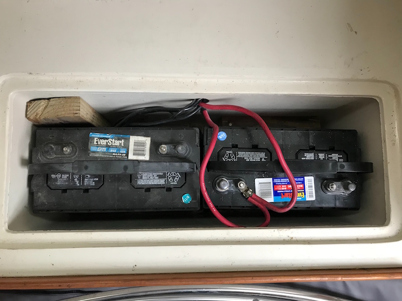

On my 93 C30, the battery compartment is under the starboard settee. It appears to have been built with a divider of some sort and to hold two Grp 27 batteries.
A PO cut out the divider, leaving a hole in the bottom of the compartment, to fit in two Grp 31 batteries.
If I was to repair/seal the hole in the bottom of the compartment and provide proper tie downs, will the compartment be considered as acid containment so battery trays/boxes will not be required?
If yes, then I can stay with Grp 31s. If no, there isn't enough room for Grp 31 trays or boxes so I will have to go down a size to Grp 27s.
The first pic shows the compartment and the hole in the bottom to the left of the installed battery. The second pic shows the tight fit of both batteries.

Why not? Just fix the hole with epoxy and glass (clean, grind, laminate). If you can't get under it to install a backing to hold the wet glass, pre-laminate the bit for over the gap.

Do you have a problem with battery acid spillage? If not just cover the slot put down a liner and keep the 2 group 31s. I don't see any damage from the install the PO had. Bad batteries can swell up and casings can crack but if you give them proper maintenance and inspect them frequently you should be OK as that compartment seems like it can hold a spill. If your sailing needs do not require the added battery capacity then go back to Gr 27s and install boxes.
14,166
:yikes::yikes: Project Creep Alert!!!! :yikes::yikes:
As Thinwater said, clean the bottom and then lay up some fiberglass to seal the hole. A simple lid could be made by installing 2 wooden cleats above the batteries and then covering with plywood or fiberglass board from a big box store. The purpose of the lid would to be to cover the battery terminals to protect them from some one tossing something in the locker without looking first.
While you're messing around in the battery compartment, might a good time to add battery terminal fuses, secure the battery cables properly, and put some chafe protection around the hole with the cables enter. Those lugs on the battery cable also look a little suspect. Can't really tell from the photos. The cable also look a little on the small side, but can't really tell. Oh heck, just rewire the whole boat. ;)

I just bought the boat and the survey noted the hole in the compartment and said the batteries need to be in boxes or trays to contain any spilled acid. Boxes for Grp 31s won't fit so I was wondering if I sealed the hole would that solve the acid containment problem.
My other options are to go to one Grp 31 with a box or downsize to two Grp 27s with boxes. (1 of the 31s was new in 2017, one is dead)
I also have a Grp 27 as an auxiliary battery so going with the one 31 in a box will probably get me started.
I mostly day sail but hope to spend some time out on the hook with this boat so I don't currently have a good idea on my power requirements. I did start a spreadsheet to figure my theoretical power requirements.
One of my many projects is to diagram my battery/charging /engine circuits and plan an upgrade with correct size wiring, new smart charger, ACR, MRBF fuses at battery banks, Alt charging to house bank, etc.
So, sealing the compartment floor is an option.

The cockpit locker does occasionally get some water in it. I think a standard manufactured, plastic battery boxes is good idea.
Where does the hole current drain down to?
I'd suggest you consider gel cells vs. normal lead acid. Although they are are more expensive, but I think are really a pretty good idea. You could essentially just secure and protect them in that compartment (protect the terminals). I don't know what type of shore power charger you have or voltage regulator on the engine charging system? Assuming that you have a modestly sophisticated set of charging control devices, the gel cels are pretty bullet proof. They don't spill, you don't have to check the fluids all the time, etc., etc.

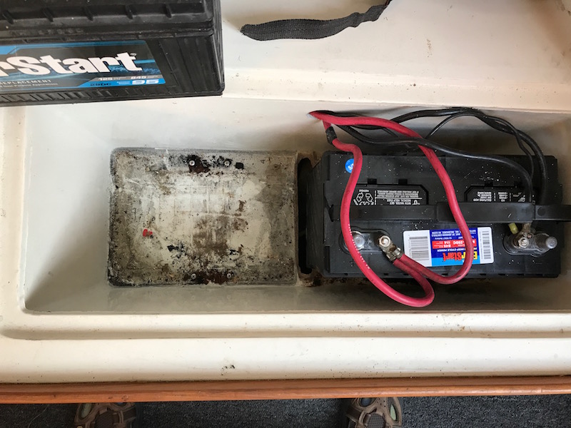

Yes fix the hole then your fiberglass box would count as acid containment if it also has a lid and vent.. Keep in mind that anything that is acid edible, screws etc., will make the compartment not acid containment compliant because the acid would eat the hold down screw then the acid would drain down and munch your keel bolts etc...

If you are using flooded batteries, you should have an acid containment system, a battery box, or the existing tray that you have, properly sealed. You should also have good hold-downs, and I have found the nylon strap type, that you appear to have had, to be wanting.
You also should have air space between the batteries, for proper cooling.
There isn't really a big difference in capacity going between Grp 27 and 31. The 31's are longer, 13" v. 12 1/16 for the 27's.
I would seal up the hole and go with Grp 27 size deep discharge batteries.

I'd patch and go back to group 27 with new battery boxes with the built in battery meters.

Two Gp 31 batteries would be a nice bank for the house. Glass the box bottom to contain liquid acid but understand that flooded acid batteries produce acid vapor during recharges that can migrate and corrode elsewhere. Not sure what is nearby but keep that in mind.
