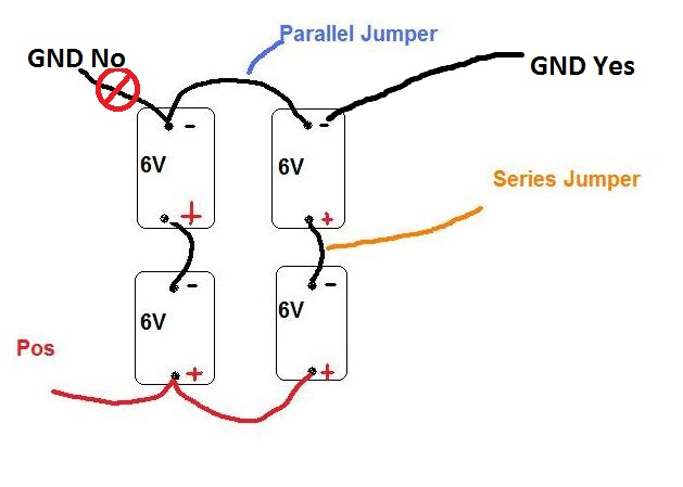

Jesse, are you counting amp hrs of all 4 ea. 6 volt batteries for the total? If so, you can't do that if 2 ea. comprise a 12 volt battery series leg. 460 total would be 230 amp hrs per 6 volt battery. Chief

the 460 sounds about right, for 4 GC batteries wired as a 12v bank. My GC2s are rated at I think, 225 per battery, so two of them in series is a 12v, 225 bank, so doubling that would put about 450 in my case. I know there are some out there a little stronger, so that 460 would be accurate depending on the battery.

CharlzO: No problem then, I was just trying to clarify as I know many of us are aware that some total all the amp hrs for a real grand total! Thanks, Chief
Each 6 volt is rated at 230 amp hrs. I have them set up so that there are two series in parallel. So two 6 volts rated at 230 amp hrs connected in series to make one 12 volt rated at 230 amp hours paralled to an identical series for a 12 volt bank at 460 amp hours. Similar to the attached diagram.
