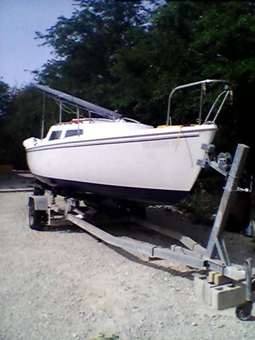

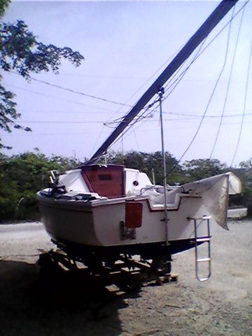

Ok so i have been out of sailing for +10 years and i was looking to get back into it with a little Catalina 22.
so I happen to find a catalina 22 MKi i suspect still waiting on the Hull number from the owner and for the most part the hull and keel look to be in good condition, i checked for delamination and rot but nothing stood out other then maybe needing a new coat of paint. The interior and cockpit looks good but are missing cushions.
Everything looked find until i noticed the mast... the owner was working on a-frame to help lift the mast. i don't know what happen to the original mast but the owner now has replaced everything with a hobie 18 mast step, mast, shroud, boom, rigging lines etc.
my initial concern was can this rigging work? we are suppose to take the boat out for a sail this weekend so i guess that will answer that BUT WHAT are my options when it comes to sails....
i was thinking i might be underpowered with the hobie mast and be limited to only hobie sails?
The current sails 'look' okish like i said this weekend we will fly them and see what is what but am a little hesitance because it seems really out of place?

The hobie mast and boom is a an "upggade" that some people fit to monohull boats up to about 25ft... for 3 different reasons..
1.... when there is a failure of the original rigging plan, and the exact replacment isnt available, and if a hobie rig is, it doesnt take much to fit it to the boat...
2... more sail area..
3.... most of the hobie 18's had rotating masts, which then becomes part of the airfoil, rather than just a cumbersome stick holding the boom and halyards...
Other boats have actually adopted the rotating mast and offer it as an option with their new boats...
I wouldnt discount the boat because it has been refitted, because in some respects it is an upgrade. but absolutely do inspect the quality of the workmanship of the refit..
A good craftsman may make many changes that have little use or value other than to show off his good work in his nice boat, but a poor craftsman trying to make the best upgrade can ruin a boat very quickly beyond any dependable or safe use...
And Hobie sails are just as available as c22 sails are.. or sails for any other boat.

Arbitrarily screwing around with the sail plan is probably not such a great idea. The designer drew the boat to balance with a certain sail configuration and changing it willy nilly is going to be a crap shoot. One may get lucky and it will sail OK, but I wouldn't count on it. From what I know of the C22, they are well balanced boats. Personally, I'd leave well enough alone.
Of course, mention was made of the difficulty of finding a C22 in this particular location, so the pickings may be slim. But all things being equal, I'd pass on this one.

The Catalina 22 gets its power from the headsail, the mainsail adds about 10 percent and is for balance, so with an extra large main and a very small headsail you mess up the balance as well as not having much power.
The Hobie rigging was built for a 400 to 500 boat with little water surface in the hulls, on a boat up to 5 times heavier and 10 times more hull resistance I cannot see how it could possibly work without failure very soon.

Has he repositioned the side stays? The chainplates on a hobie are farther aft. C22's use a backstay because the chainplates are farther forward, hobie's do not.

I can't see why the hobie mast would radically change the mainsail vs headsail proportion, as long as the mast was in the same position as the original mast.
I can't see him moving chainplates/stays etc.
As long as the mast step wasn't moved, you would be increasing the area of BOTH triangles proportionally.
Also... since masts are just extrusions, he may have cut the hobie mast down in height to match the original C22 mast height.
Assuming the hobie mast is it's original taller height, my concerns would be:
- strength. The mast itself it probably a stronger extrusion, but the angles of the stays are different with the C22 hull.
-possibly overpowering the C22 in stronger winds, and more weight aloft.
-quality of the "upgrade" (did he get sails custom made ?, stay attachment etc etc)
As for sails... any competent sail loft can make custom sails for any boat if you give them measurements.
Personally, I'd take it out sailing and see.
Done well, it could be an upgrade
As allen-deckard says.. it's just a aluminum stick.. It's all other factors that make it work well or not.
