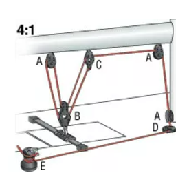

Barton Marine removable traveler

I have a 4:1 mid boom set-up... i thought i needed a winch?

Ok… I thought you had end of boom mainsheet.
Yes a winch on the cabin top will help you with forces involved with mid boom sheeting. They are double what happens on the sheet at the end of the boom.
Because of the increase loads on mid-boom sheeting a winch is necessary in higher winds when going to windward, unless of course you spend your off time in the gym pushing iron. With end boom sheeting and enough purchase and a 2 speed block system, a winch is not necessary in most conditions. Although having been a main sheet trimmer on a J35, there were days a winch would have been helpful.

Right on Ya'll... I think the play is to run the traveller lines back (in case of de-power situations) and leave the main set up alone

I have mid-boom sheeting and a traveller. I use the traveller 10:1 over the mainsheet. And in gusty conditions, the first thing I reach for is the traveller line…mine are long enough that I can lay them on the port and STB cockpit seats or coaming and let it out very easily and quickly If I am over powered.
Yes, I have a cabin top winch for my mainsheet and I need it any significant wind. But I don’t adjust it all that often, unless I am heaving to, or moving from down wind to upwind sailing. Even then I start with the traveller and see if that gets the trim where I can live with it…admittedly, I am a lazy sailor.
