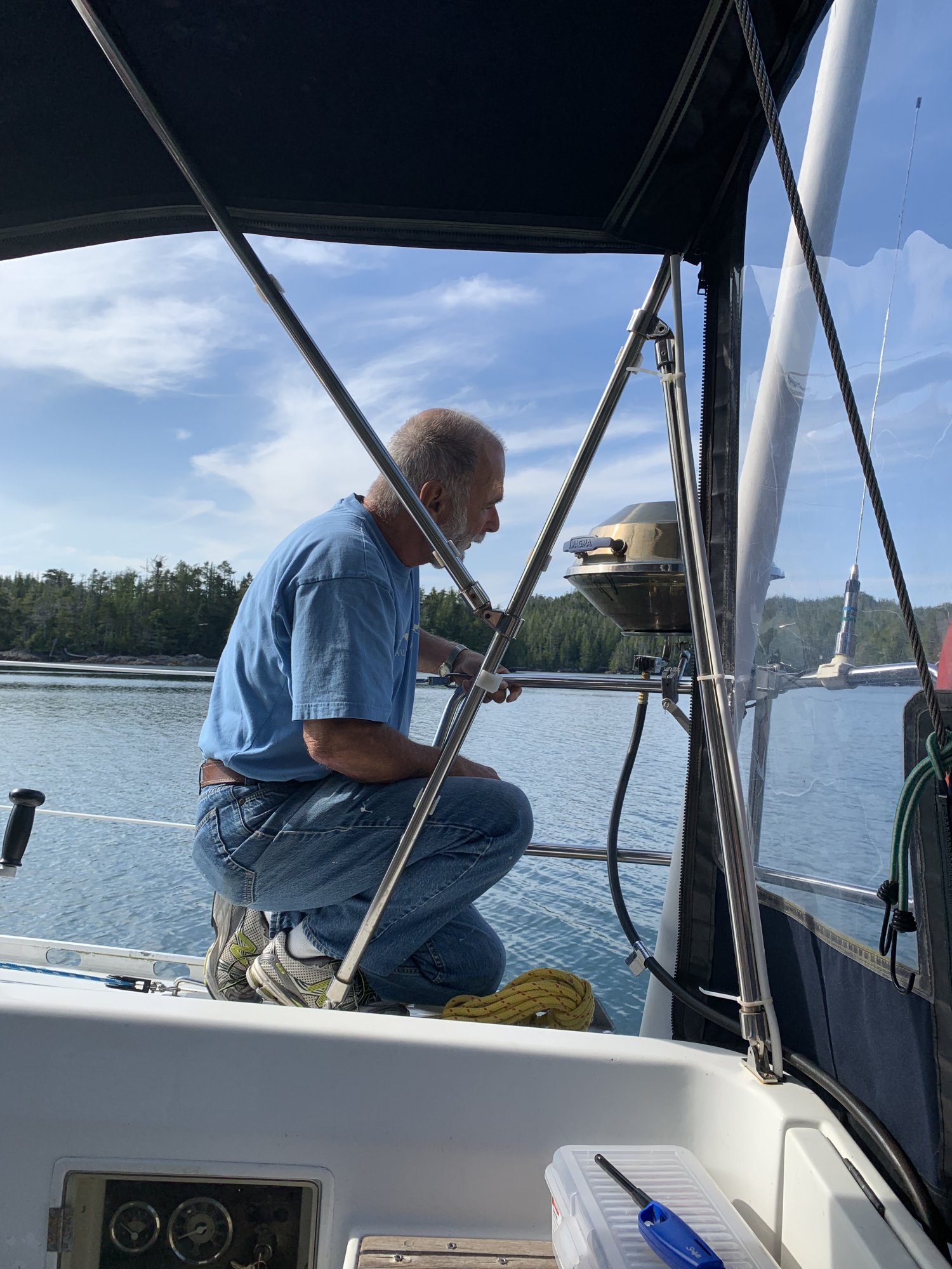

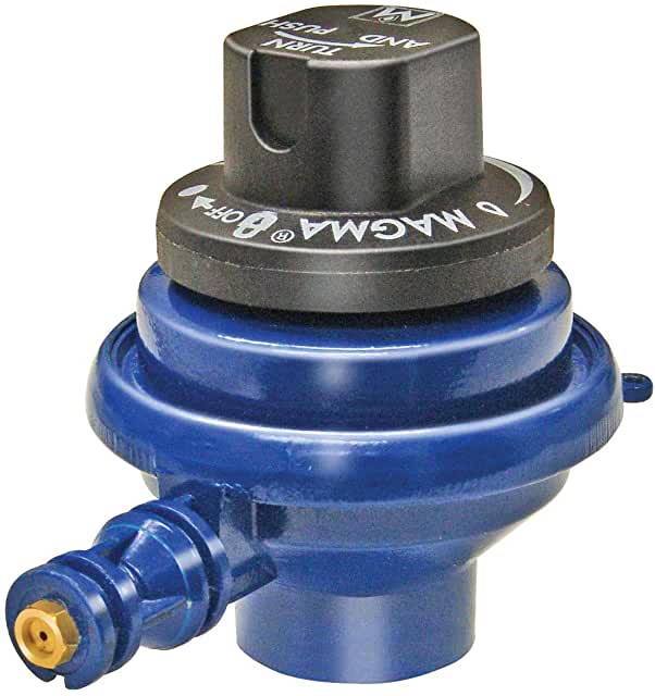

Is there any consensus on what is the best boat barbecue brand? I have tried the two most prominent names, Dickinson and Magma, and both have fallen short. My current model is a Magma, for which I paid a small fortune. I like the way it mounts to the rail but oddly the regulator is not permanently fixed to the main unit and must be stowed separately. (See pic) The regulator detaches from the main unit so easily I feel compelled to secure it to the rail with a piece of cord. Does anyone else HATE this?

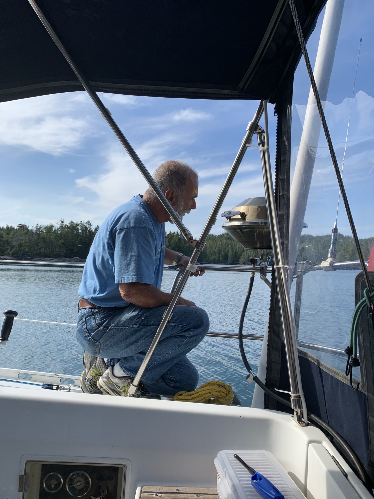

I have gone through the same issues over the years and have had several brands, i.e. in chronological order 2 force 10, 1 Magma, 1 Kuuma and for the last 4 years the smaller of the 2 SeaBQ models by Dickinson. I love the way the SeaBQ is fixed to the railing and can be easily removed. I also like the fact that the grill is in 4 sections and can be removed easily for cleaning. I don't care much for the idea that the finish shows some kind of discoloration to the SS because of the heat but having seen that on most of the ones I've owned I suppose I can live with it because I keep it covered when not in use. I have a small tank which I tie-wrap to the railing and it works perfectly. I keep 1 or 2 of the small portable containers just in case I run out with the main tank but it has not happened. I have had to clean the holes of the burner when the flame started to lessen and to be blown out when windy, but other than that it has worked flawlessy. See Pic of installation.

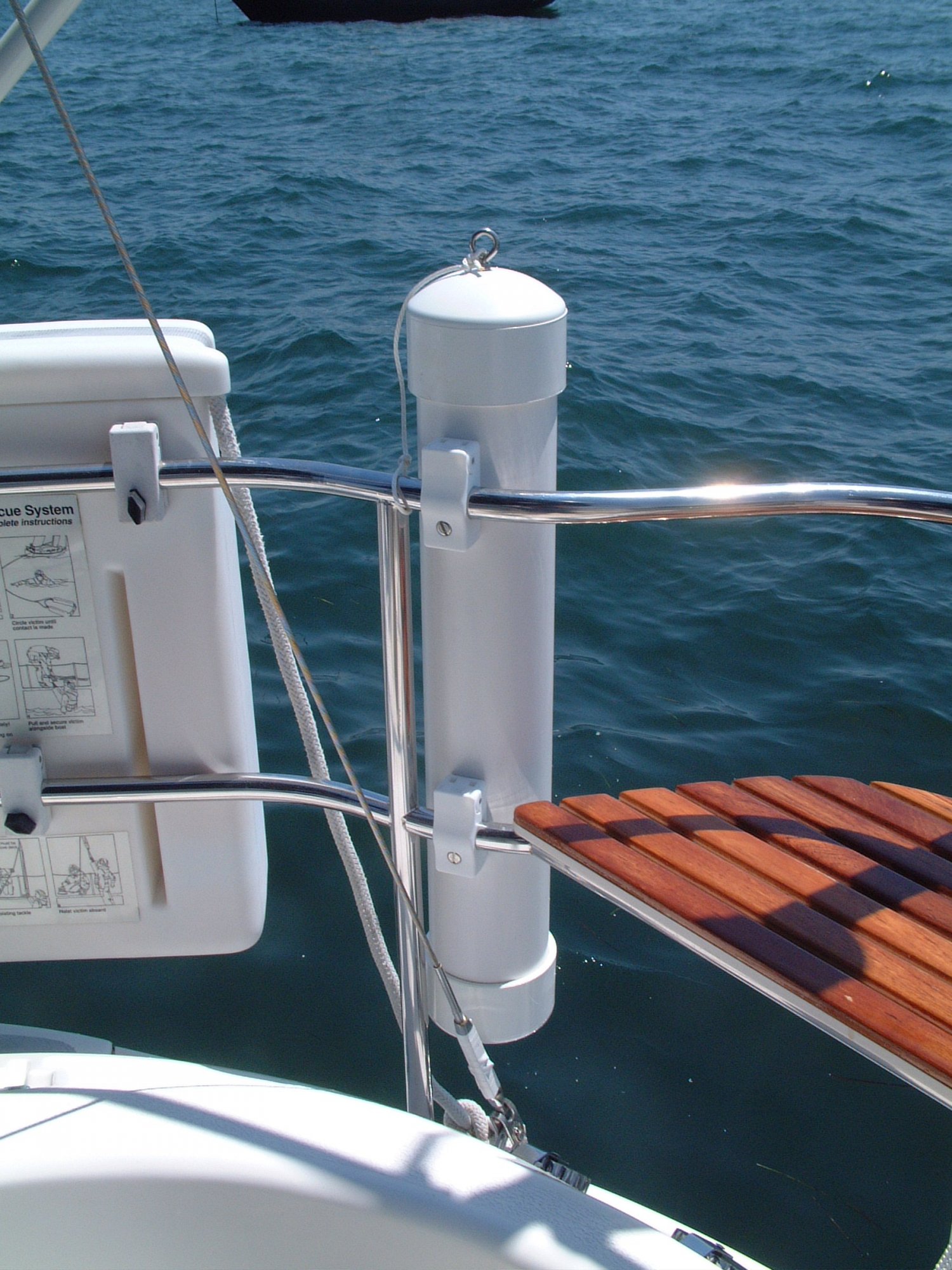

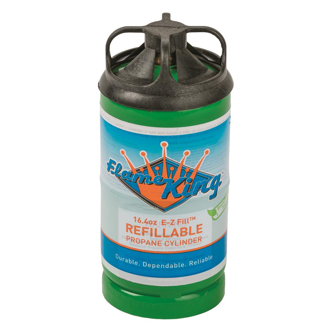

Regarding the 1# propane bottles, I used to refill them but it was difficult and time consuming because they are not designed to be refilled. However, Flame-King makes a 1# bottle that is designed for refilling and it takes just a couple minutes to do the job. They are available at Home Depot and other places for about $15 each. They are the same diameter and just a fraction of an inch taller. I keep three of them in the 4" PVC holder that I designed and made.

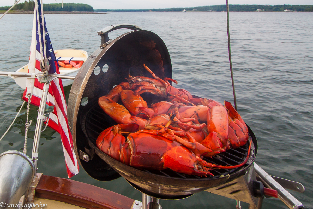

We use the Magma kettle now. Have used Force 10 and Dickinson but the kettle is the only one that has never been blown out. We run it on the ships regulator from a 20# tank. We cruise 4 to 5 months every year so it gets lots of use.4FAAC9AF-1621-4B36-80BD-E6667DD9A193.jpeg Chef at work

We have the magma marine kettle series 3 and I have never had a blowout under any circumstances. I did put the low flow regulator on it so that it wouldn't cook quite so hot. I feel the regulator that comes with them is way too hot. We have a sunbrella cover for it that keeps the regulator in place so I don't ever remove that when we're out and about. I have never lost food or any component off of the grill to do tipping our seems nice and stable on the rail.
I screw the regulator to the bottle and then leash the assembly before it gets installed over the briny deep.
Don't hate it particularly; but I understand.

Ha! It's funny but I love the fact that the magma regulator just sort of swings with the 1 lb bottle attached. The only way it comes off is if you rotate it to 12 o'clock (something it can't do on it's own). This is what I do (rotate to 12 o'clock) when finished and slide the bottle and regulator off the grill body in one piece.
Then it's simple to leave the regulator on and store the bottle, along with a few refills, in the deck box that is safe for LPG. I've never had this grill blow out in the wind whereas our Force 10 was a problem in any breeze (plus it would roll over the rail!).
Jon, pound and a quarter lobsters seem to be the sweet spot. Perfect size for one.
I think as lobsters get bigger, they don't taste as good. We once cooked a 5 pounder on Christmas (I owned a fish market for bit), and it wasn't good at all. Tough like an old chicken.

Concerning the grill, we have the same Magma. Happy with it and no issues blowing out. I also keep the regulator on the bottle and store it that way. No issues with that. The only thing that worries me is when I initially set the grill up on the rail mount and thread it on. Always worried I'll get the dropsies with the entire grill.

My beef for my Magma grill was that it was hard to control the temp. That regulator is woefully inadequate. With a fresh bottle of propane it would be too hot. As the bottle level lowered you could slow cook - like for ribs. The only solution I found was to cook steaks with a fresh bottle and ribs or chicken with a lower one. We kept the bottles in a Sunbrella carrier my wife made which attached to the rail.
We did have an incident of the arm spinning off. After that she made a Sunbrella cover for the grill which enclosed the regulator.
