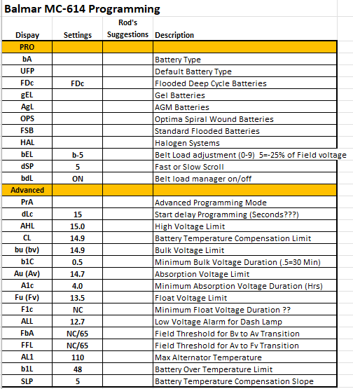

When plugged into shore power the SG-200 shows the correct voltages and amperage charging curves from the onboard invertor/charger, but when on engine power the SCG-200 indicates the correct charging voltage (according to the MC-614 setup see attached) but negative amps, the higher I rev the engine the more negative the amps?
