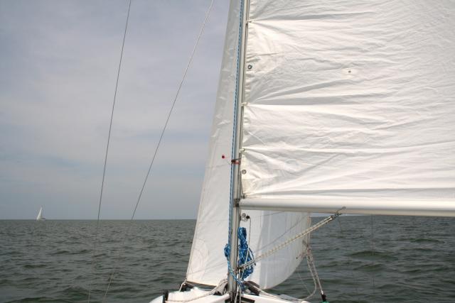

Jib Leads and Track
Alan, et al.:
I am working through the jib lead angles and trying to determine the best location for the track that will provide all around the best pointing capability and ability to maintain speed when flattening the boat when needed. My understanding is the jib sheeting angle should be around 12 - 15 degrees assuming a main sheeting angle around 3 - 5 degrees when going to weather.
Since this thread focuses on windward performance, I will state a few current observations that may provide inside into the proper location of the track for optimal performance. I have attached 3 photos showing the current turning blocks and an older photo of going to weather. Note: the older photo doesn't show good main sheet trim but does give you an idea of the slot. There have also been several improvements not represented in that photo.
Current Observations:
1. When going to weather in heavier air (over 12 kts) the current jib lead angle has a tendency to backwind the main. Especially if the AOA of the boom is adjusted with the traveler or main sheet in order to reduce heeling moment (as in eased).
2. When going to weather in lighter air (~5 kts) trimming the jib sheet tight, the main sheet tight, and pulling the traveler to windward will keep us alive. It’s a stretch and a struggle and we do stall out easily as if the slot is too narrow.
My first inclination is to move the track further outboard around 2 - 3 inches to create a wider slot. Using "reckoning" I'd say the current JSA is about 8 - 10 degrees and it feels too narrow. However, I'd appreciate any input you all have based on the attached photos. Additionally, please provide any other comments on placement that you can think of.
Thanks!
Paul.

Paul et al.,
My thoughts exactly about the jib backwinding the main in a bit of wind. You can see the luff of the mainsail is luffing (when without the jib it would not be) when the jib is sheeted in tight. (even with the traveller midships). I do think things should improve with the leads outboard. My first post was sent after I held the sheet by hand at various places; the best looking slot was with the "lead" just aft of the stays, mounted on the cockpit railing. (This would put them where they would be in almost every other small boat I have sailed).
