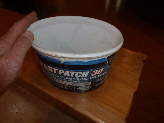

I like the way Centerline set up his unit, but these Garmin transducers are so long that I doubt you'd find a piece of pvc suitable. I just played with a piece of 4" pvc, but it couldn't be formed large enough to go over the unit. If I end up mounting mine inside the hull I think I'll cut up one of the containers shown below. lots of different products come it this size and shape from soap to fix-all and plaster products, and it gives plenty of room for the long skinny Garmin transducer.

Thanks again.....RussC...what kind of container is shown in the photo above...It's not clear on my screen....looks about the size of a chewing tobacco container..... Thanks for sticking with me everyone...Patrick

Pat: Did you click on the image to enlarge it? My hand is much larger than a tin of chew :laugh:
the container measures 7.5" x 5" on the top to 6.5" x 4.4 on the bottom. 5" deep. the one I have had fastpatch in it, which is a product I used to level subfloor irregularities before installing tile or vinyl etc. but the same container is also used for powdered soaps and other things.
The Garmin transducer measures 6" x 2" BTW.

Russ C..what is the container....like a container you see with mashed potatoes already made?...and I run both wires to the battery directly and the cable to the transducer...? I'm about to get brave.......80 her today....everything is blooming, but they are saying a chance of snow by Friday and then below normal for the next 10-14 days.......how do I get the cable up to the
