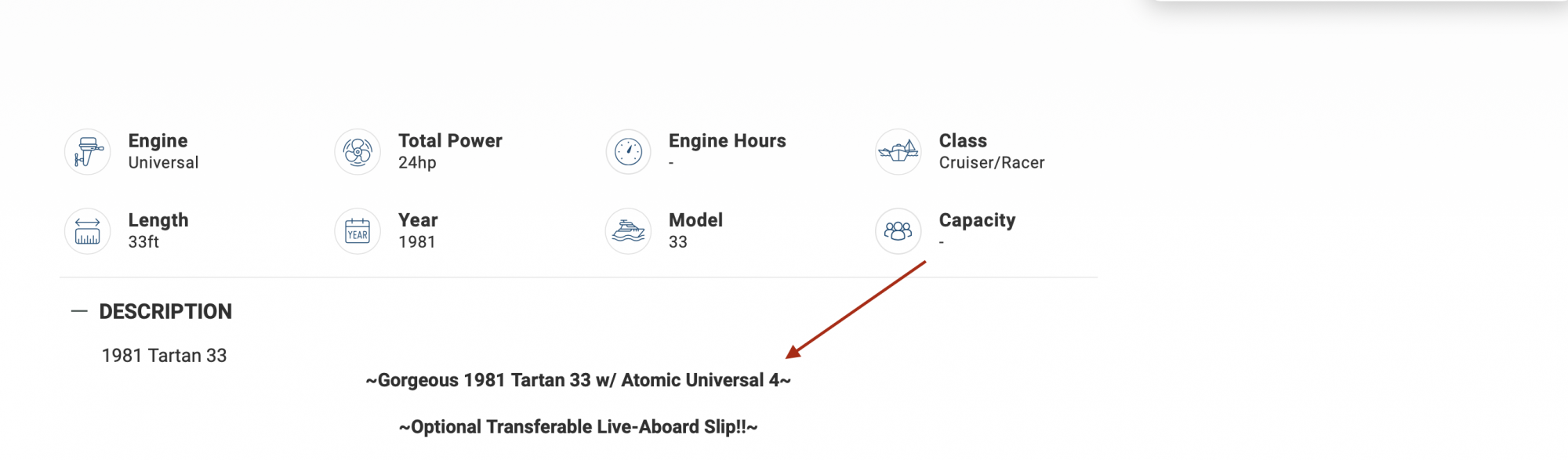

@dlochner the yachtworld listing does show a diesel as the engine type.
The listing is a bit uncertain. See the screen shot below. Engine listed as a Universal in one place and in another "Atomic Universal 4" in another. Universal built the Atomic 4 and Tartan used them in the 27 and maybe the 33? Comparing photos of the A4 and the engine in the ad, they don't appear similar. In particular the large flywheel the A4 has is not there. Clearly identifying the engine would be important before purchasing the boat.

I noticed the advertisement says atomic 4. I watched the video, and assume what I saw was just that…but I have never seen one before…so hard for to tell. Ran quieter than my Yanmar 2GM20F for sure.
I would think that the Atomic 4 would knock the price down some.

That is NOT an Atomic 4. It is a Universal diesel. The front engine mount is loose, you can see the washer vibrating when the engine starts up.
