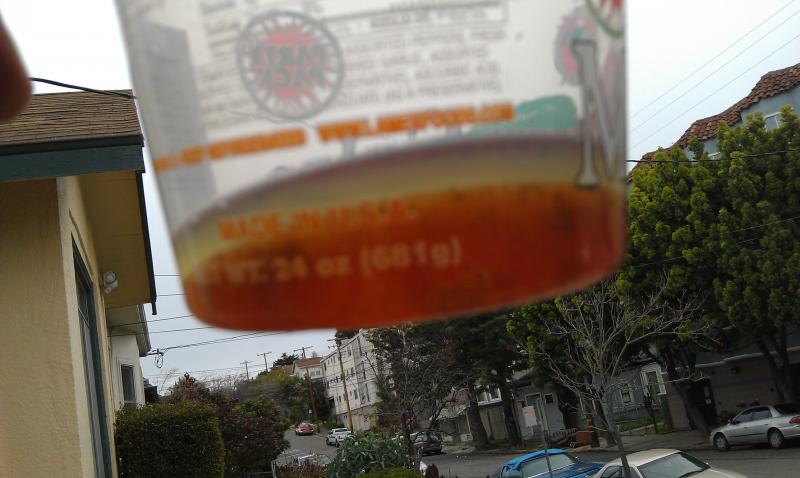

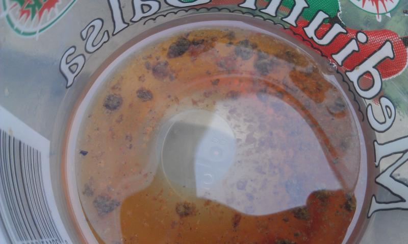

Here are two photos of the remains from the bottom of the (plastic) jerry can. Some of the crud in the bottom definitely looks like and feels like sand. As for the red colored layer -- maybe that's the remains from diesel bought at a marine? Or maybe algae?

the red goo is algae. biocide is effective .... have fun!
Thanks, zeehag. I was just going to change my previous post to delete the part that suggested that the red part might be from dyed fuel from a marina, because I've never filled the jerry can at a marina. So now I definitely know that I have algae in my fuel. From what I'm reading, I should probably get rid of all that fuel. As for the fuel tank, can I possibly wash it out in place and drain it from down below? Is steam cleaning a possibility?
