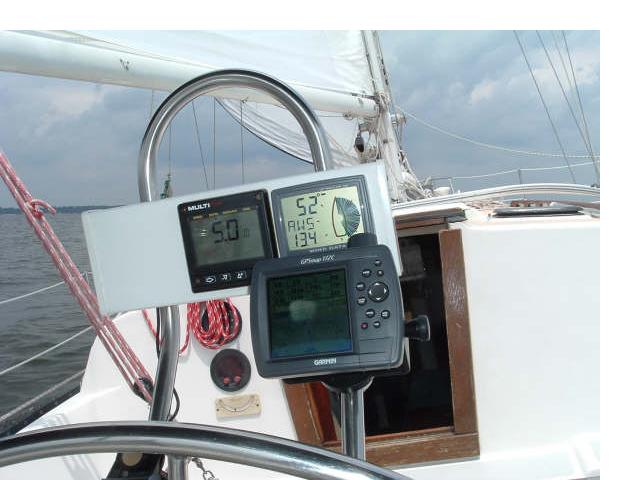

Personally, I have a fixed mount Garmin at the helm and nav station. Both have built in NA charts but also can share charts between them for when I buy chips for outside the US. The laptop is a backup at the nav station and also used for route planning. It also works for my AIS control and SSB email(when I finally hook it up)

Lake Erie to Tampa was so simple. The Garmin never failed us. We did have the laptop as backup with freebies.
