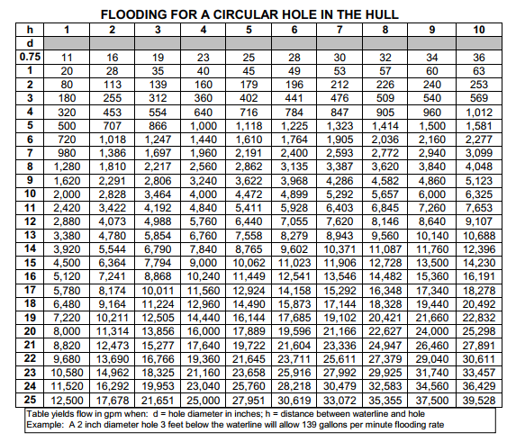

Just something of interest to keep in mind when adding a second pump.
After you consider the dramatic reduction in pumping efficiency on a 2000 gph pump with a head of 6', you might want to reconsider the size of your back up pump.
Very handy and informational chart.
My draft is 3'10" and I have 3/4" thru hulls. Using 2' head pressure I could expect 960 gph inflow. My 1500 gph might keep up with it depending on hose type, distance, etc. Good information to know.
