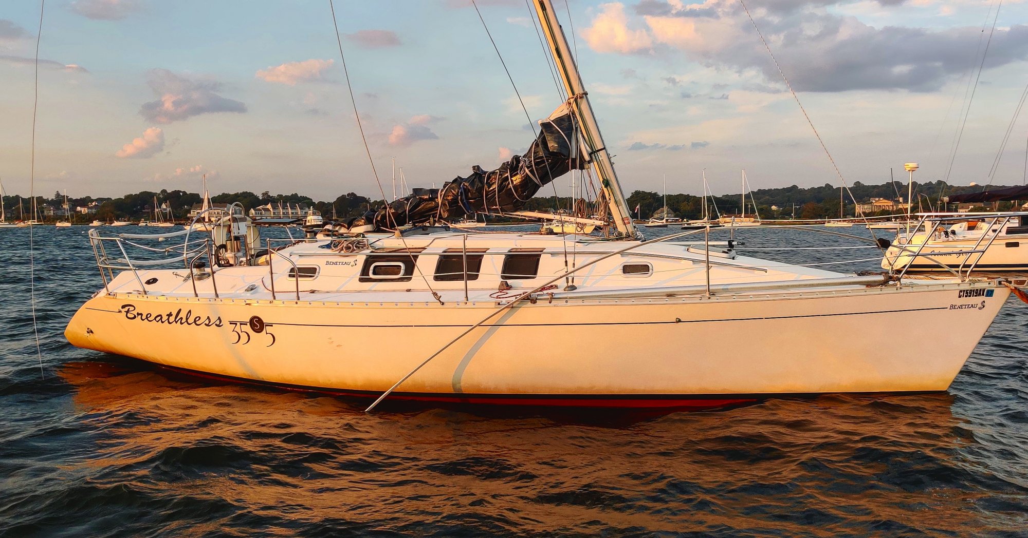

I hope you have good insurance. This is could be expensive, it looks like the deck at the mast step has been damaged.

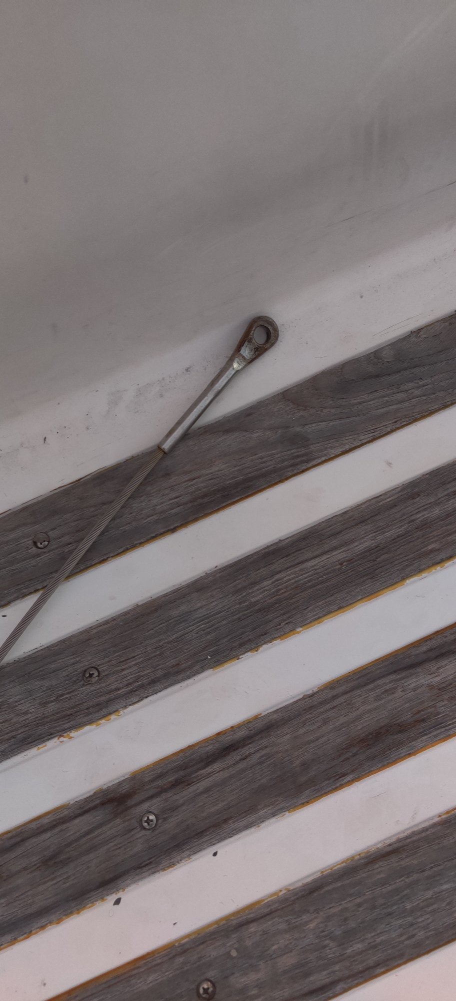

The forestay is not connected to the mast while the back stay is connected. This leads me to believe the forestay failed, where I can't tell. It could be a pin that fell out, it could be a bad swage, it could be the fitting at the mast, it could be the wire. When was the last time the rigging was inspected and replaced?
The best short term course of action is to stabilize the mast as it is and get the boat to a crane and remove the mast. If the deck is damaged, protect it from water getting into the core. Once the mast is on a set of saw horses you'll have a better idea of what caused the failure and whether the mast can be repaired or needs to be replaced. Taking a look at the upper end of the forestay would also be informative.

Wow, it seems you had multiple things go wrong pretty much at the same time. Looks like the headstay broke (it could have been the headstay fitting that broke), then the pin came out of the backstay. I can only imagine your rig was way too loose and things just wobbled around until something broke. Might be time to get that stick off of the boat, check that it is undamaged, then if OK rewire the boat with new wire and get a professional rigger to set her up for you. If you can be there and watch and question him, then maybe you can do it yourself after that.

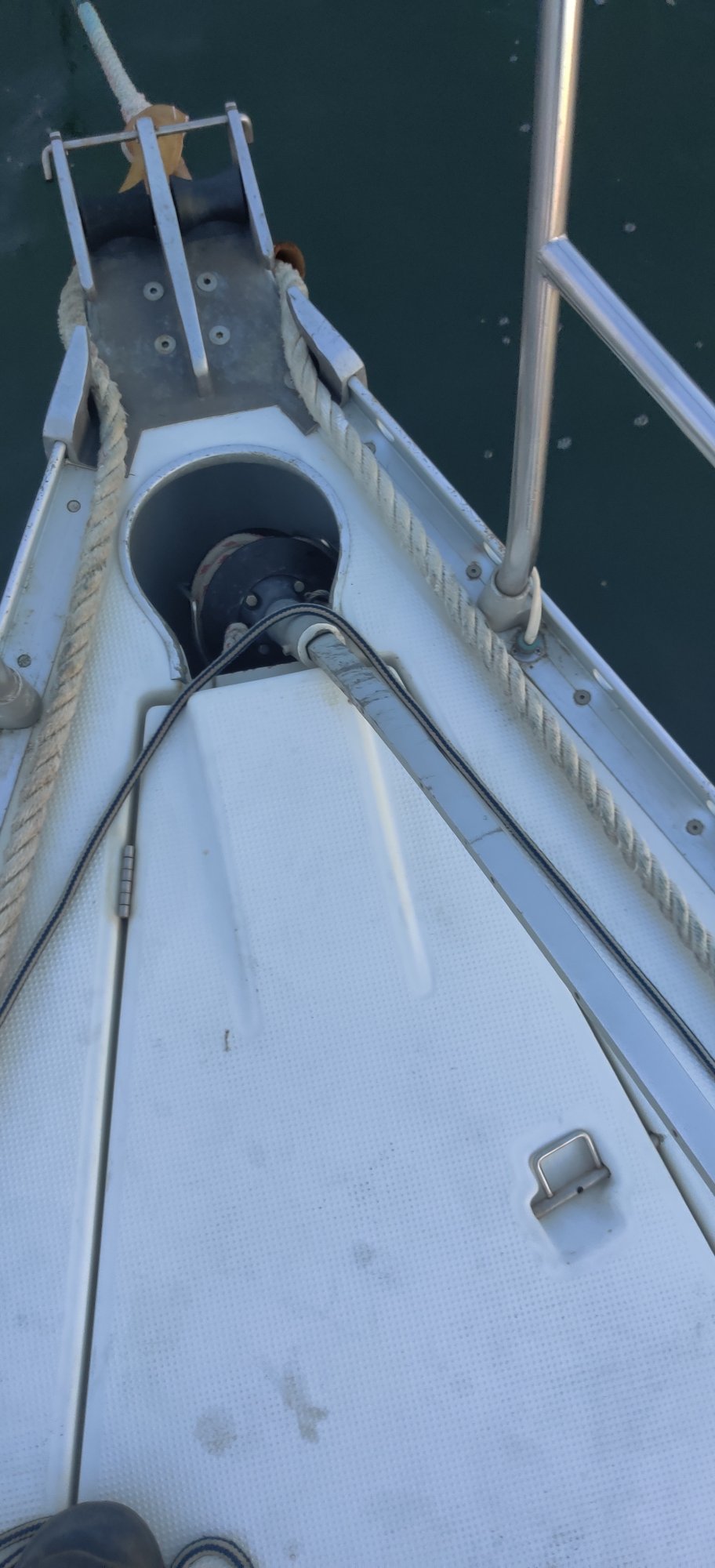

I posted some photos and a description of how I found her. Is it not possible that when the backstay clevis fell out it contributed to the failure of the forestay? In big chop when the boat sinks into a traugh the forestay can become slack and when the boat bob's up out of the trough there would be great strain on the forestay?

Just to get a better picture of the situation here.
It's a 1990 Beneteau 35s5. Just upgraded last year. The only part of the boat that was not surveyed was the standing rigging aloft. Lesson learned! Good thing I have coverage and world class riggers here in Newport RI.

What is the condition of the forestay? Did the wire rope part? Or did the upper pin come out?

I haven't seen it yet. I pulled it out of the water and tied it up down. Hopefully the yard will step it Friday.

In the photos the forestay/furler are overboard with the spool still in place on the bow. Looking at the end of the forestay that is in the water should tell the story. Likewise what's left on the mast would too. Do we need to start a pool here? Put me down for a failed swage on the upper forestay.
