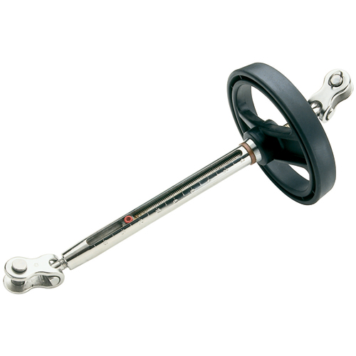

A block and tackle system is the natural solution for a boat with a split backstay. But the OP has an older boat with a single backstay and it would be a major pain to attempt to install two new chain plates to try to go to a split, so a device like the Wichard can easily be installed inline by shortening the existing backstay. Seems the only way to do it.

It's a worthwhile addition. If it's a split backstay, I prefer @Joe solution. It's a very good one. If it is a single backstay, the Wichard would be my choice. I used a Johnson split backstay car on my Starwind and did not really like it. There was too much friction and the car would not release until I manually pushed it up.

I opted for the Wichard model
Works fine. Easy to adjust.
Hi again...
I just got the wichard adjuster today on the mail now how to work from 1/2 inch schackle to a smaller diameter cable like on my Bristol 24?
