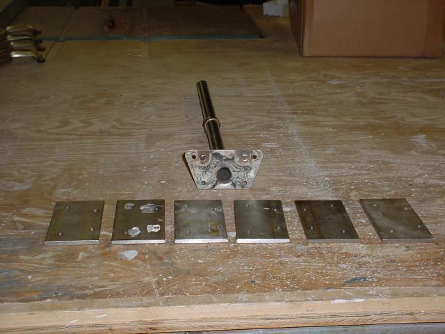

Make them yourself out of Starboard material or go to a steel/welding shop and see if they have some stainless or aluminum....I walked into my neighbors steel shop and found some nice stainless about 3" wide and replaced all the weeny washers Oday used for backing plates, there were areas that couldn't get the stainless plates so I used thick fender washers

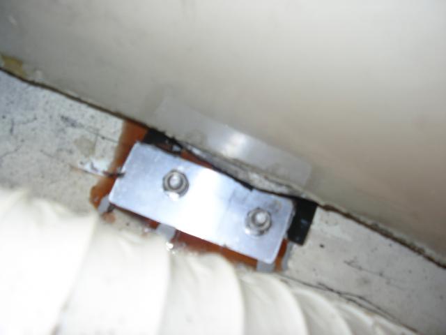

I got some aluminum at Lowe's, cut it to size, and drilled it out matching the cleat while it was off. I then held the plate in place with the bolts while I added Gorilla tape to remove the bolts and add G-Flex epoxy. I did this to get a flatter surface for the backer and reduce the size of the holes since there was some elongation. The tape covered the entire plate and tightly around the sides to keep the epoxy in.
After it hardened overnight, I removed the tape (mostly) and using the cleat as a guide to drill straight down from the top. I was able to hit the holes perfectly. Then I used a countersink to taper the hole.
Using Butyl tape around the bolts and on the bottom of the cleat I snugged them down tight. Here's a pic.
