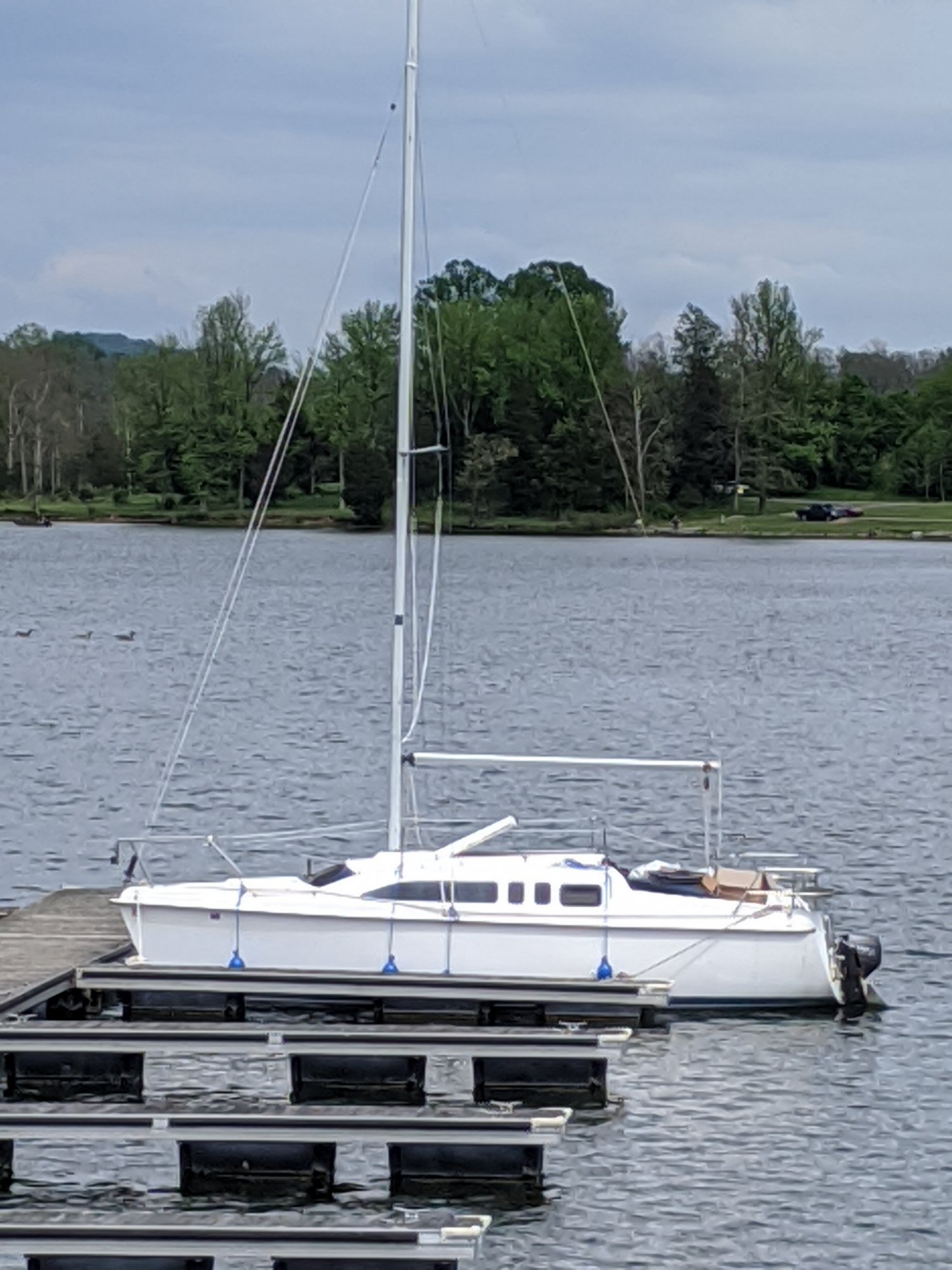

My boat at the dock next to the launch ramp. My permanent slip is the same size and configuration

this is our boat but at the Docks right next to launch ramp. our dock is the same size and the pic shows the size correctly

Floating dock? Perfect. Use spring lines and tie her fowards to keep the motor off the dock. Very easy. With a floating dock, there is no tidal considerations, tie her tight in her slip.

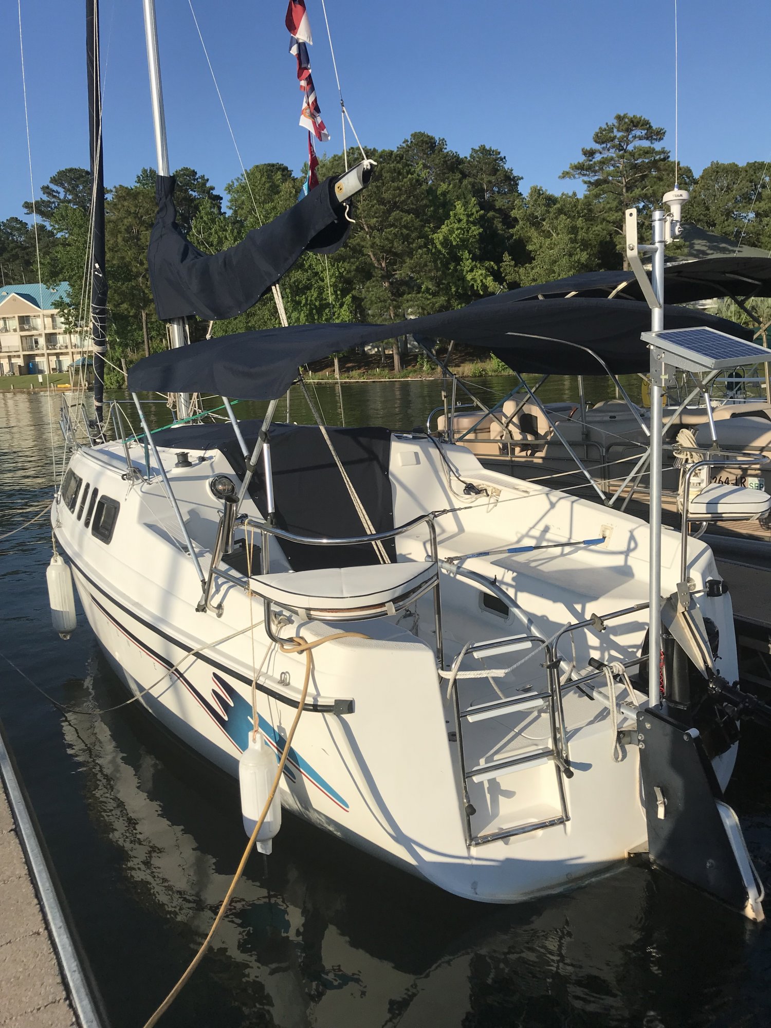

I have a hunter 26 and always dock transom first.
In the pic, you can see the spring line running from the transom cleat forward to the forward cleat on the pier. Adjust your spring lines so the O.B. and rudder cannot reach the back of the slip. When I have guests, I tie a line from the stern pulpit to the cleat on the dock and then pull the port corner of the transom all the way to the pier. With the swim ladder down, that makes for an easy step onto the boat.
Here is a pic.

My Song, in your picture, I see a couple of issues. As others have suggested, spring lines are necessary, whether bow in or stern in, I don't see one on your boat. And I notice that you have a short dock for the size of your boat. Your bow is almost touching and almost 1/3 of the boat (including motor and rudder) is beyond the dock. I will assume that longer docks are not available, but if you are stern in, about 1/3 of your boat will be in the slipway.....not an ideal situation.
On rgrangers picture, I see there is a walk through transom, you will probably need a sturdy gang plank arrangement to use it, the stern of the boat will be too far from the dock.
A better solution may be bow in, with a good set of steps on the finger dock.

that picture is when we were launching. as I mentioned those are the courtesy docks next to the launch ramp and we didn't even have our sails on yet.
we do use spring lines anytime we're going to be docked for very long

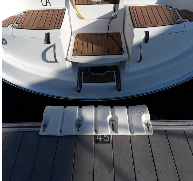

............Does anyone have any suggestions on what to do?
Install a Plastimo fender (part #P65690) bolted to the dock OR hang a regular say 10" x 30" fender over the dock with a rope tied to each end (or through each end) with the lines secured to each side of the dock. I also have the Plastimo fenders on the side of each finger and the latter at the end of each dock to avoid touching the dock while leaving and backing in.
