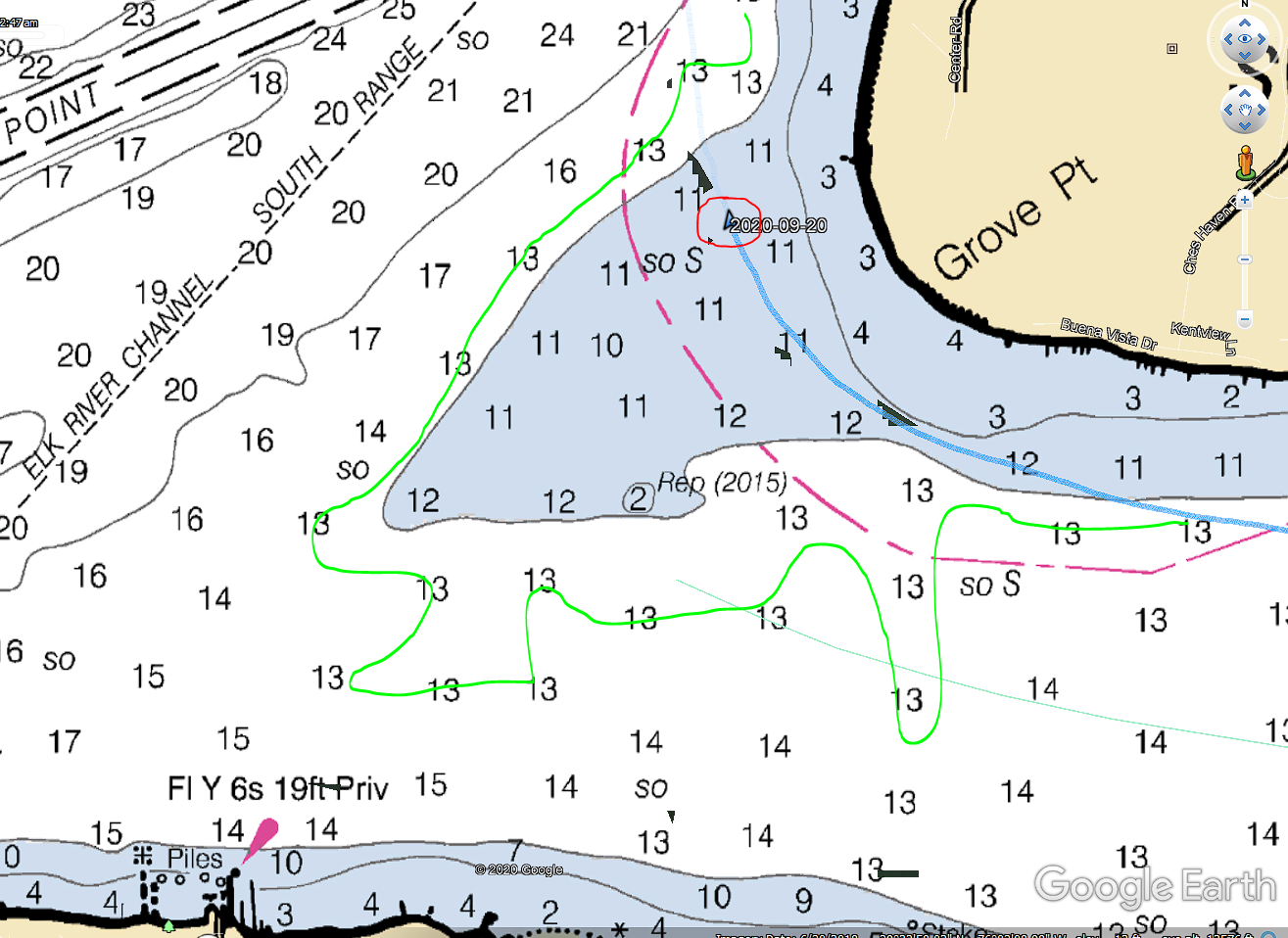

I've heard before about how you could supposedly determine your position from depth soundings. What am I missing - looking at a chart I don't see how that works.
Here's a position from a recent trip I took. I was inside the red circle, reading 14' of depth. It was an incoming tide supposedly 1' above MLLW, so I should be looking for places charted as 13'. So I could've been anywhere along the green line, which is not a very precise position, and not correctly where I was -
I don’t think that’s exactly what was said; here, at least. I think Don’s point was that if your depth sounder fails, you can know the depth under you from your chart, if you have your chart position. If you are coming toward shore and your sounder goes out, but you have a chart track, position, you’d know how close to approach, etc., if it’s all charted correctly. With fog, it’s the same except that there is no evaluating the situation further looking toward shore for changes in water hues, or other indicators. Without the sounder in fog, you‘d have ONLY the plotted position on which to rely, although possibly with fog signals. Everyone here voicing an opinion agree that relying on a sole source of “input” while piloting is not best seamanship. Lacking sounding you would have no confirmation of your depth. Breakout the lead line (or digital) before coming closer. We’re talking here about a fm or more of variance, not a foot or two.

I don’t think that’s exactly what was said; here, at least. I think Don’s point was that if your depth sounder fails, you can know the depth under you from your chart, if you have your chart position. If you are coming toward shore and your sounder goes out, but you have a chart track, position, you’d know how close to approach, etc., if it’s all charted correctly. With fog, it’s the same except that there is no evaluating the situation further looking at the shore for changes in water hues, or other indicators. Without the sounder in fog, you‘d have ONLY the plotted position on which to rely, possibly with fog signals. Everyone here voicing an opinion agree relying on a sole source of “input” while piloting is not best seamanship. Lacking sounding you would have no second confirmation of your depth. Breakout the lead line before coming closer. We’re talking here about a fm or mor of variance, not a foot or two.
All good points. The assertion that you could approximate your position based on depth wasn’t explicitly here; I’ve just seen it elsewhere and Don’s post just got me thinking about it. And I’m sure the usability of the depth data does depend greatly on the region where you are. Where I sail everything is pretty much within a fathom of everything else, except the channels. Where I grew up sailing there wasn’t such a thing as 2 fathoms of depth. Places where there are sharper contours will have different considerations both for the usability of soundings and the need for them.
The problem arises when us pleasure boaters use charts made before GPS. The powers that be are updating charts used by commercial vessels, but not much is being done to update charts for us. We just aren't a big enough market for the expense. So, your GPS is giving you your actual position withing a few feet, but when they made the charts, they were hand drawn from soundings taken on a compass bearing from a fairly accurate, but not GPS accurate position.
