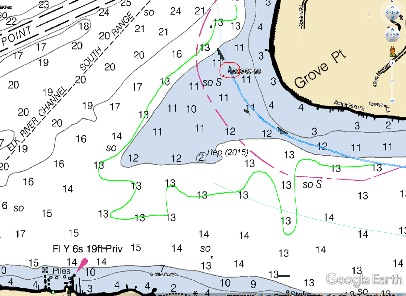

I've heard before about how you could supposedly determine your position from depth soundings. What am I missing - looking at a chart I don't see how that works.
Here's a position from a recent trip I took. I was inside the red circle, reading 14' of depth. It was an incoming tide supposedly 1' above MLLW, so I should be looking for places charted as 13'. So I could've been anywhere along the green line, which is not a very precise position, and not correctly where I was -

A fair point. Using depth to fix your position depends on the bottom contour changing. Not all areas are suitable. You would also need a line of position from some charted feature. Suppose you knew you were on the depth contour of 11/13 feet. That with a LOP would give you a reasonable idea of your position. It would also eliminate a lot of area that you could say "I'm not here." That's not as good as knowing where you are but it's better than nothing. Presumably you would also have a DR plot that would contribute to your confidence. Obviously we all would prefer the DBO accuracy of the GPS or Chart Plotter.

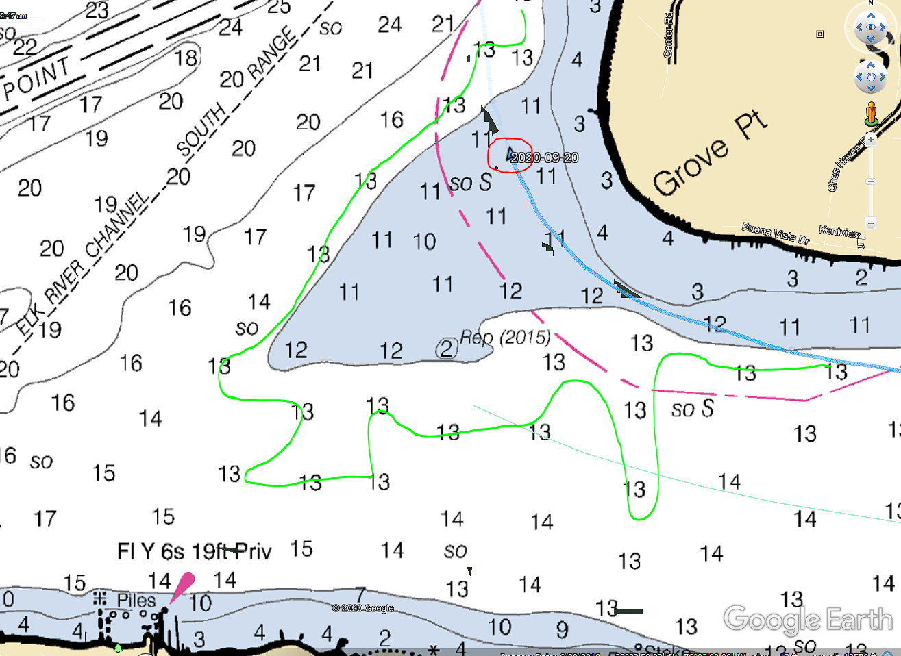

The problem arises when us pleasure boaters use charts made before GPS. The powers that be are updating charts used by commercial vessels, but not much is being done to update charts for us. We just aren't a big enough market for the expense.
So, your GPS is giving you your actual position withing a few feet, but when they made the charts, they were hand drawn from soundings taken on a compass bearing from a fairly accurate, but not GPS accurate position.
I've seen sat pics of an island beside the hand drawn old chart of the same island and you wouldn't believe they were the same island.
