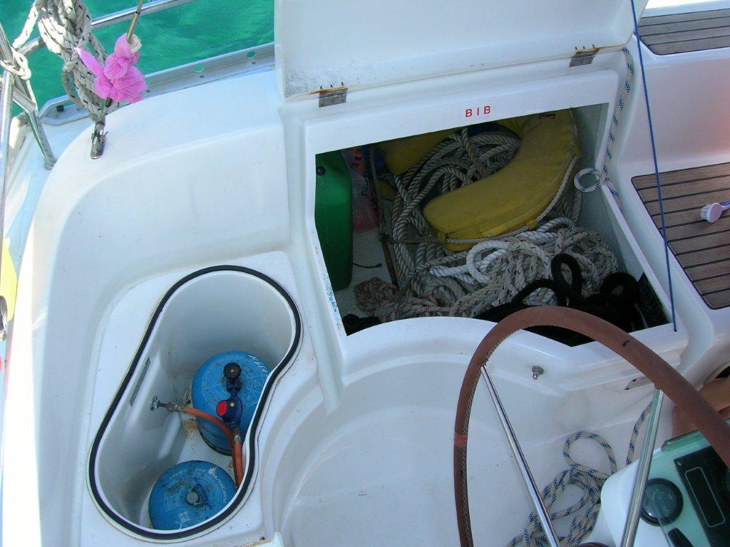

When I bought my B361, it only had one propane tank, but space for another in the gas locker. Not wanting guess which one I should order, I thought I'd post on here in case anyone knows a model number of a propane tank I could order from Defender or another vendor that would fit in the gas locker.

How about a picture of the tank you have.

Almost 100% sure it is a 10lb Worthington 299889 aluminum. 10 1/4" diameter, 16" tall.

Thanks Gunni, that looks like the one I have. :) Philip, the tanks shown in your picture seem a lot smaller than what I currently have. I'll measure the space when I go up to the boat this weekend and confirm the dimensions, in the meantime, I have the Worthington tank in my Amazon cart awaiting the results of the measuring. :)

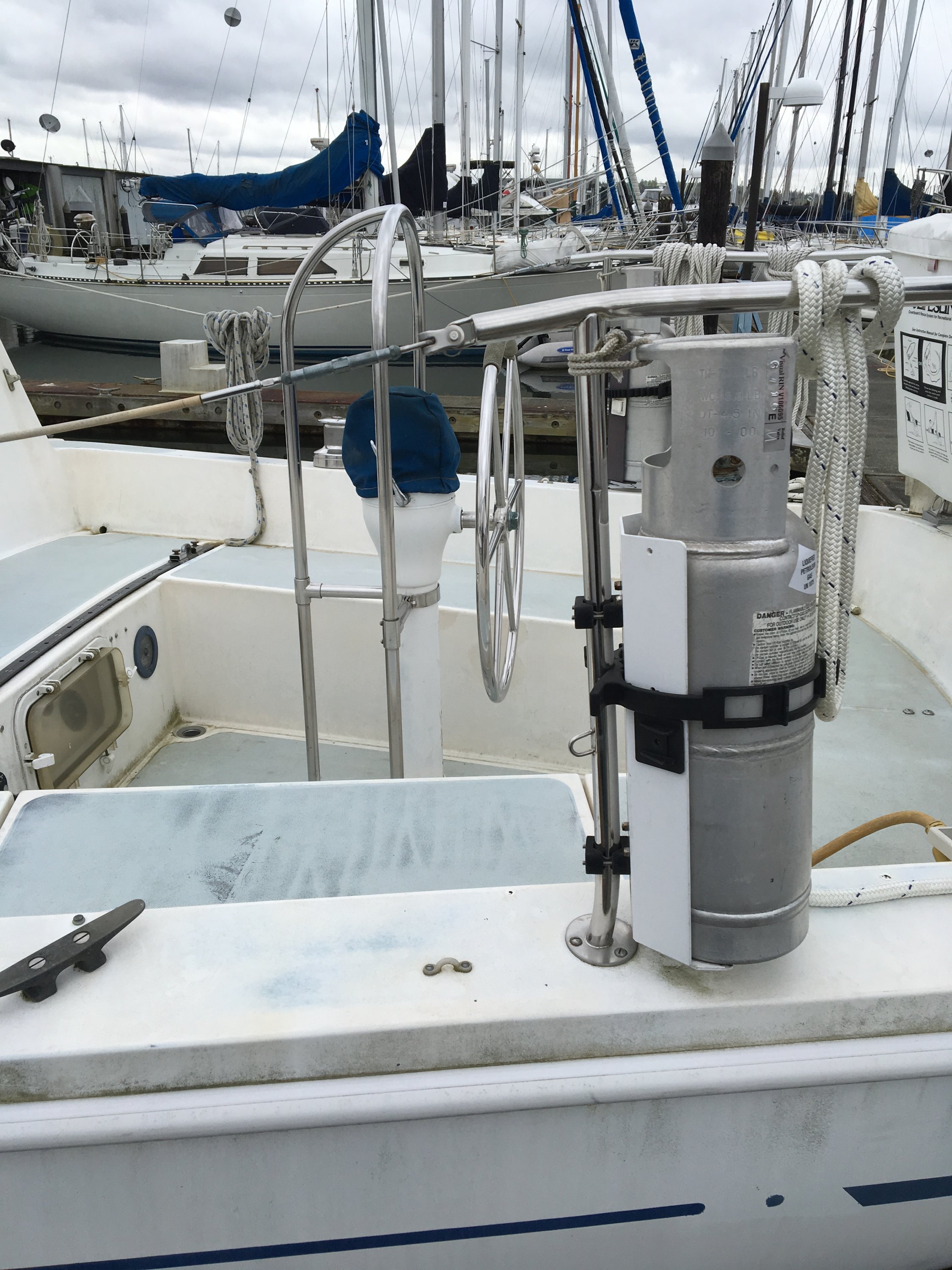

Tanks come in all sorts of shapes and sizes.
I have two of these on my Cal.
