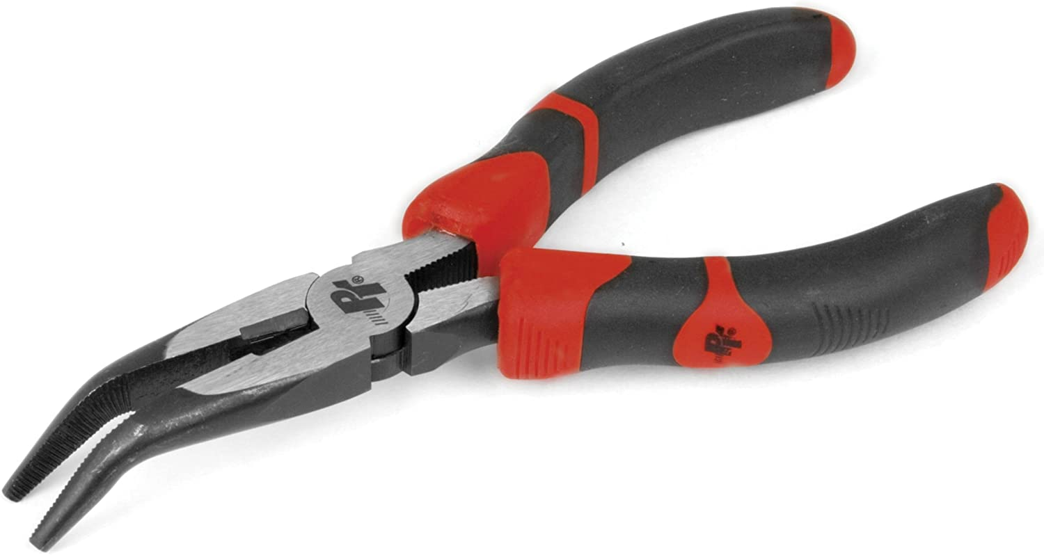

I've replace mine on the H26. The pin is held in with 3M 4200. For me this was the right tool
Grab the pin... you might need to break one of the sheaves to make room to get a good grip of the pin. Then start gently twisting and pulling and be patient. It will slide out. Clean it up and pull out the old 4200 with the plyers. Replace with the same
