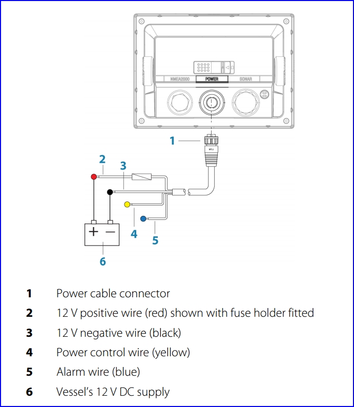

I acquired a Vulcan 7 but it came without a power cable for the 4 pins on the back. The cable is available for $42 which I will purchase but was hoping to bench test it first but the B&G manual naturally does not show the "pin-out" for the plug. Does anyone have this info or have a Vulcan 7 they might be able to disconnect the power supply for and share which pin the + & - are on (red, black, yellow, blue). See image attached.

Doesn’t the drawing you attached show this?
Don, the OP is looking for the other end of the cable which the manual does not illustrate anywhere. At least, I haven't found it in my manual.
