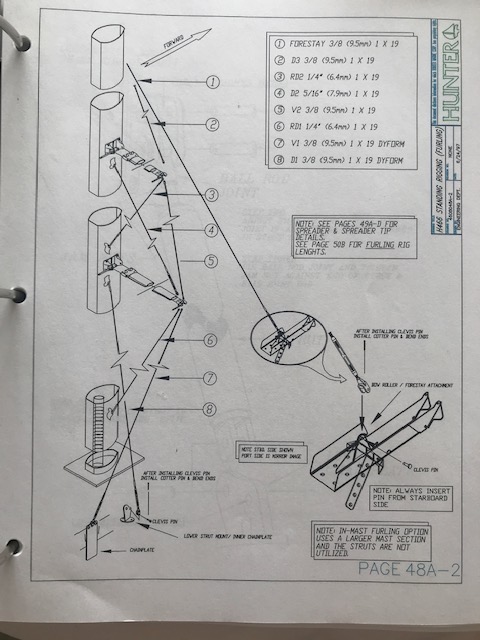

W Waterwindsail . Aug 13, 2018 3 Hunter 460 Quincy, MA Jun 24, 2019 #1 Does the lower diamond d1 cross in front or behind the lower D? Thanks! Ralph Sperry Boston Gypsy Soul Hunter 460
I ice breaker . Sep 11, 2011 435 Hunter 41AC Bayfield WI, Lake Superior Jun 25, 2019 #2 I have tried on both sides, and have not noticed any difference. They interfere with each other. No noticeable wear in 15 years. Fresh water.
shemandr . Jan 1, 2006 8,128 Slickcraft 26 Sailfish Jun 25, 2019 #3 After I disconnected it to put the winter cover on I couldn't remember which way it was rigged. I never did find a significant difference.
W Waterwindsail . Aug 13, 2018 3 Hunter 460 Quincy, MA Jun 25, 2019 #4 Looking at the Owners manual in detail it appears that the Lower D is in front of the diamond d1- see the attached. Can anyone confirm?
