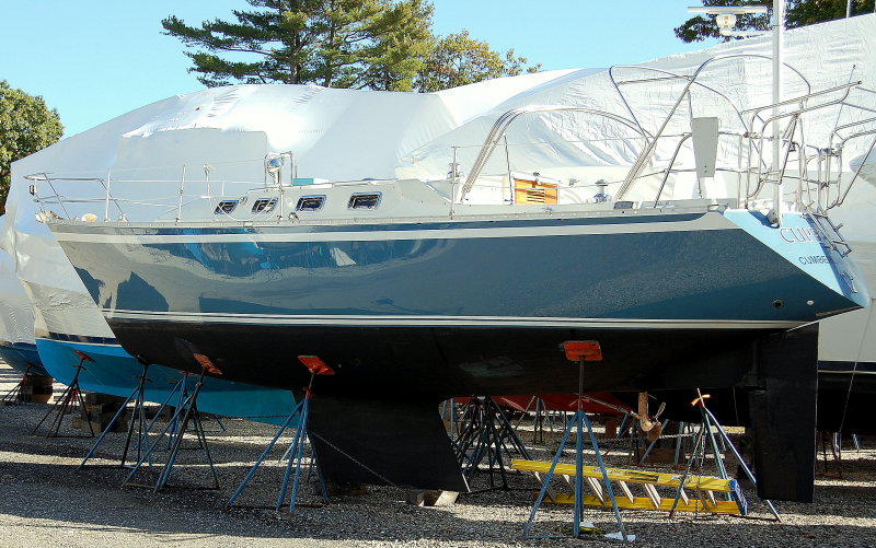

Here is what my paint looks like after 10 years:

Looks great Don. Maybe it has to do with exposure. The awlgrip boat is kept at a mooring as is mine.
