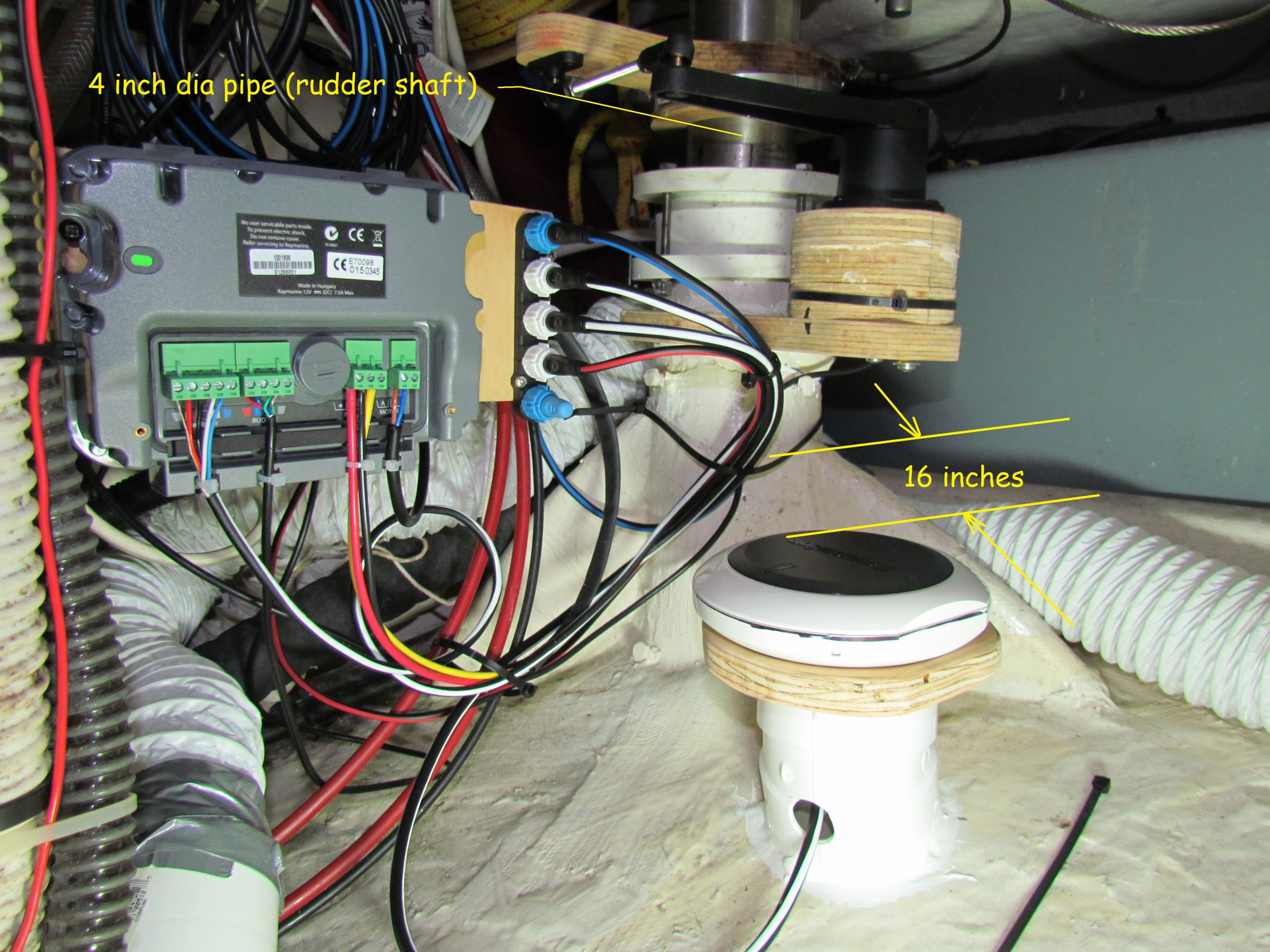

I am curious where everyone is installing the ev-1 sensor. It should be near the centerline and three feet from metal mass. Not an easy task on many boats. I put mine in galley center locker which requires a lot of extra cable. However I have seen two other installs in the engine compartment. One aft of the fuel tank and one between the fuel tank and engine.
Sep 23, 2009
1,480
Thanks for the great pic Paul. How far is you ev-1 from engine and batteries? Any issues from that? I tried using a handheld compass but never really found a perfect area.
paulj
Mar 16, 2007
1,361
Catalina 310 Anacortes,Wa
4 feet from engine, 2 feet from water heater and 16 inches from ss rudder shaft.
I'm showing you how I installed my auto pilot, if you want to know how to install ask Maine Sail or Stu from c34 web
