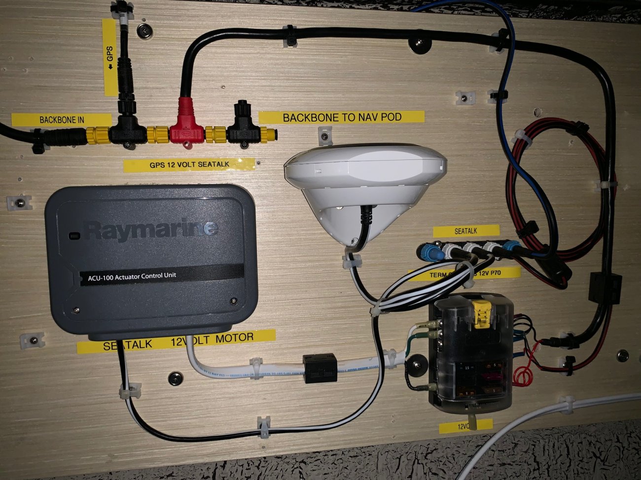

I purchased one and have it installed but have not used it yet. The boat is in storage. The instruction were very clear having been updated recently and the install went ez. I mounted all the "smart stuff" in a locker on plywood and have it hooked up to my existing NEMA 2k with an ST adapter cord for $30. Prices are all over the place. I got mine price matched @ West marine for around $1,280 + tax. The photo is not 100% still have to install the drop from the motor through the pedestal.
