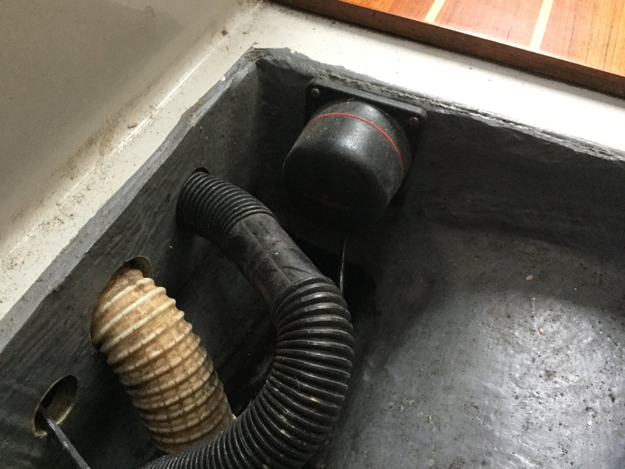

Found mine in my bilge! I guess from a “get it low and in the middle of the boat”, this is a good spot.9F1EDD03-5FF6-4624-9AAC-E8CD06F1E3FE.jpeg
Good luck with the hunt ;-)
