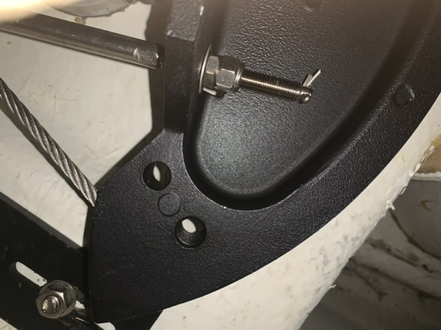

Planning to install linear drive autopilot in spring 2022. My old wheel drive just can’t handle any sea and I do a lot of long distance single handing.
I’ve gone from considering B&G hydraulic including all components to ordering Raymarine type1 mechanical linear drive EV200 etc. on my Beneteau Oceanis 331 (~11,500 lbs).
My main deciding factors: Tech support in my area - Georgian Bay (Lake Huron), all my other electronics are Raymarine, power consumption, good reviews, excellent responsiveness by Raymarine to my enquires. I must say I was very intrigued by B&G because of their pedigree but I wasn’t impressed with their responses to my enquires, especially because I’m planning to do the install myself.
Challenges will be no room for separate tiller arm on rudder stock so have to tie into existing steering quadrant and tight quarters in general to allow sufficient radius from rudder stock.
Carefully consider this option. Most quadrants are cast metal. They have shown a tendency to break under the stresses autopilots can place on the quadrant.
By far the best is to figure out how to install a tiller arm through the shaft. This has the benefit of giving you an alternate steering system, should you have a quadrant failure or cable/chain break in the binnacle and you loose your helm.

No. The quadrant and idler pulleys were 30+ years old and pretty rusty. I'd been out sailing with a buddy in high winds & seas, and he kept driving the rudder into the stops, which hastened the demise of the steering system. My linear drive is connected to a tiller on the rudder post, so I had the alternate steering system as mentioned by @jssailem . Cheers. :beer:

I see. Thanks. My preference would certainly be to have a separate Tillerarm but I don’t have a choice. There are four holes at the aft portion of the quadrant, two of them threaded so that should distribute the load.
The either will or they won't. At the least is there is a failure you will know one of the usual suspects.
