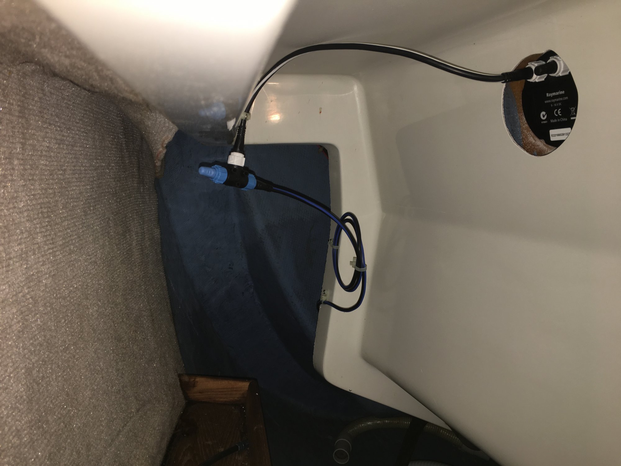

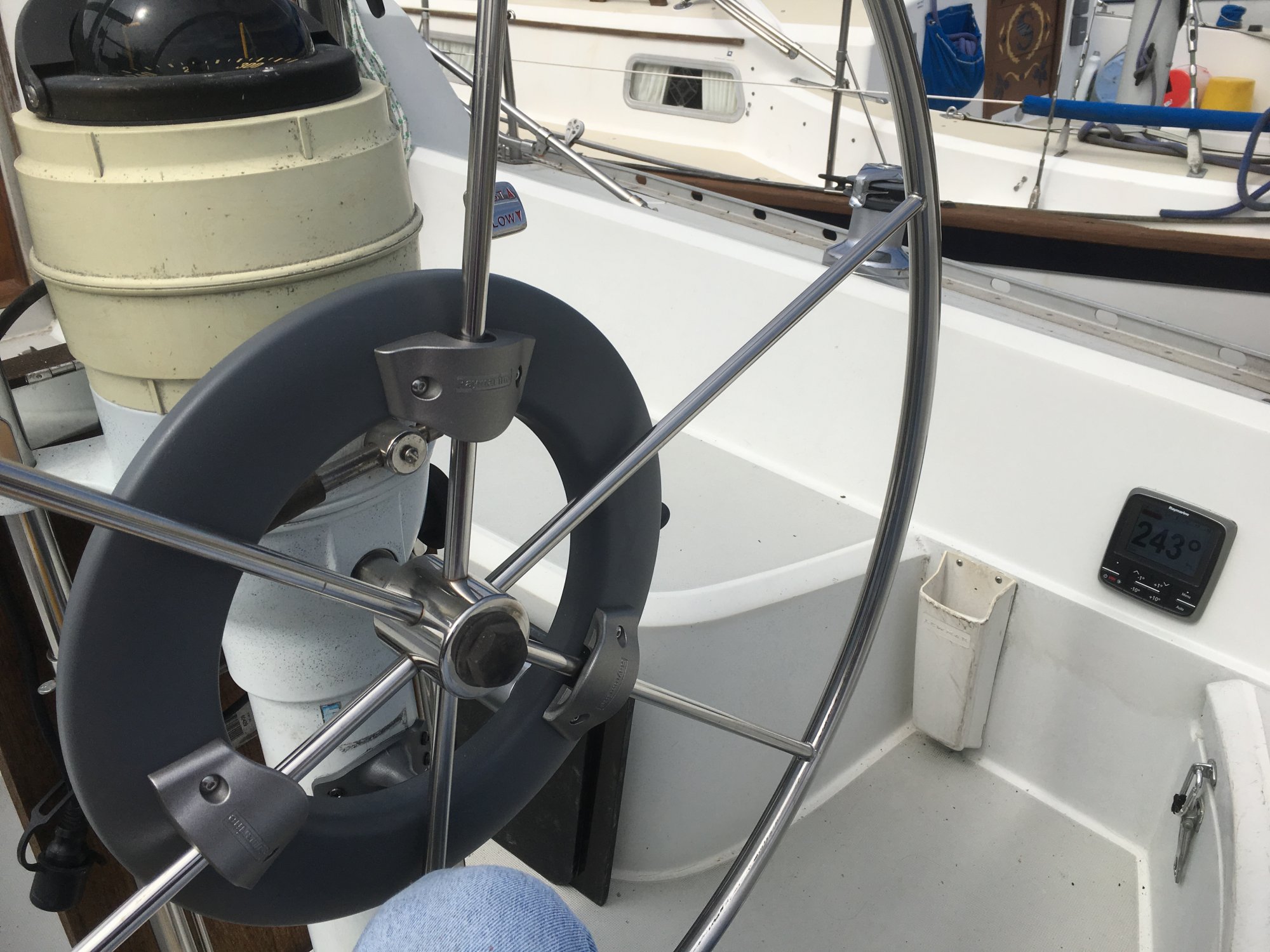

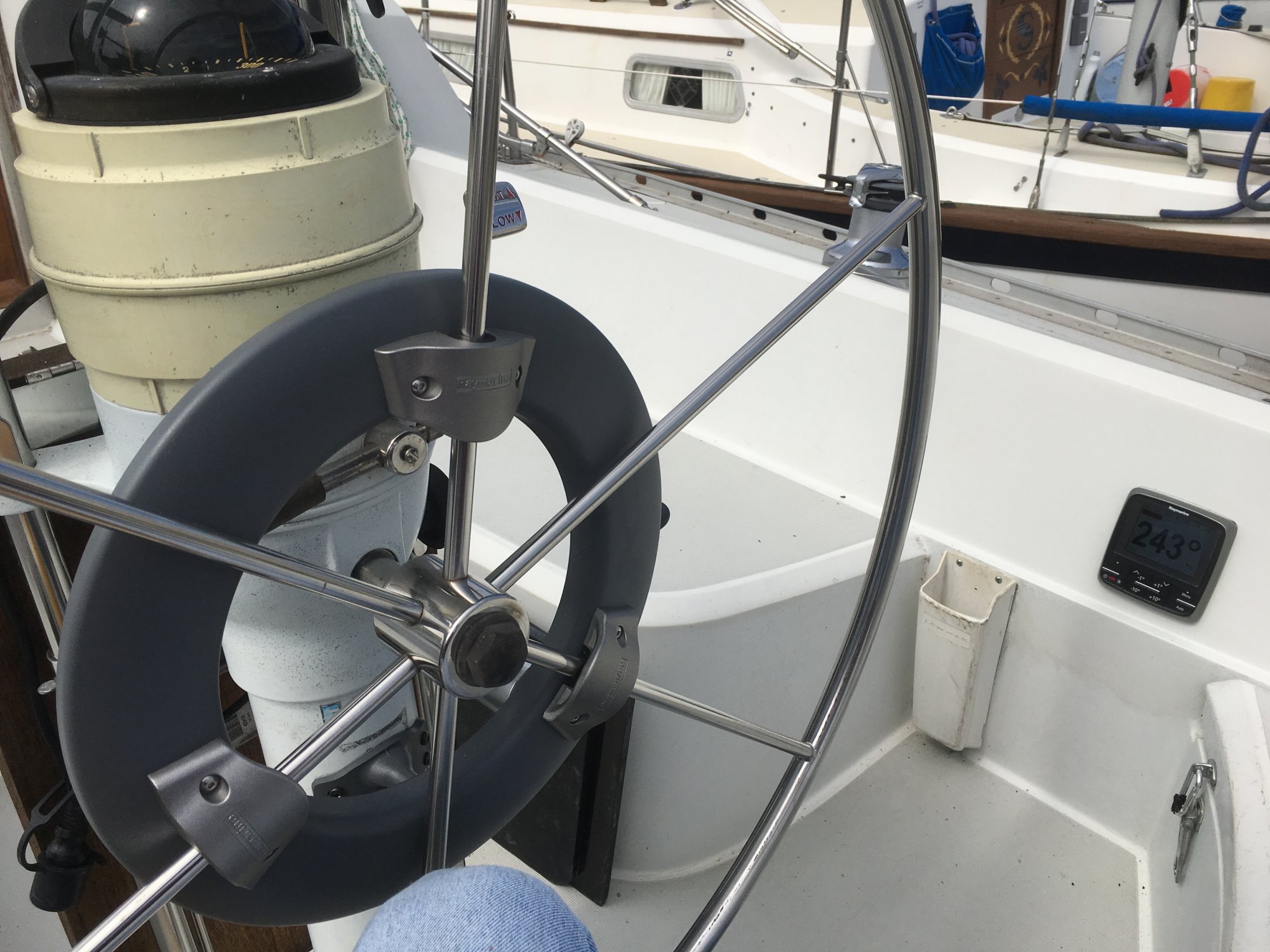

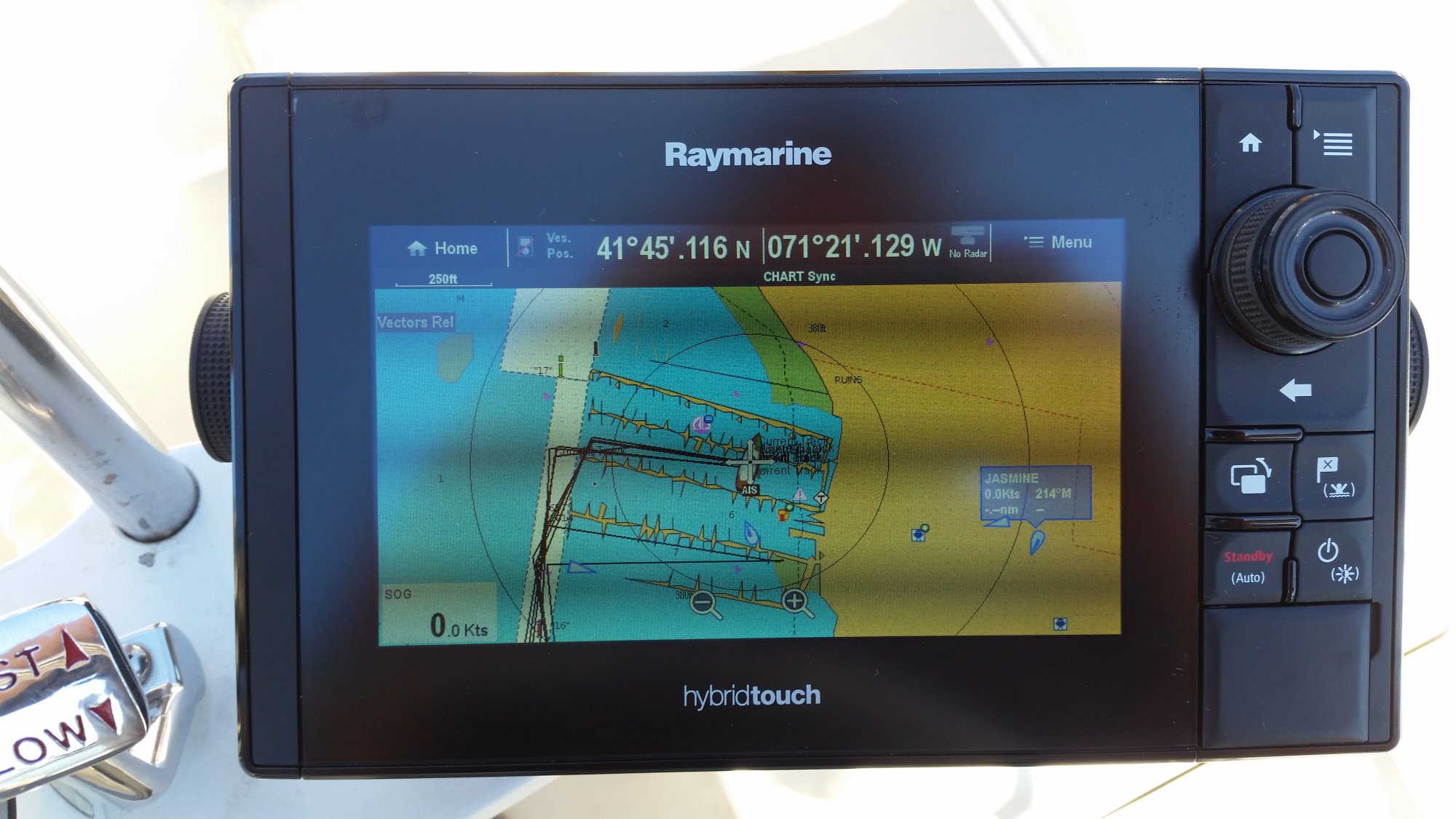

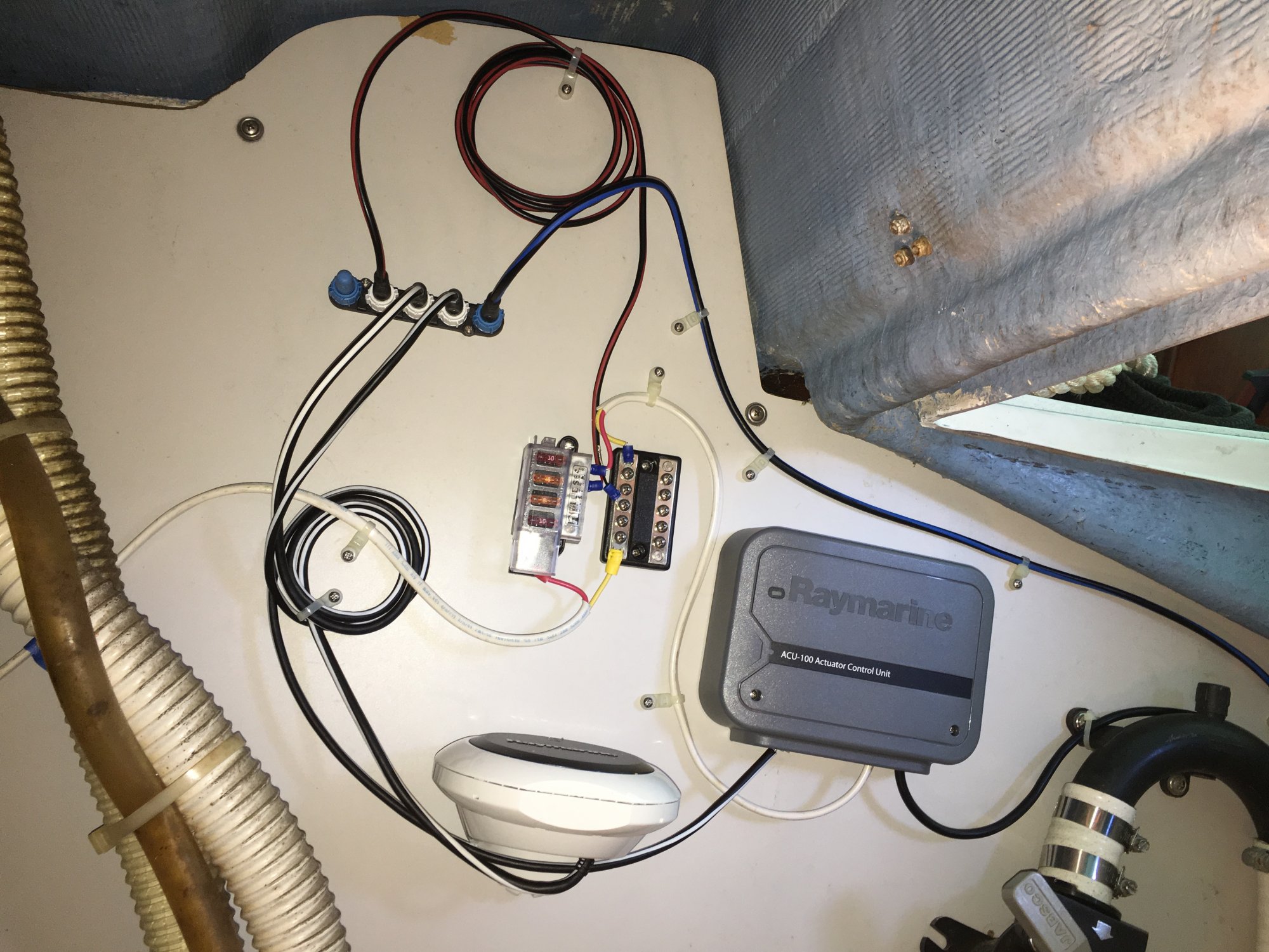

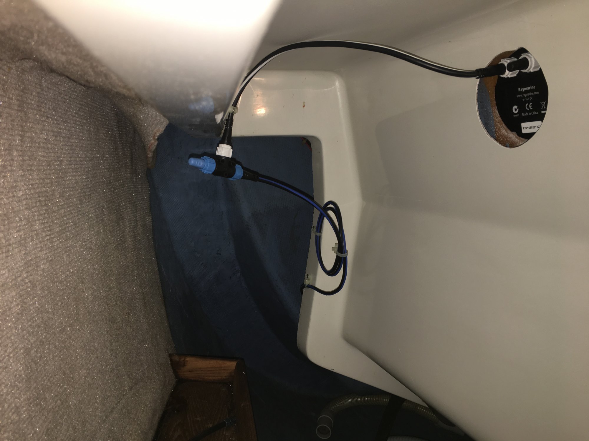

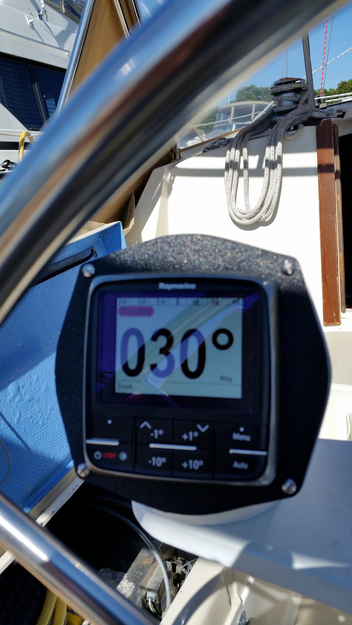

I have an EV-100 on my O'day 35 (11.5K lbs). I installed it in 2016, along with a suite of Raymarine products (eS78 chart plotter, R50 VHF) and a Vesper Marine AIS transceiver. It works great for me. However I do not use in in waves >3 feet, and almost never use it sailing (or motoring) with a following sea.
Pictures below show the control head, the installation of the heading sensor and the computer/drive controller in the aft quarterberth, and the Raymarine MFD that everything is networked with.

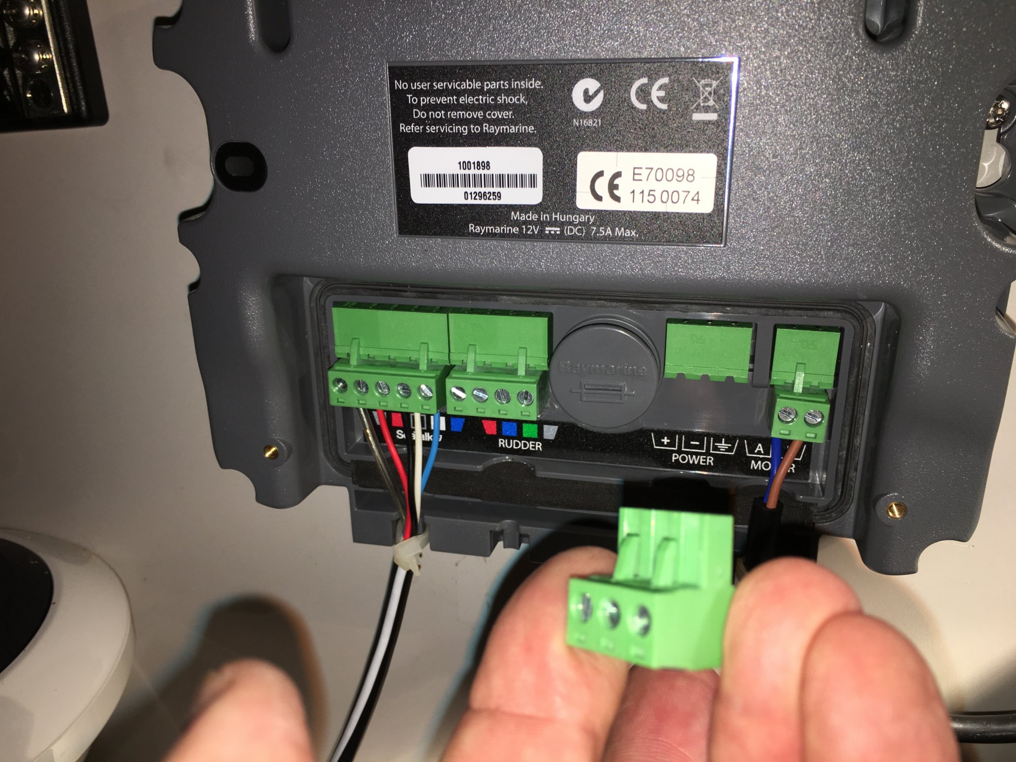

eherlihy provided good pics. On my 322 the sensor core/compass and actuator are mounted in the port lazerette up high so the wires don’t get caught up with fenders, hose, etc. this location made running wires to drive motor, head unit, and power relatively easy. Hardest part was making the raymarine version of nmea 2000 connectors work! Sheesh! There are easier nmea connectors out there.

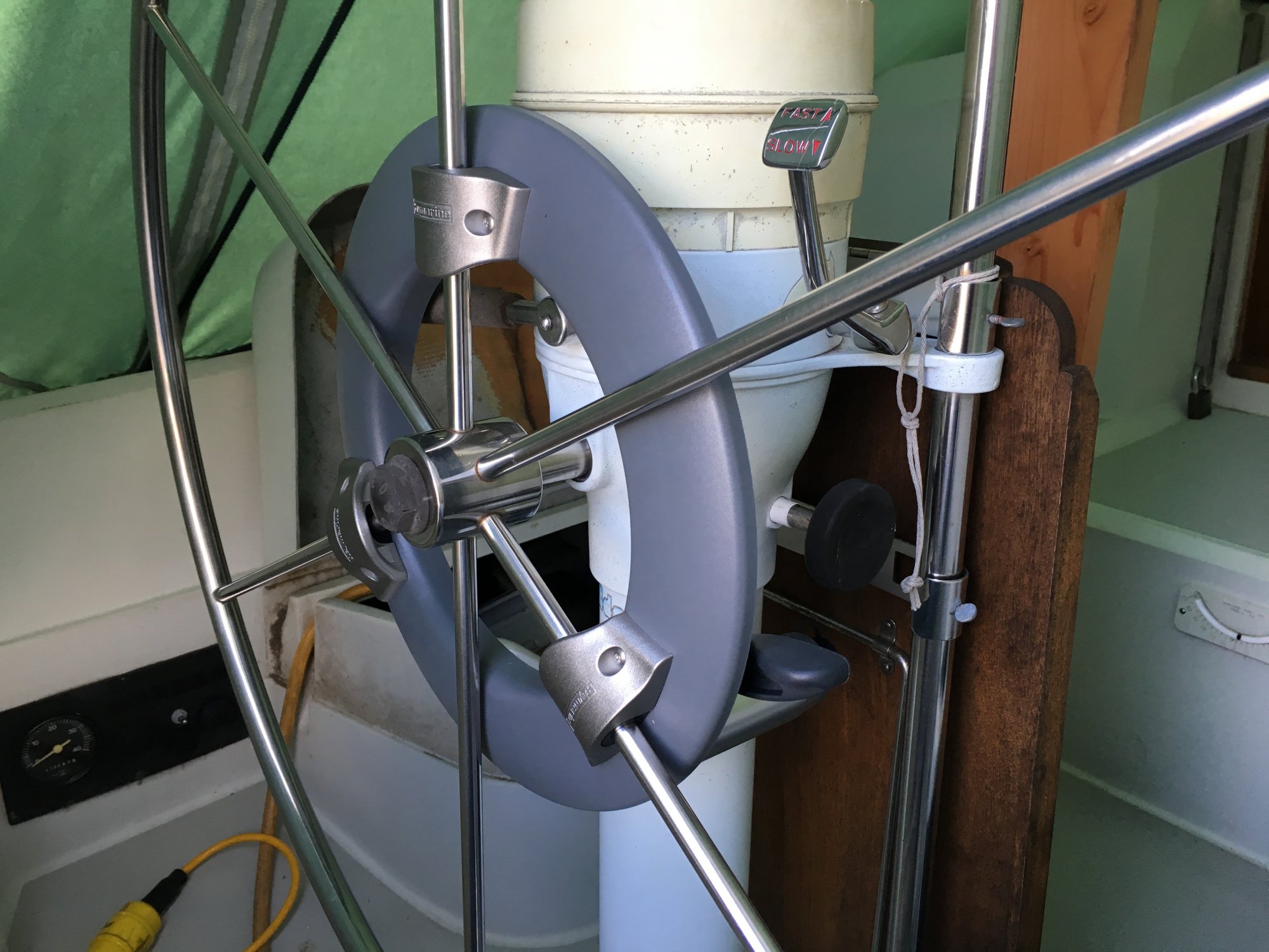

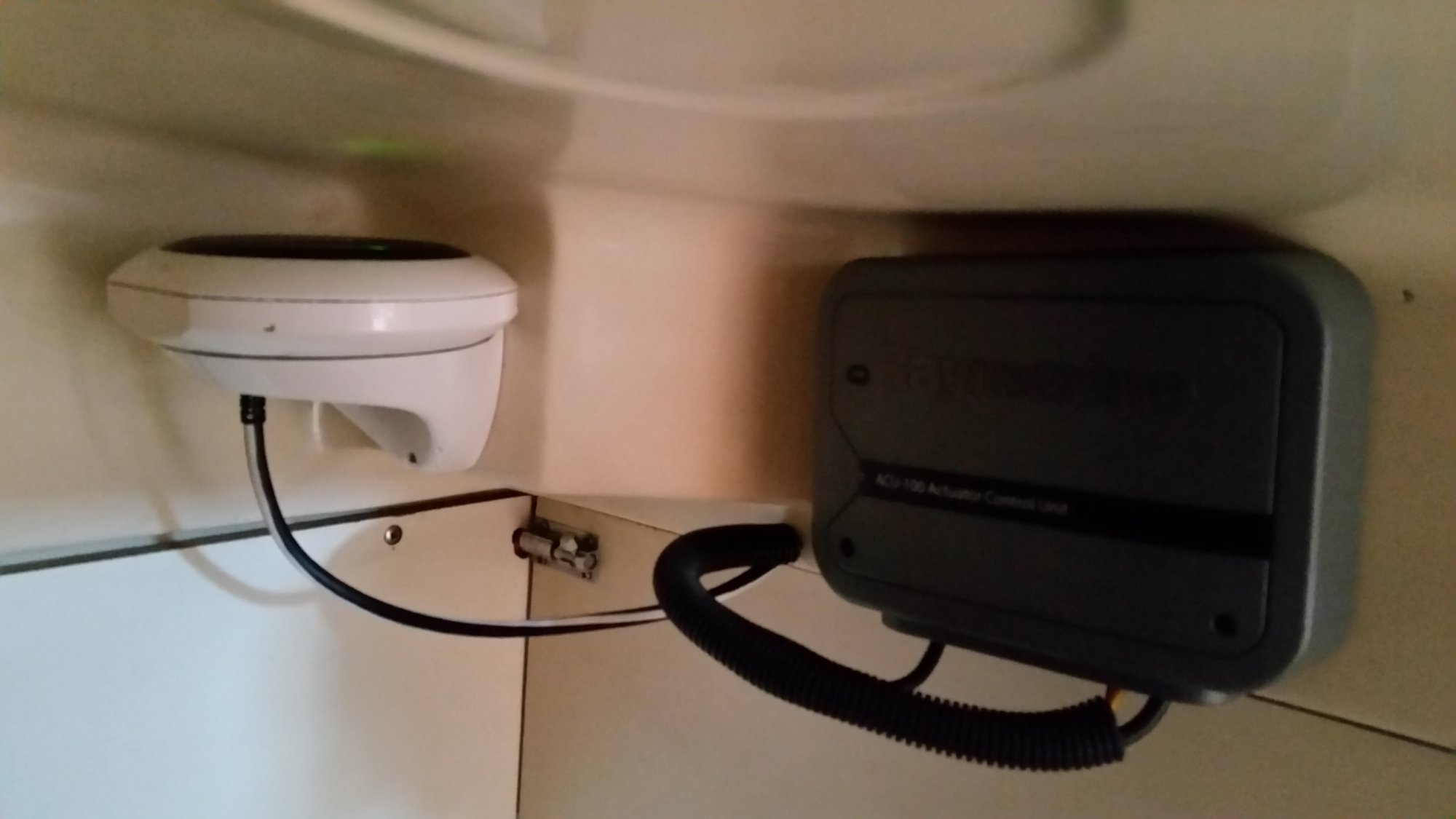

I also installed Raymarine EV100 wheel pilot a couple years ago. It integrates with the Raymarine Axiom chart plotter and the SeaTalk NMEA2000 network. I would not leave home without it. I single hand most of the time, it is great for moderate conditions. I use it 70 % of the time.
As others have said, fine attention to balancing the sails will make it the happiest. It holds a magnetic heading rock solid. It has AI to 'learn' as it works. It has multi-axis sensors in all three dimensions. I swear when it senses the boat heeling in a puff - it adds in some helm to compensate. My old Simrad WP-10 would barely hold within 10 degrees and certainly had no smarts.
It is not happy in a following sea broad reach. Also, in 'wind mode' (as opposed to magnetic heading mode) I found that keeping apparent wind angle upwind following my new Raymarine Wind vane (also NMEA2000 networked into the system) , it did not do well enough using the standard sensitivity settings. At the end of the season I was just playing with the 'racing' sensitivity setting it was better, did not get to study it enough before the season ended.

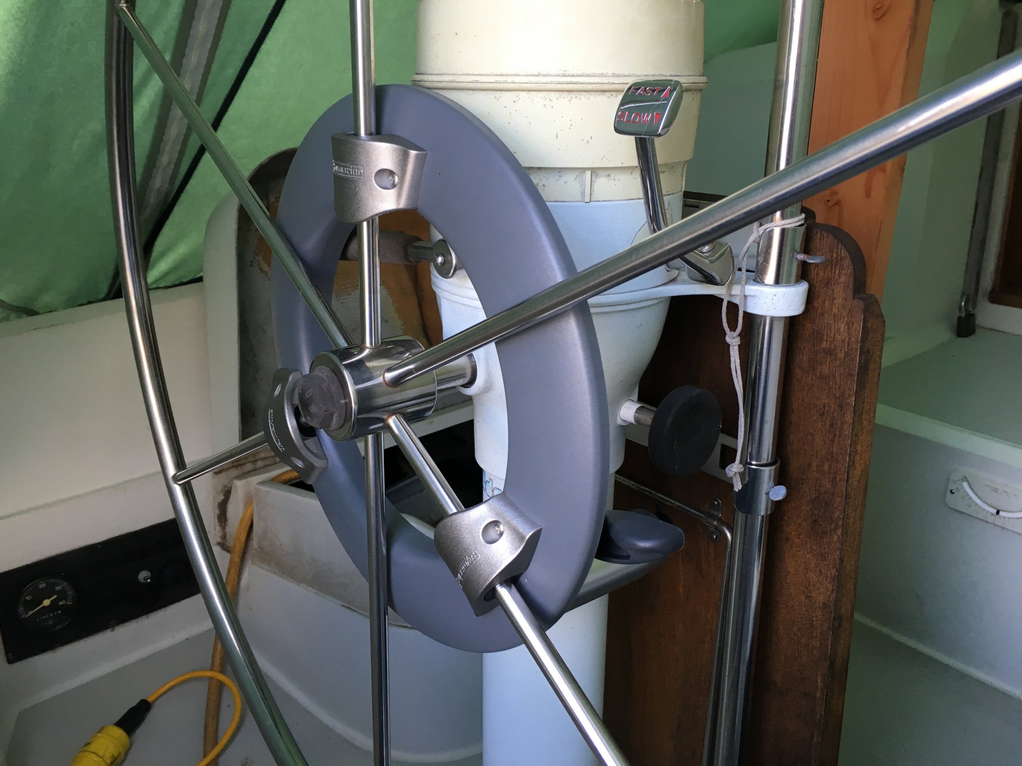

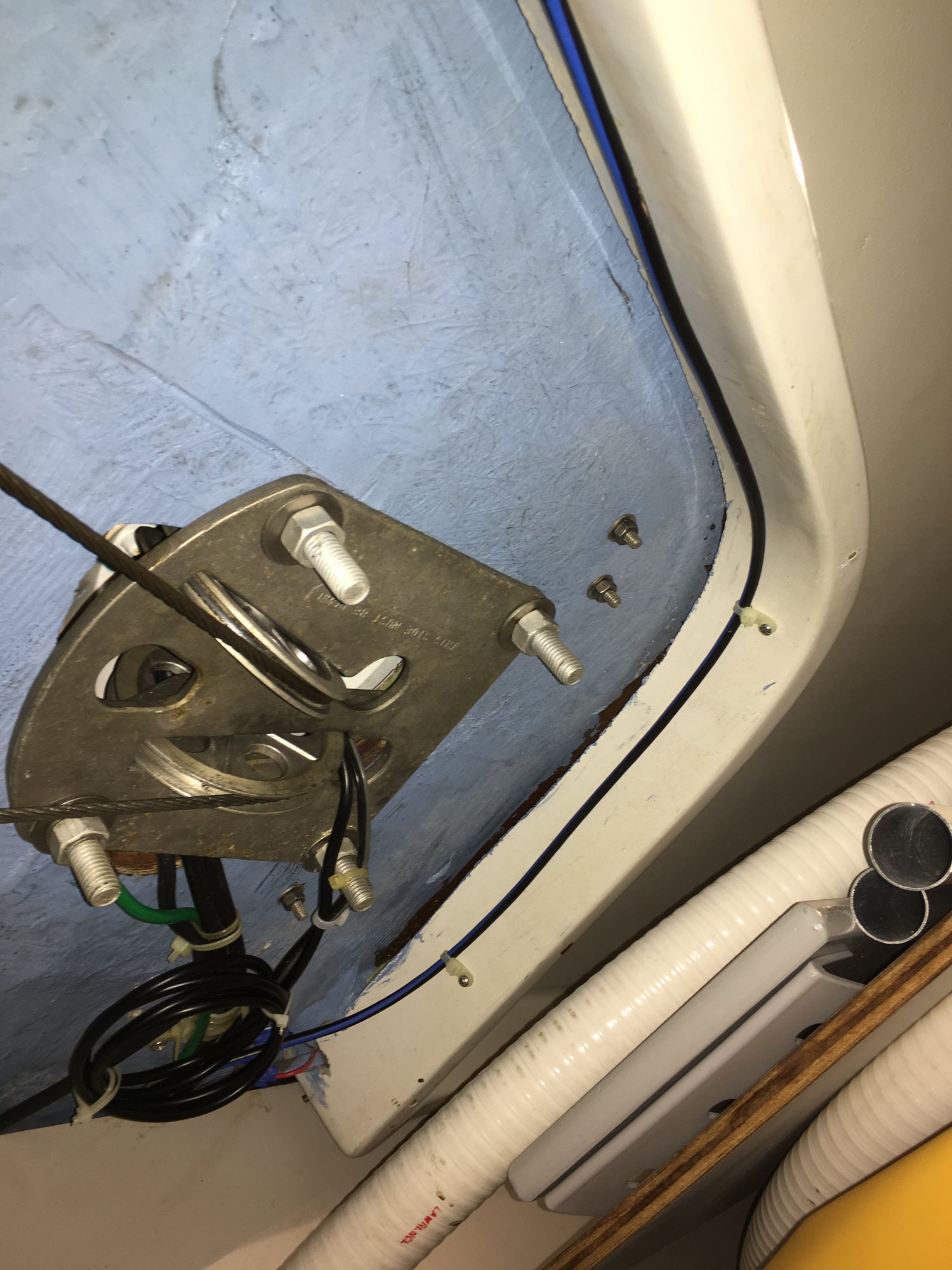

It's greatest value is all day trips down Delaware River or in the Chesapeake bay. it is the difference between arriving refreshed or tired. It is invaluable for long trips, and single handing. It is not a super strong wheel motor, but good enough for moderate conditions. Initial configuration and setup was super easy - basically turn it on and it works!
Installation was more than a half-day, more like two half-days by the time you thread wires all through the boat and binnacle. I installed the components high up on the port lazarette wall. See pictures.
