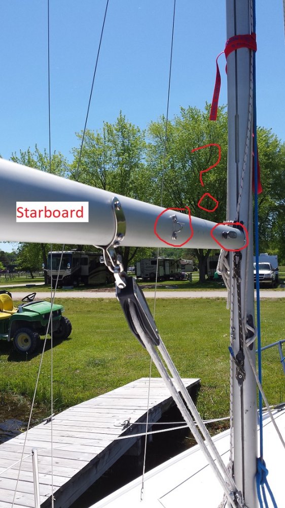

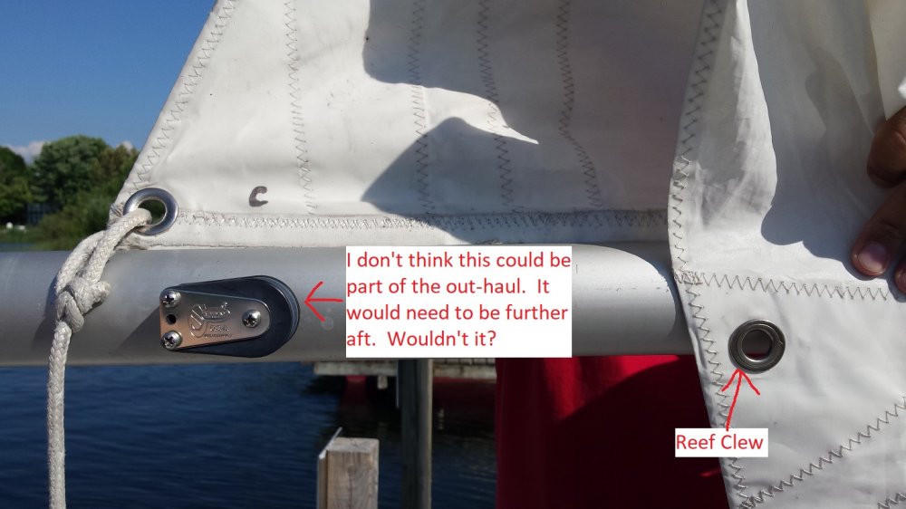

All of the ones on the boom that you have ? on are for your two line reefing system. One end of a small line attaches to the eye strap on the port side, then runs up through the reef clew on the sail, then down through the cheek block on the starbord side, forward through the eye strap, and ties off at the cleat. The eye strap in your last pic is also for the reefing system. There should be a cleat right across from it on the other side of the mast. One end of the line attaches to the eye, runs up through the reef tack on the sail, then down to the cleat.
@Jacomo Sailor I'm pretty sure you are correct. I did some googling of "two line reefing system", and for the most part it seems to match what I have. The only thing that does not line up is the extra cleat on the mast. There is a cleat on the other side of the mast but it "SEEMS" to be for the actual topping lift, which I think is used for the spinnaker. It look just like the spinnaker halyard, but it only goes up to a block about the height of the spreaders. The PO seems to have liked his spinnaker, so he may have stole that cleat for use with his spinnaker. There is an empty cleat at the base on the port side (same side as the eye) of the mast.
I'm mostly convinced you are correct. One other thing, in the inner 2 or 3 grommets there are 12" sections of line knotted on each side of the grommet, to tie in the reef. Seems like these would not be here if rigged for a "two line reefing system"? But what do I know. :what::what::what:

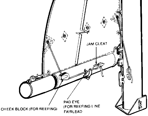

Based on this picture from Chip Ford's site, it does seem like what I have: http://www.chipford.com/graphics/Reefing_diagram.gif
However, then I'm back to not having any sort of out-haul at all. :banghead:
There is only one cleat on the boom. Doesn't the out-haul pretty much have to use that cleat?
Editted: It's not the main halyard across from the padeye. Added, image of reefing system.

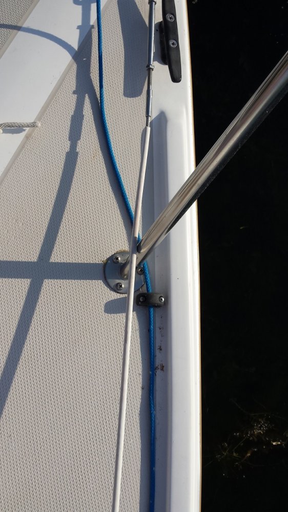

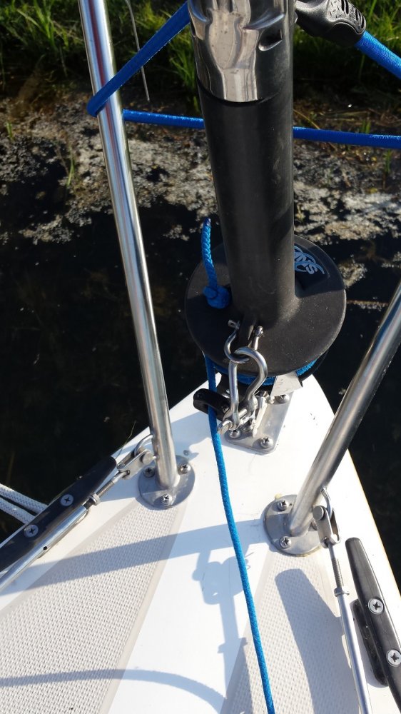

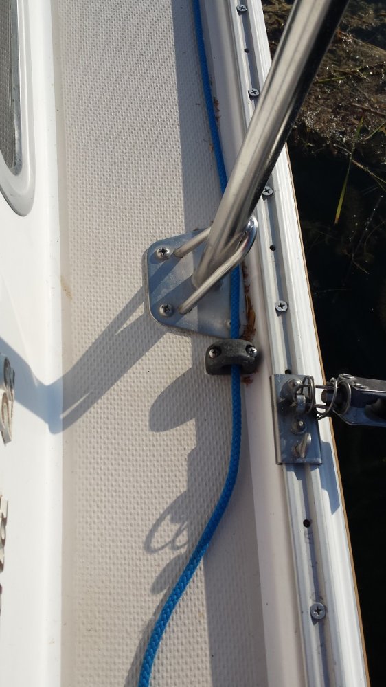

As long as we are trying to figure out this puzzle of rigging.
How does the routing of my furling line look?
20180611_140847.jpg 20180612_190314.jpg 20180612_190336.jpg 20180612_190448.jpg 20180612_190451.jpg 20180612_190455.jpg

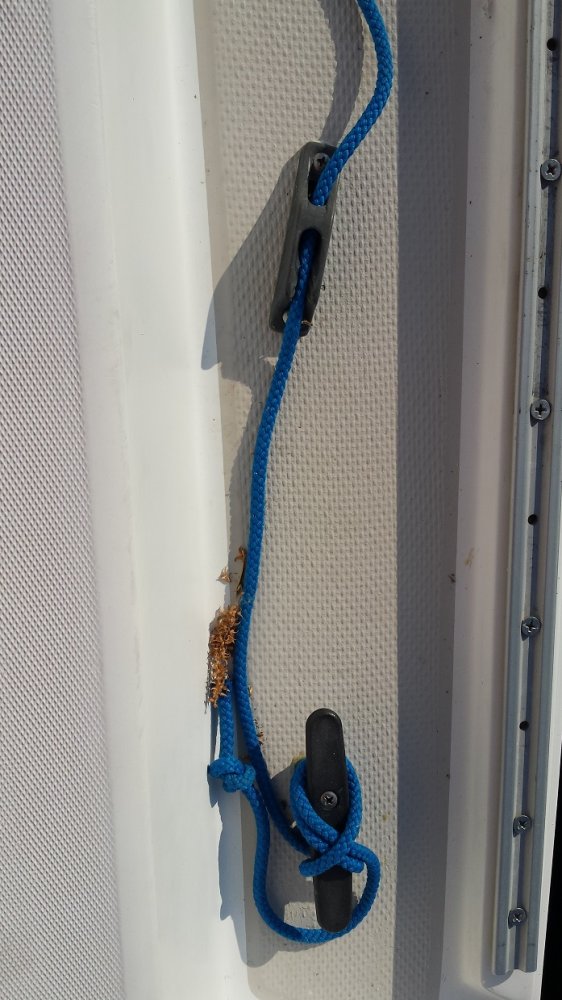

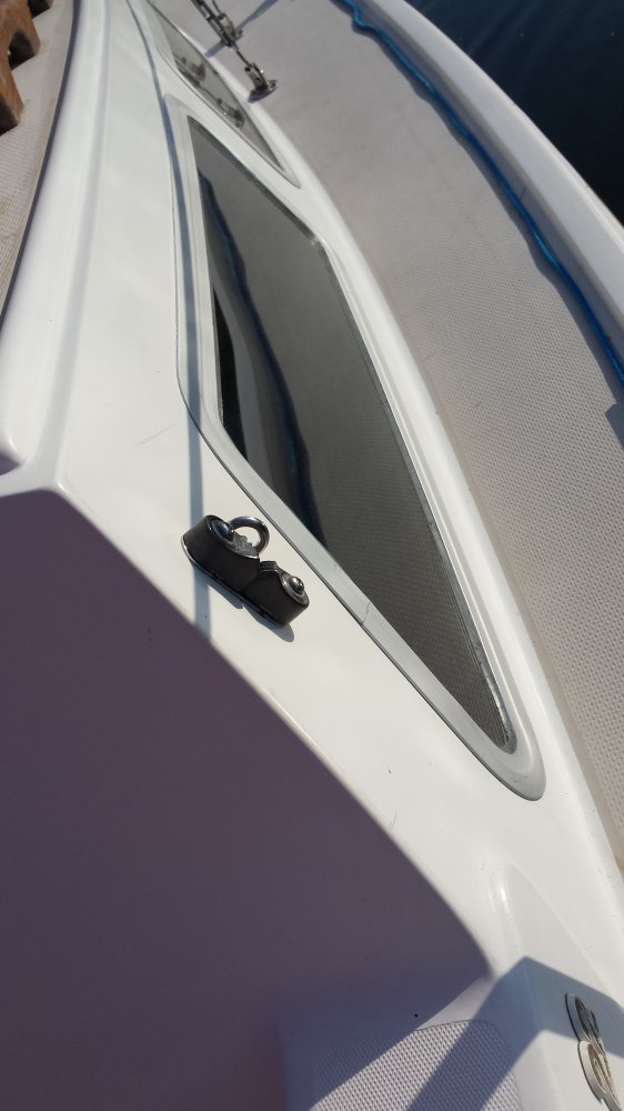

What could these be for? They are mounted to the starboard side of the cabin house. What would you do with these?

I don't think an outhaul is 'stock'. My boom sure doesn't have any provisions for one. The only hardware on the boom is the reefing cheekblock and a pad-eye on the opposite side, and then a fairlead clam cleat down forward of the block. The short lines are for tying up the slack sail when you're reefed, and they don't do anything to really secure the sail to the boom.

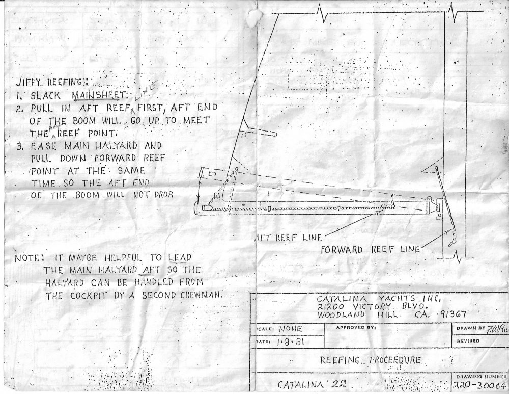

Well, I'm going to call this mystery solved. I believe @Jacomo Sailor & @Voiding Sounds are correct. My boat does not have an out haul. Well, except this:
Which I'm pretty sure the PO did use after looking at the line.
And the check block on my boom is for reefing. So, since my Jiffy Reefing line is missing what type of line should be used to rig the reefing lines? Any suggestions?
@Siren handed me this very old piece of paper a few minutes ago.
Thanks for the help everyone.

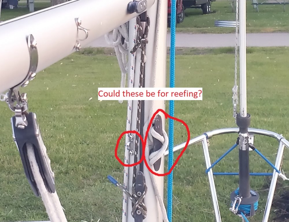

I'm still curious what the cam on the side of the cabin (2nd part of post #23) is for?

I'm re-rigging my boom right now (and adding an 2:1 outhaul like Stingy's latest) and I'm going to be using 1/4" double/yacht braid for my reef lines.
I'm not 100% but I would guess the fairlead and cam cleat are for a jib downhaul, just inboard instead of along the stanchions like a lot of setups. Probably vestigial though since you've got a furler.

+1 on that cam cleat probably being part of an old jib downhaul.

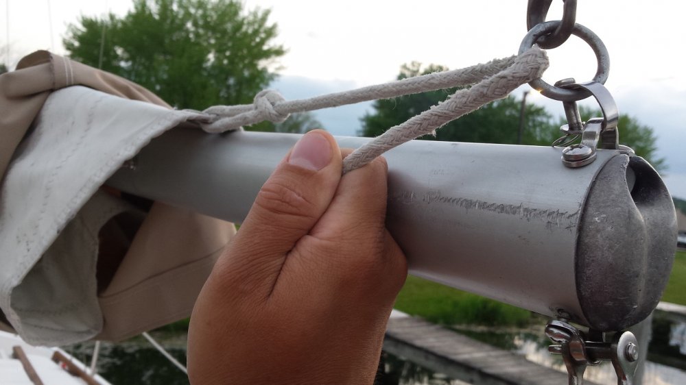

If I understand you correctly, those are just sail ties, which tie up the baggy excess canvas created when you reef the sail.
Would that be robust enough for running the main halyard to the cockpit? I would have to add a block at the base of the mast at a minimum. Or would that need something much more substantial?
Yes, that was what I figured, as we did use them when we put in a reef on a friend's boat. I guess I'm just taking issue with the word Jiffy, maybe I just thought there would be less to it than 2 cleats and 3 sail ties. :soapbox: :biggrin: :deadhorse:

That cam cleat is probably sufficient in terms of strength for your halyards (assuming it is sized for 3/8" line), but the location is all wrong. If your halyard is on the mast you'll need at least a pair of blocks, one like you said at the base of the mast, and a second to turn the line down towards the bulkhead where the cleat would go.
