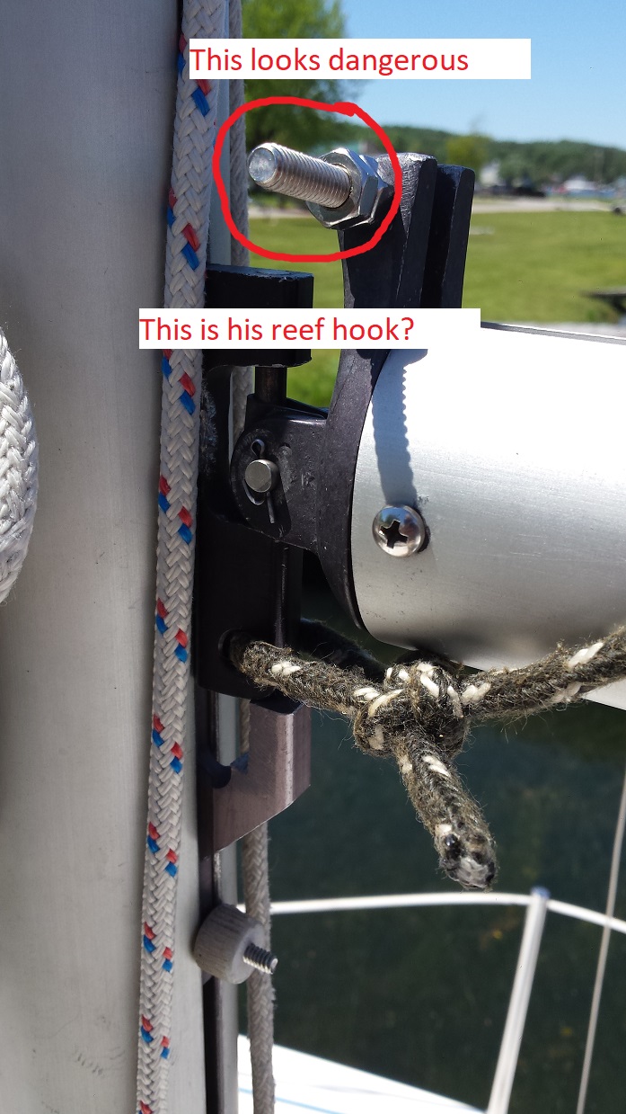

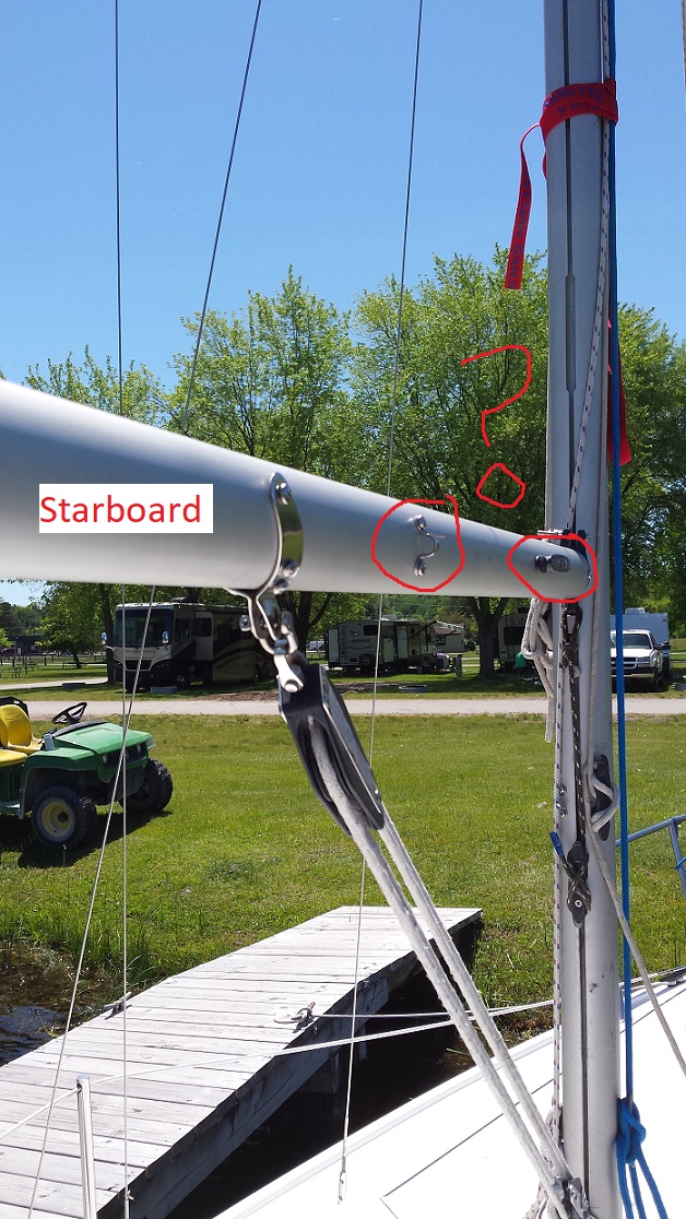

So yesterday I attached the boom to the mast and began to rig the boat based more on logical guesses than anything else (I also read a bunch of threads with the word boom in them). I think I have most things done right, but a few questions popped up. If you notice anything done incorrectly or unsafe please let me know.
First I slid the goose neck into the sail track.
I just don't think the stop looks right? It seems very specifically designed, and just doesn't seem to match up with the goose neck. In the second photo the bolt looks dangerous.

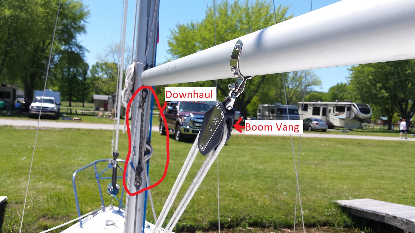

I tied off the down haul to the cleat. Attached the boom vang.

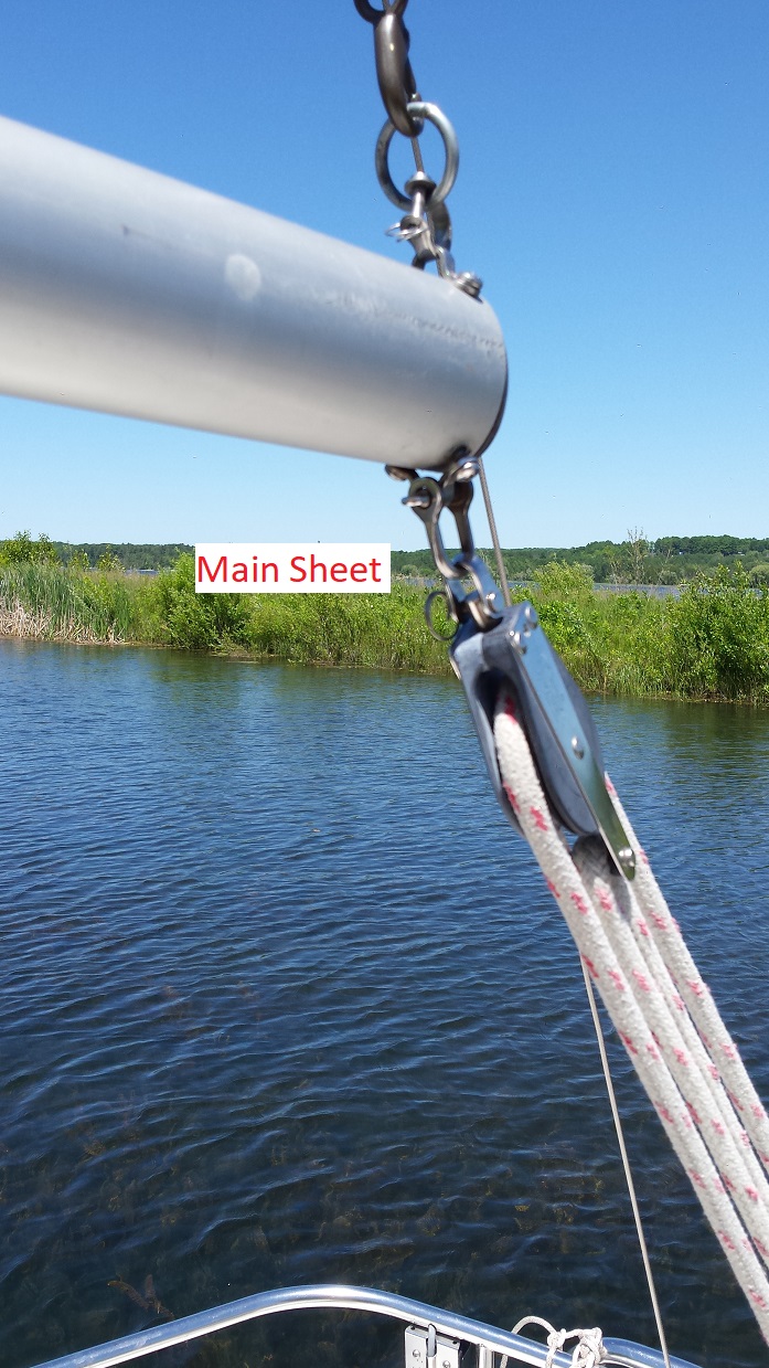

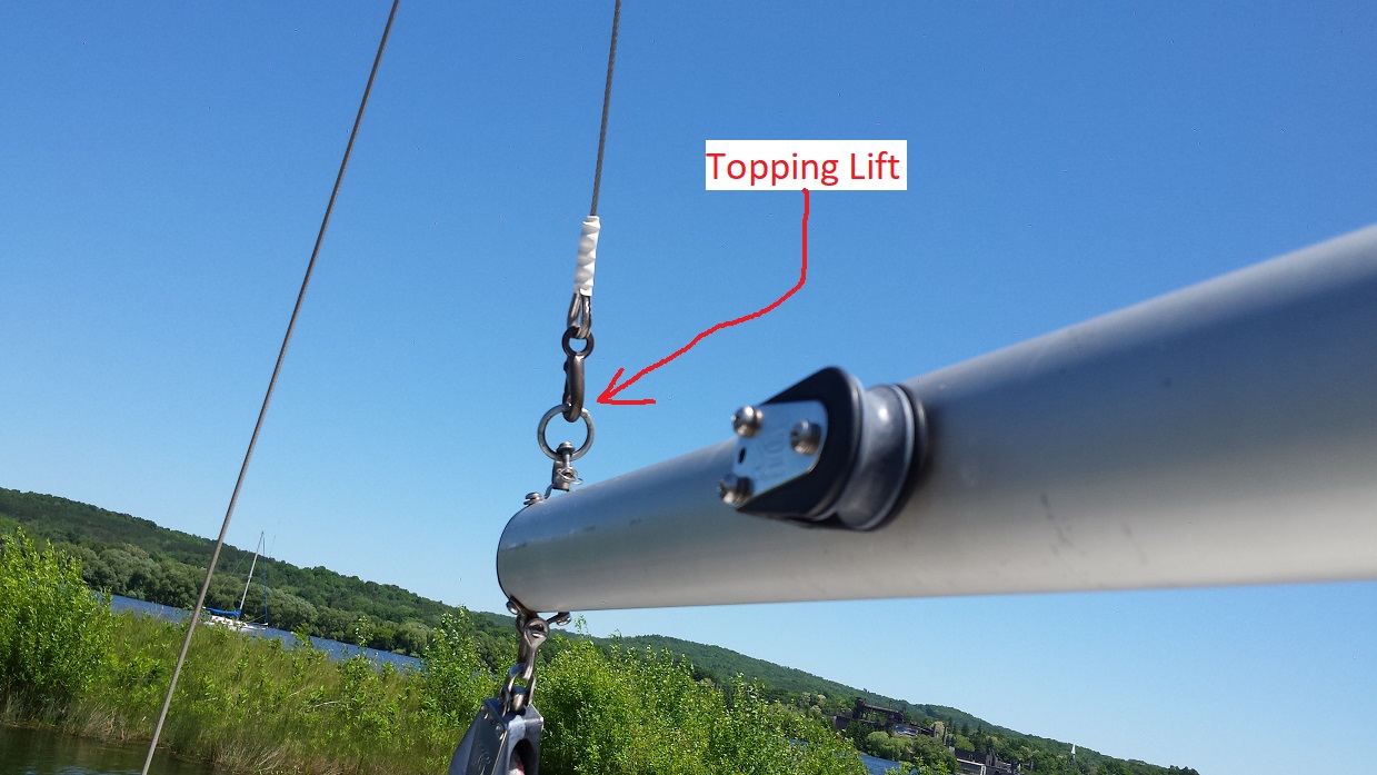

I added the main sheet. Put on the topping lift. Although this is not like a topping lift on other boats I've sailed on. It's just a cable with a clip, functional and simple.

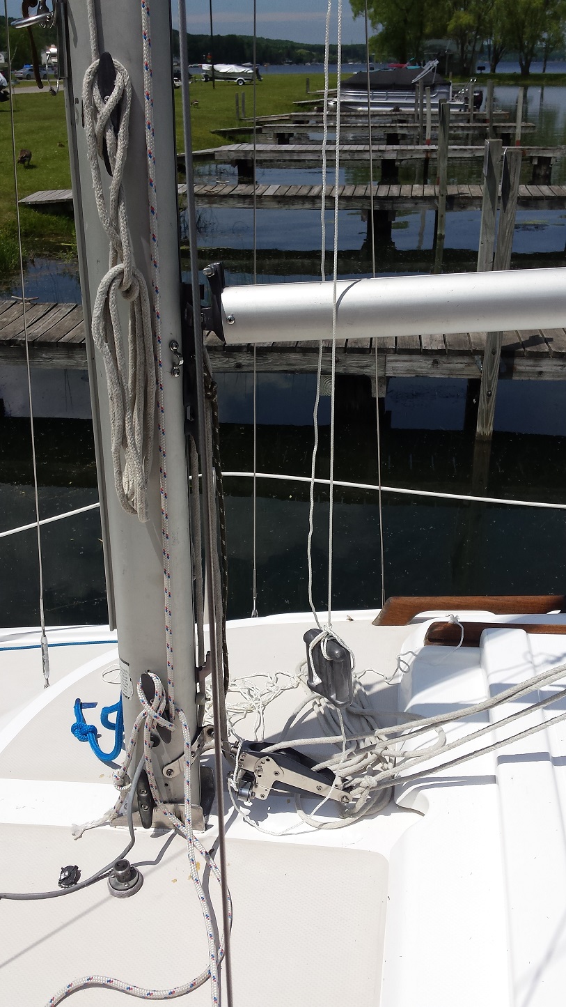

Then I tried to figure out what I think is the outhaul. Maybe it will make more sense when the main is on but it seems like the block is facing the wrong way. Seems like the line would run from the rear of the sail aft to the block, turn and run forward though the chrome loop thingie and tie off to the cleat. But then why is there another chrome loop on the other side of the boom?

First pic is the pop top lock. Once you raise the top, you slide this up and it locks it to the mast. When not in use this is normally positioned much farther down. Second looks homemade, must have lost the pin that threads in. The one that says topping lift is actually the pigtail. This is used to keep the boom centered and hold up the aft end when the sail is down. A topping lift is different and not fixed to the backstay. The pigtail MUST be unhooked the second you raise your main. All of the ones on the boom that you have ? on are for your two line reefing system. One end of a small line attaches to the eye strap on the port side, then runs up through the reef clew on the sail, then down through the cheek block on the starbord side, forward through the eye strap, and ties off at the cleat. The eye strap in your last pic is also for the reefing system. There should be a cleat right across from it on the other side of the mast. One end of the line attaches to the eye, runs up through the reef tack on the sail, then down to the cleat.
Jul 13, 2015
900
Catalina 22 #2552 2252 Kennewick, WA
I'm guessing as I have the early non pop top model-- but I believe that sail stop is designed to augment and/or hold up your pop top lid. All you need there is the standard "button" stop to keep your boom from dropping below your set height.
Your PO lost the main bolt-- and added their own-- check out Catalina direct for a factory replacement. You definitely don't want the snag hazard for skin or sails.
And likely your starboard aft cheek block on the mast is outhaul-- my main has a lead line that wraps that block and finds a mechanical jam cleat that keep the foot taught.
Pad eyes at the mast and the boom could be anything -- really depends on various systems that may or may not have been deployed on your boat. Boom pad eye could be for a secondary snap block to be used when your main is reefed? Guessing a bit, but you may stumble on it as you try every conceivable variation on a theme with your setup.
Nice pics-- looks like you're having fun.
Ok, well that answers another question, "how do I get the pop top to stay up?" :banghead: You just made my first mate super happy. :dancing:
The pigtail makes perfect sense to me. But, then how do I keep the forward end of the mast up and level when the sails are down. If the aft end is held by the pigtail, the foward end will fall all the way down to the down haul cleat???
I'd bet that you want to raise the forward end of the boom up to clear the pop-top when the sails are down. You'd make the adjustment in height and then set the stopper. The boom doesn't need to be level when your sails are down … just out of the way.

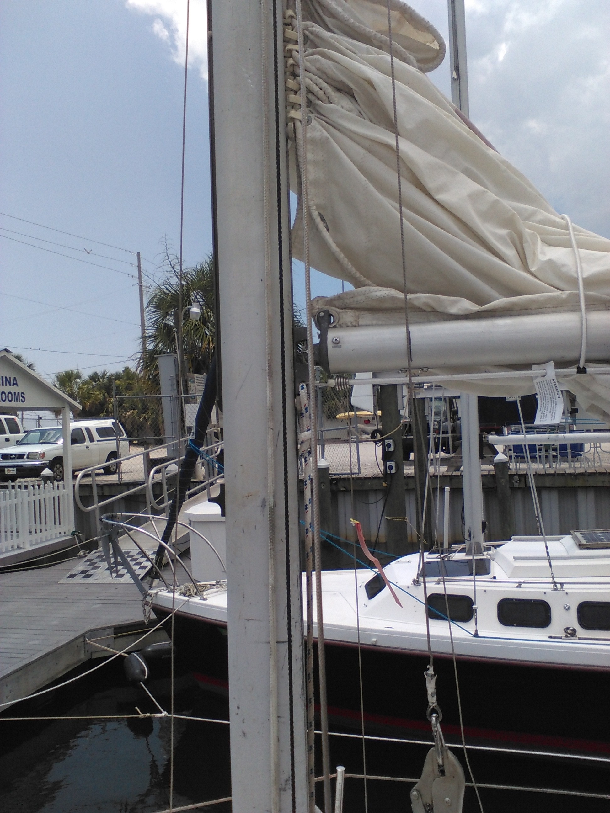

Sep 14, 2014
1,252
Catalina 22 Pensacola, Florida
Get two sail track stops and they will solve the mast gate problem by keeping sail slugs above the gate, and the other will support the boom when sail is down and pigtail disconnected. Hoist the sail, lower the sail track below the gooseneck and tighten the downhaul to tighten the sail along the mast. A topping lift to support the boom is a good idea too. See pix below.
Wouldn't work well for me. If my main is hoisted like in your photo, there would be a slug sitting where the gate is, and my sail cover wouldn't fit with that gap between the sail and boom when furled. I'd need to install a jack line so I could easily reef.

When furled the boom goes back up just under the gate and sail cover fits just fine. See pix

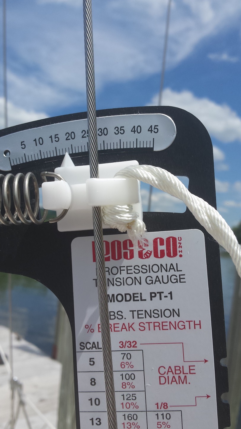

This afternoon I decided to tune my standing rigging. Using my new tool, which cost about a boat buck, it went pretty well.
https://loosnaples.com/how-to-use-pt-series-tension-gauges
When I started, everything was sloppy loose.
First I marked my boom at 6 and 7 inches aft of the mast. Then I tied a line with a 3# weight to the main halyard and tied it off so it was a foot or so above the deck, allowing it to swing and not break anything. Standing on the dock I had 6" of rake. :waycool:
Then I started with the upper shrouds. Both were about 10, so I worked 3 turns on each side until I got to 16, then one turn at a time until I got to 19, then half or quarter turns. Finally each side read 21. :)
Then on to the forward lowers, both sides barely read on the gauge. So, again 3 turns until I got to 14, then one turn each until 17, then half/quarter turns to 18.5 - 19.
Repeat with the aft lowers, until I got to 18.

I ended up with uppers at 21, forward lowers at 19, aft lowers at 17.5.
I tried to double check my rake but the winds picked up at lot. In the few lulls it looked like about 6" of rake at the boom, which I hiked up to 36" above the tabernacle(?). About 1 1/2" to 2" of rake at the spreaders. :clap::clap::clap: :beer:
I think, this is pretty close to what is recommended based on all the threads I read, and the North Sails guide I read.
