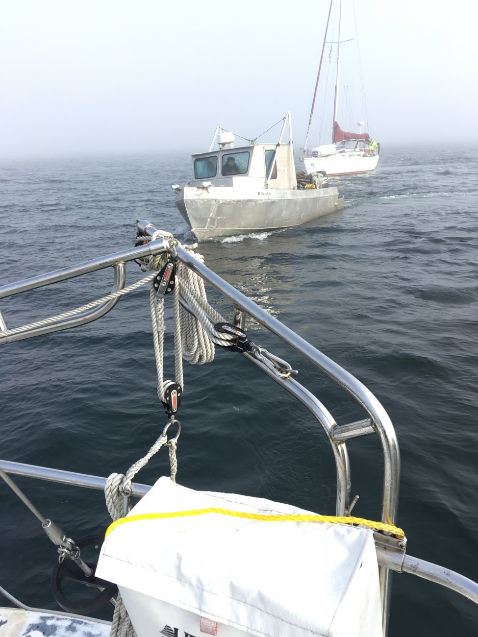

it was odd how many aluminum fishing boats would appear out of the fog, visually, that were not on screen (or were so intermittent that it was hard to ID them as a firm target.
I know that experience. This one came out of the fog speeding to the fishing ground doing 30 something. Visibility was about 50-70 yards.
That is @LeslieTroyer in Mahalo guiding the fisherman back to my boat. I was dead in the water after getting hit.
I think the angles when he was bow on served to minimize his radar reflection. He was not seen on our combined radars. Only visual observation helped to mitigate a catastrophic collision.

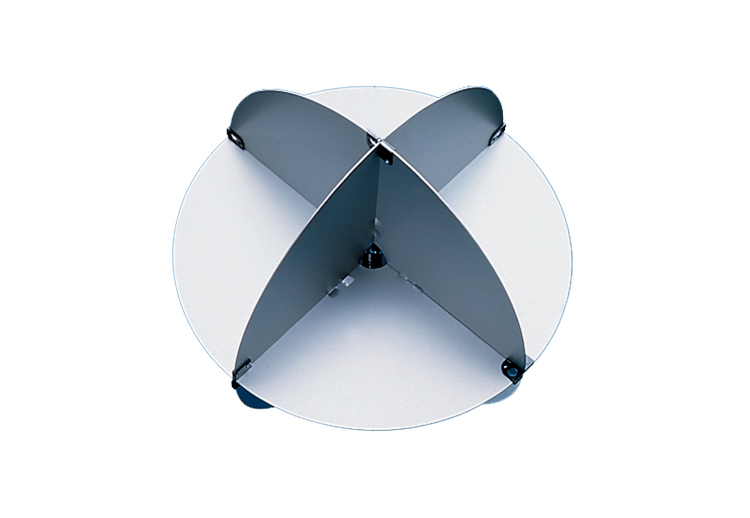

Working on the boat today I found this unassembled in the port lazerette.
I was curious about mounting and found this post. These things have sharp edges. The backstay will keep it away from the sails but I don't know about you but my topping lift sometimes wraps around my backstay. My mast is on saw horses so mounting it should be easy. Might as well use it.
23,845
Bob, that one is not intended for the back stay.
The backstay on has a cut in it so that it attaches flat against the stay.
see the hole in the center.
I have attached the instructions manual for your review.
