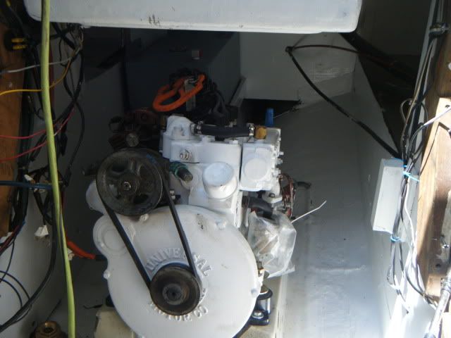

I have FWC and used the new Moyer water pump ,electronic ignition, intake valves ,valve springs ,thermostat and all new electric and fuel system

Very sanitary! I like the clean white...

While i believe Mainsail about selling time my boat surveyed above the value of diesel powered Cal 29s when it was finished
If you look at how my boat was before i did the refit it is now wonder the A4 gets a bad name
NOT that a diesel would have faired any better in those conditions and i think given how bad the fuel was the diesel would have had much more dammage to the fuel system

Tommays, that is some exceptional nice work you did.
