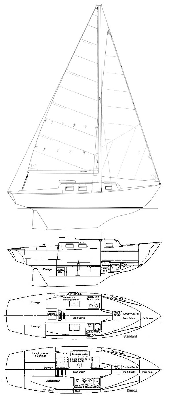

According to the image of the Bristol from Sailboat Data shows the boat as a mast head rig. As I understandare going to need to add the Spinnaker to the mast head.
Because the forestay is at the mast head you will want to add your rig on a crane. That will get the gear out in front of the mast.

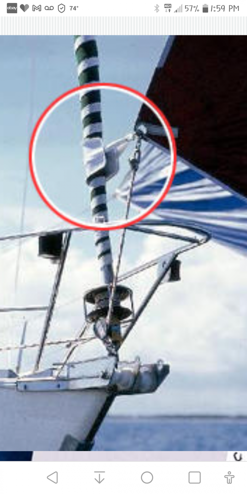

Hi soon sailing. What you have the red circle around is a tacker or tacking assister.

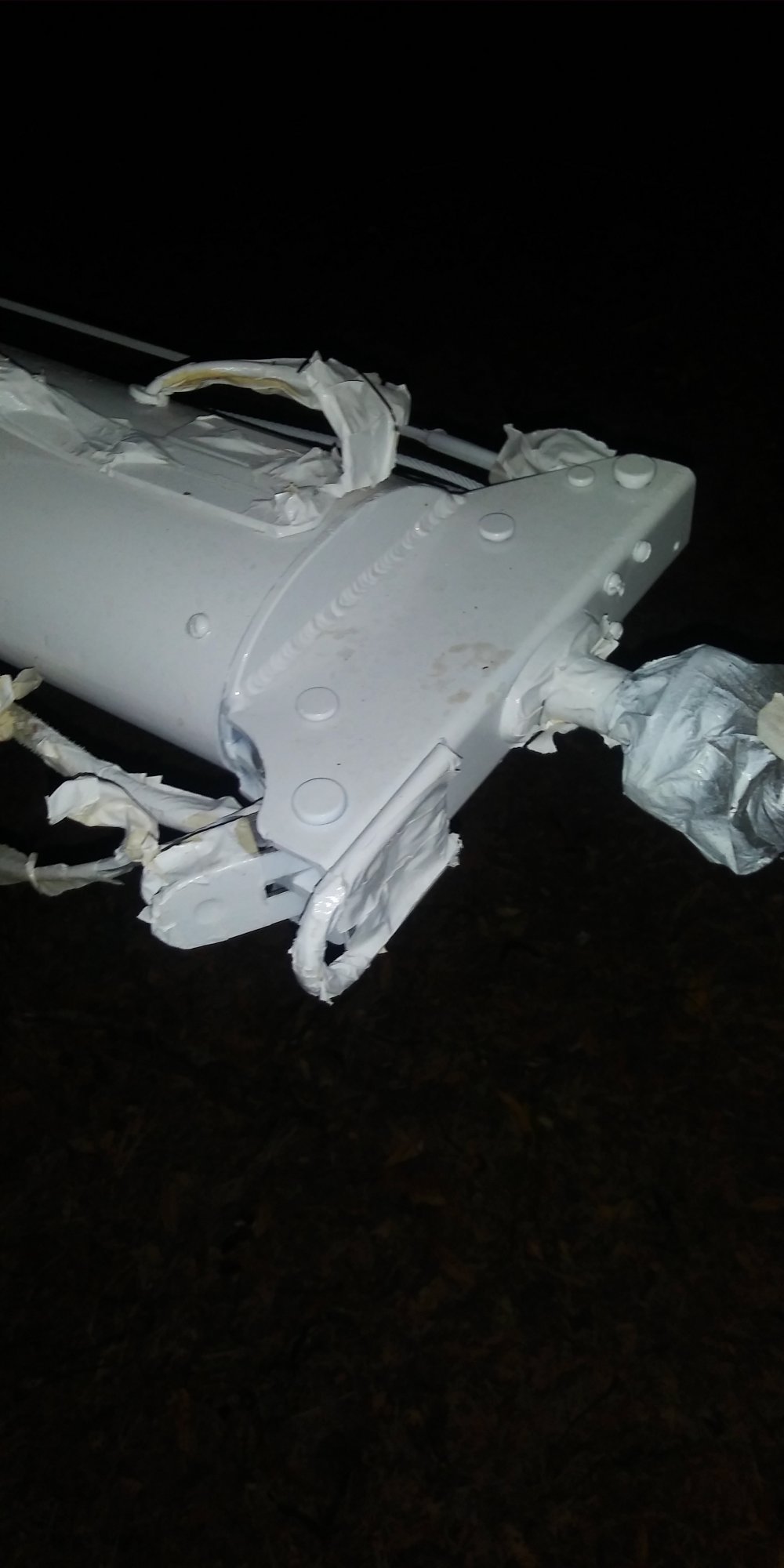

A crane is a part of the masthead or a masthead attachment which locates the spinnaker block forward of everything up at the top of the mast.
In the first pic you can see (from the bottom)
a. the blue flec foresail halyard.
b, the shackle for the forestay
c. the spinnaker halyard block shackled to the crane.
Here is another pic showing the foresail halyard lower than the crane.
You can buy aftermarket cranes and fit to the masthead. Probably available here at SBO.
If your spinnaker halyard block is below the foresail halyard and forestay you can end up with all sorts of drama way up at the top of the mast. especially if you have a spinnaker sock up there.

hi... is that u shape metal "the crown" on the left of the head?
and thanks for caring and taking from your time to answer this
24,707
Not “ the crown”. It is a “crane”.
You attach the block to the crane. Then run the halyard through the block.
