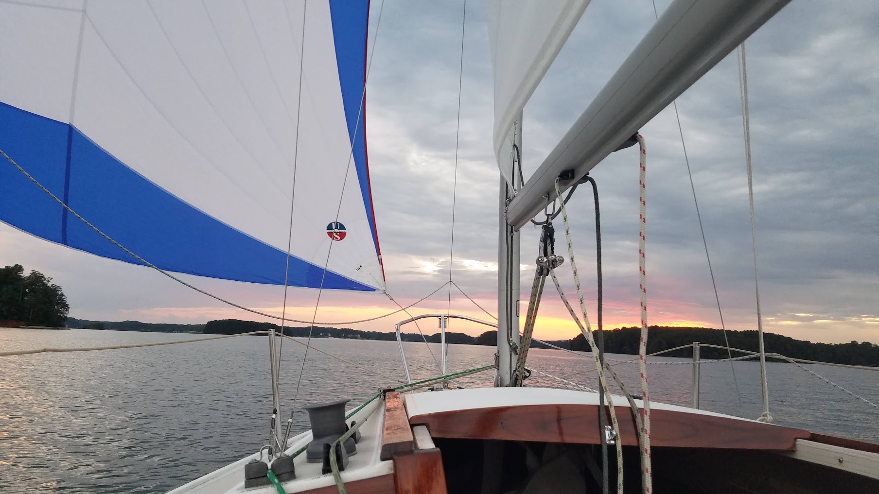

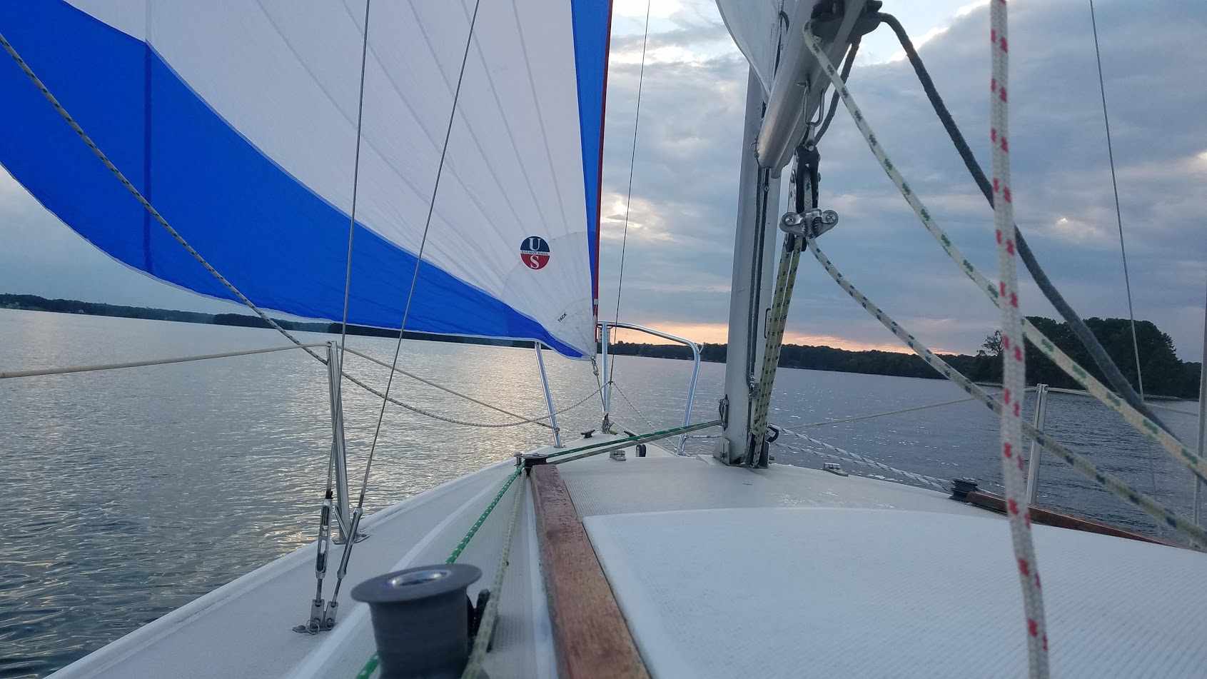

I just bought an ATN Tacker and tried it with my symmetrical. It works!!! I have a furling 135 genoa though.
I tried it both cruising and racing: Not very practical for racing and I will go back to flying my symmetrical on a pole for racing but great for cruising and we were able to handle it with just 2 people on the boat.
