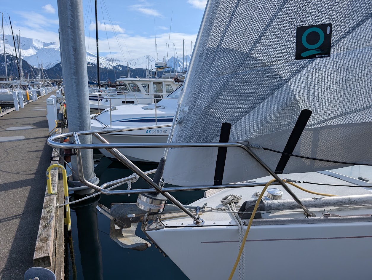

My wife and I sail an Express 34 in Alaska. Great boat, we absolutely love it, and race it 5-6x per summer up here. Folks who are familiar with the design will know that we run a symmetrical spinnaker.
This offseason we decided to experiment with an *asymmetrical* spinnaker as well. The goal is to have a big headsail that can point a bit higher than the symmetrical (we tend to lose on reaching legs) and be a bit easier to run than the symmetrical, which really requires a full crew. We got an A5, and I'm pretty excited about it.

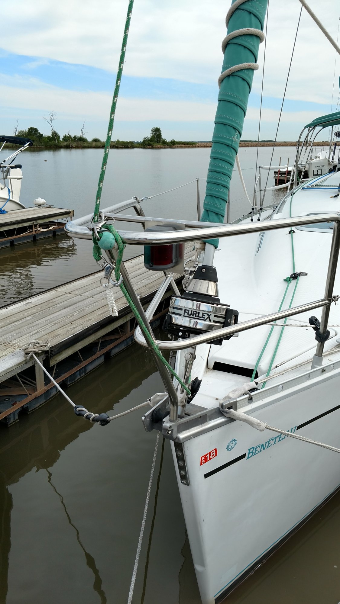

That said, the "wind was taken out of my sails" when I realized we don't have a convenient location to tack it. See attached pictures - the only sensible anchor is literally right under the roller furler:
So - what does the community recommend here? I know some people use the anchor roller with zero issues, and it's pretty beefy... but definitely designed to pull from below (not above or sideways). I read some boats have had devastating failures from doing this.
Another option would be to go to the correct, reinforced tack point, but then the tack line would be pulling against the roller furler in one direction or another. Not ideal either.
I'm sure using the bowsprit would be a disaster waiting to happen so not even going to go there.
Is there some kind of loop or bridle folks can envision? How would other racers handle this?
Thank you!!!

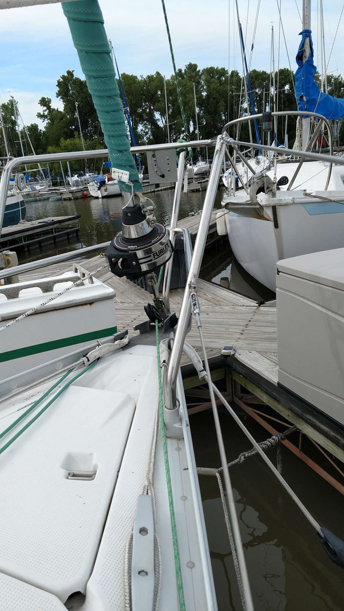

Acquire an ATN Tacker.. It wraps around the furled headsail and is designed to slide or down to change the attack point. WM has them for $177.00. Might be less or more at other sellers.. With a quick release shackle on the tacker, you can sheet in the leeward sheet and pop the release, then douse with the sock and set the Genoa ...
23,843
The ATN tacker is a good solution. I use it on my boat.
It is rigged like this.

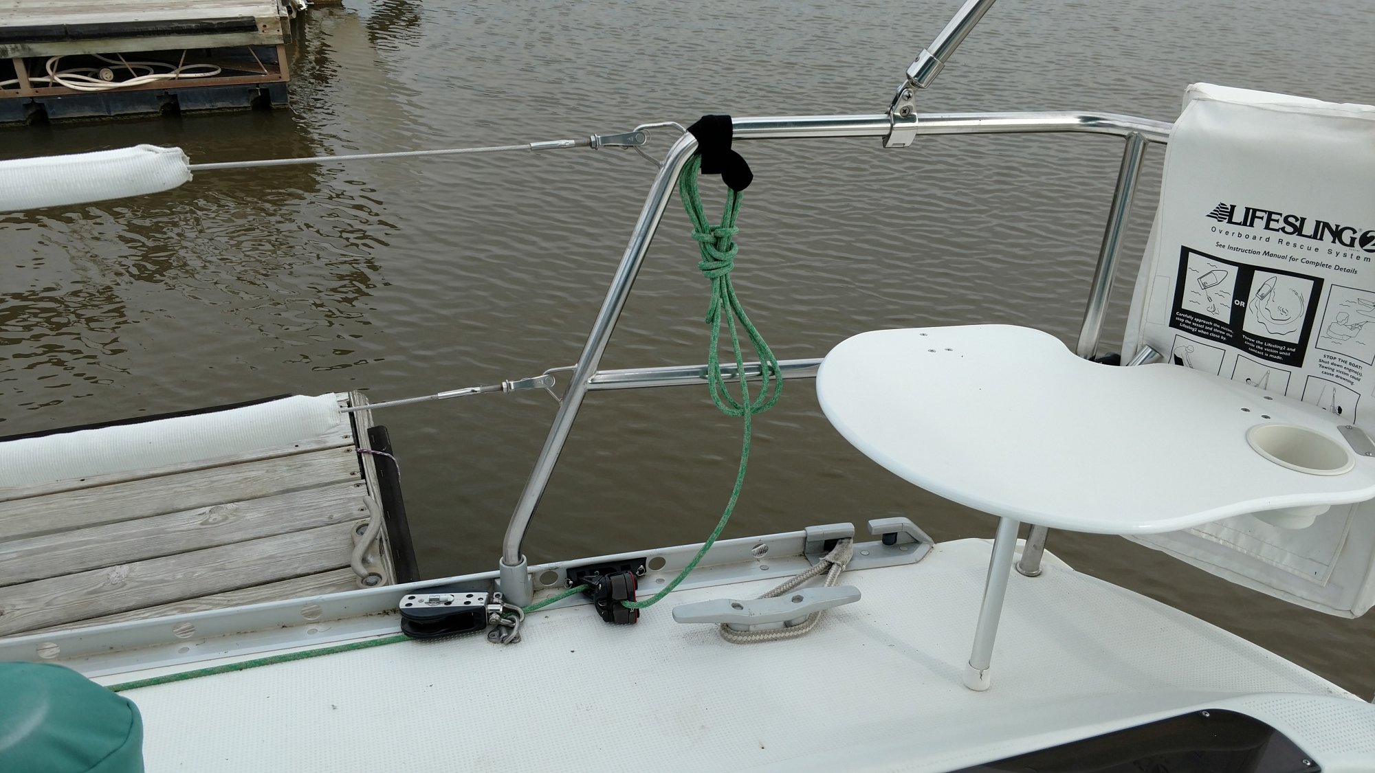

In discussion with the North Sail loft, they told me that if I was concerned about the furler drum, I could attach a turning block on the bow pulpit. I have not needed to do that.
"Quick-release shackle."
This term is most often used to identify a Snap shackle. Having gotten smacked on the foredeck by one weighing in at 10 ounces of metal, I have replaced them with Dyneema soft shackles. Stronger, lighter 0.05lb (if that), no rust, easy to change or cut away if necessary, and if you get hit by it, it will not knock you out. At less than $5 in materials, it is a game changer.

Thanks for the picture, that's really helpful. Incidentally, that block appears to point *back* a bit even though the tack line points forward.

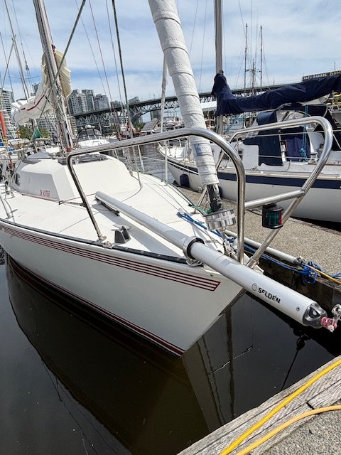

Briefly, lots happened and I never pursued the bowsprit dream...but over the years I learned a great deal about using an asymmetrical on a 27 foot boat. First, you don't need a dousing sock, a takedown line is better but still unnecessary, second parrel beads are way, way cheaper than an ATN Tacker (but didn't I say hooking on to the forestay is not so good), oh well, shoot me.... continuing, an easily adjustable tack line is paramount if you want decent, or better, performance. Fourth, your sails trim better with twings, Five never sail below 135 deg True, which is close to 90 deg Apparent or the wind will never stay attached, try to keep the tack as far forward as you can. There's more but I'm losing steam here.
Bowsprit, okay, here's something I tried, I attached a restraining cable from the stem to the middle of the pulpit, then clipped a fairlead to the tubing on the pulpit. The idea was to create an alternate to a sprit, the tackline running through the lead on the pulpit... Unbelievably it worked well. but the cable's angle from the stem was a little to obtuse and I could see the tubing lift a little and it wasn't even blowing that hard, so I, uh, decided to restrict that method to under 10 or 12 kts until I could bet a more robust support cable. But... I started getting lazy the last few years and find I just have fun without running to the foredeck. I still dream about one of those very cool Selden retractable bowsprits though... and I'll be 80 next year... so there's still time... if there's any value left in my retirement account that is.

The pulpit turning block is turning less than 5 degrees. The block attached to the deck will turn 90 degrees and will need to deal with the forces.
If your racing and flying a spinnaker in winds beyond it’s rating
You are likely to experience sail failure before block failure.

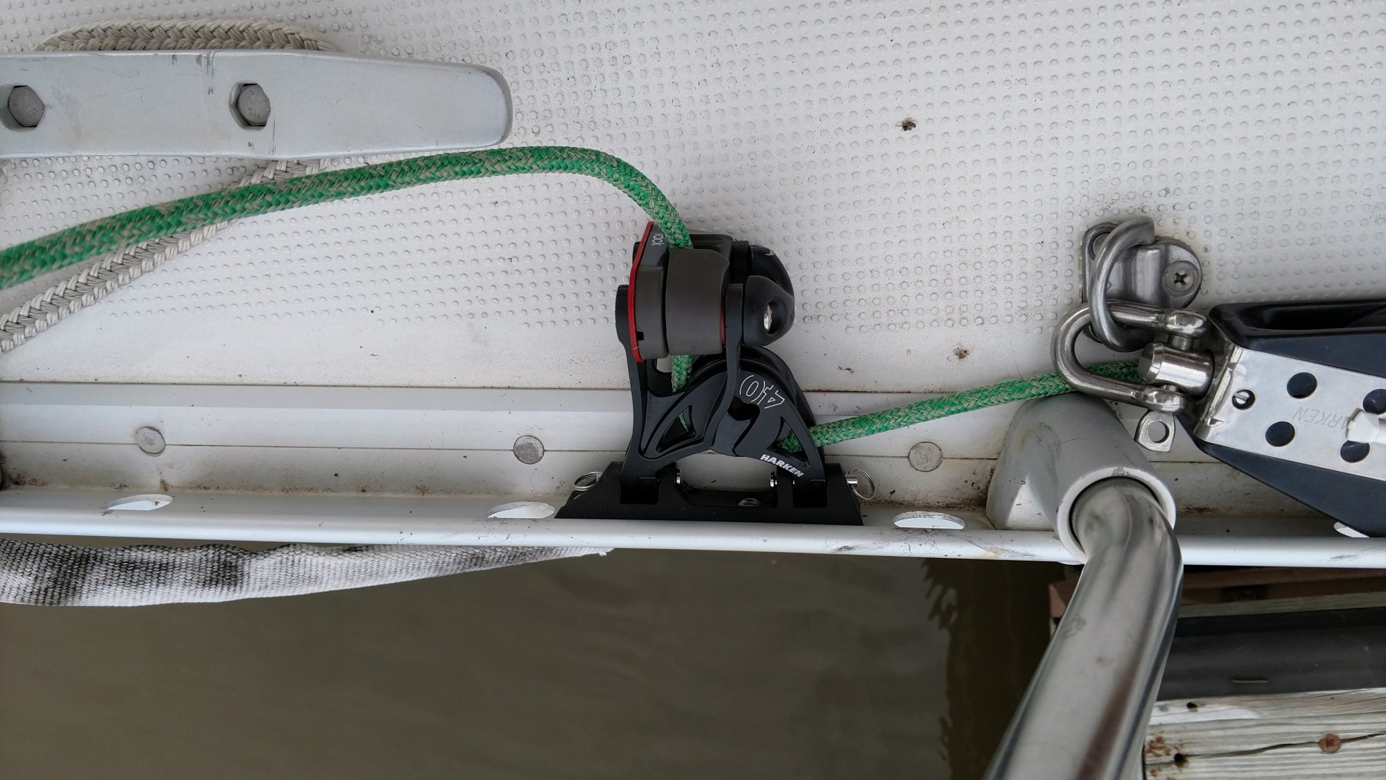

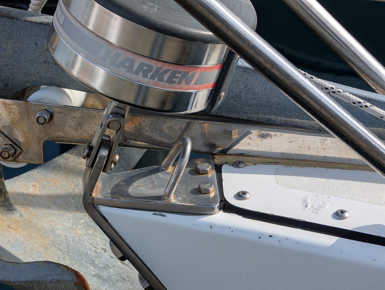

Mine is routed through a turning block attached at the base of the forestay (the bracket that the forestay is attached to that is bolted to the deck and down the bow). Not ideal as it isn't projected forward as I would like but it mostly works. Jibing is sometimes a challenge as the line and sail have some trouble getting around the bow pulpit. This setup will ultimately be replaced with a Selden bowsprit that can be deployed when needed to get the projection I desire. Tack line is run along the rail to the cockpit where it is cleated with a headknocker within reach of me and the crew.

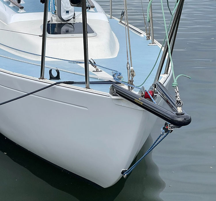

As @Davidasailor26 suggests, tacking an asym to the bow pulpit is not a good idea. It is not designed for that kind of load. The anchor roller is much stronger and better suited for the pull and shocks of an asym. It is also worth noting that even using the anchor roller the asym may not provide improved performance. In our PHRF area tacking an asym on your boat's bow roller would add 3 seconds to your All-Purpose (discance) rating and 9 seconds to your Windward/Leeward (shorter, round-the-buoys) rating. In other words, our PHRF Committee thinks an asym on your bow roller is slower than the standard symmetrical chute setup. You would need a sprit more than 2 feet long before our PHRF Committee started to think it was faster, and that would only be for distance races. Until you got to a sprit over 3' long you'd still be considered 3 seconds a mile slower with the asym on Windward/Leeward courses.
PaulK
Dec 1, 2009
1,462
Sabre 402 Southport, CT
Like this....which isn't quite fully retracted but the pole can be shorter, eh?
The problem is that a sprit shorter than 2' on a boat the OP's size isn't faster than a regular symmetrical spinnaker would be. A shorter pole also makes gybing trickier, since the sail is closer to the forestay than it would be with a longer sprit.

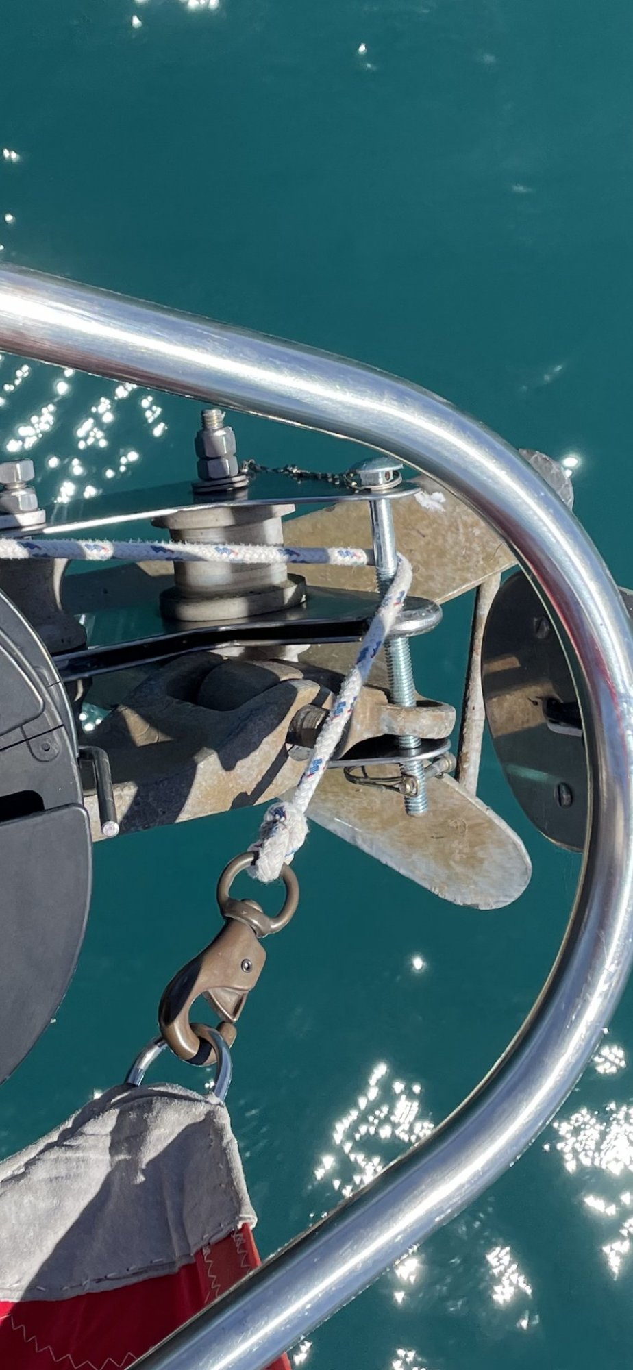

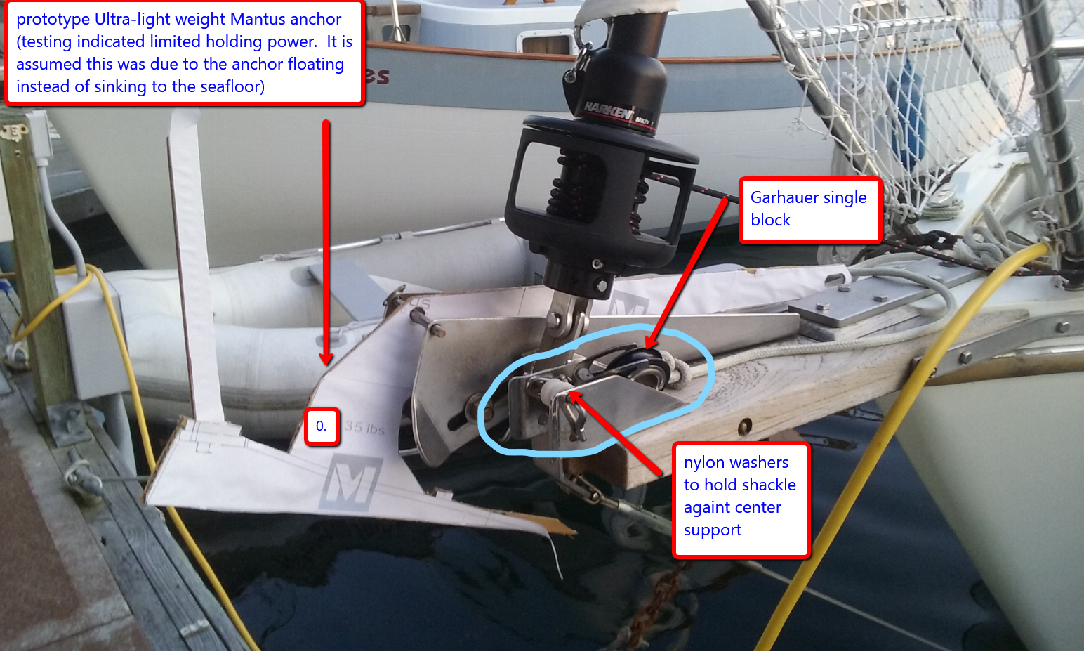

I am sure I will get sh!t for this, but on my O’Day 322, when I want to fly my spinnaker, I put a block on my old plow anchor cross brace and run the tack line down to the block, then back to a cleat. The anchor is pinned at the roller and can’t move (and I don’t feel a ton of on the line. It gets the tack as far out front as I can without some sort of pole out front.
In this photo, the tack line is just routed down and under the anchor pin. Last year I added the block (which works a lot better).
Greg
23,843
Yes, Greg, the block is better than a bolt. Running the line over the threads of a bolt is a quick way to chafe the line.
At least you were able to prove the concept and go forward. I like it.

Are you flying that inside the pulpit? Looks like you could route it outside. Some lash a ring to the pulpit to feed tack line through helps keep from blowing off sideways.
I'm flying my asso inside off the bow roller which is 18" from the forestay. I'm allowed another 6" w/o a rating hit but I'd like to go 12" more to 30" to get that thing outside the pulpit and pulling proper.
