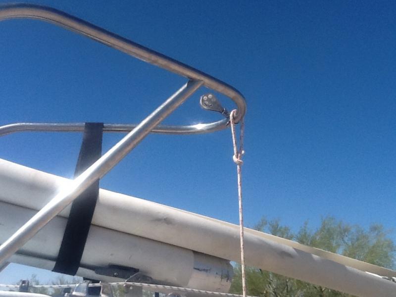

That's actuality pretty clever. If it were my boat, I'd look to modify that solution to account for side loads while reaching; some way to triangulate that base. As it is, it relies on the strength of those joints to hold up to a big load. But its a great start.

I had a piece of lifeline gate wire cable swaged and added 2 shackles. My forward forestay attachment point is open as my furler is in the rear one. I just attach the wire to the clew of the Assym. I then use one of the ATN tackers to control the luff. Doesn't work well but I'm not a racer!

I installed a block to the pulpit, front and center.
I use some parrel beads around the forestay to take as much lateral strain off the tackline as possible.
Works fine so far, but I'm pretty conservative. It did get thrashed about darned good on my last outing, with no ill effects.
Edit- Sorry about the photo orientation.

This looks like a pretty workable solution. It never occurred to me to use the pulpit as an attachment point.

I did something similar without the extra cable, attached a block to hole just forward of where the forestay pins. Ran the line back to the cockpit. I haven't used it in a long time but it seemed to work ok for my needs. I have a tacker as well. Didn't think about attaching it to the pulpit, might be a better location if it can handle the loads ok.

Gents, just make sure that you secure the bow pulpit as I have heard and seen of bow pulpits that had to be repaired or replaced when not secured all that well.
