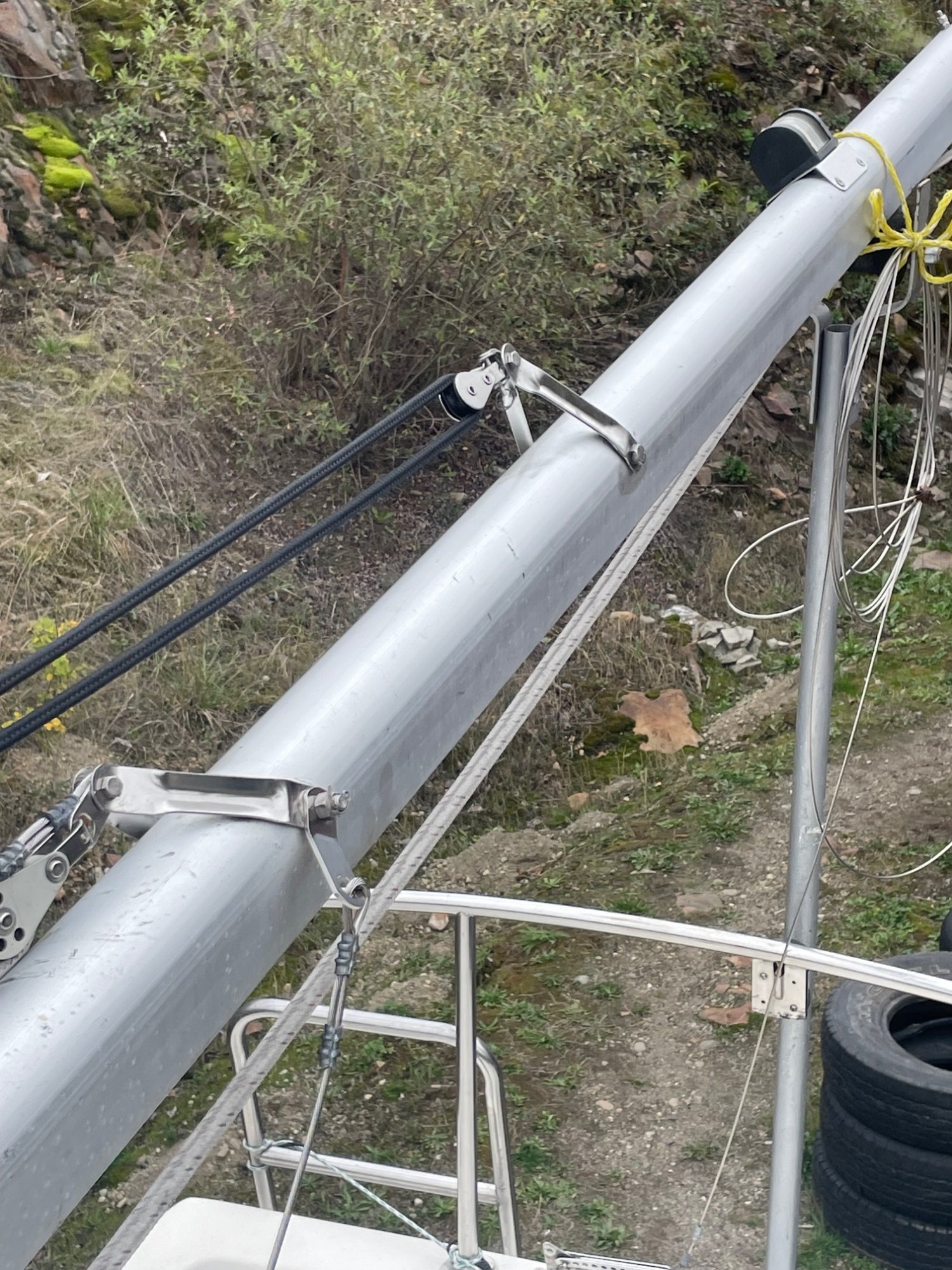

More reading more research. I have found an add a halyard kit from Blue Water Yachts. It even gives the recommended 18 to 24 inches above the headstay to mount it.

Judging by where you put the new halyard from your picture I am assuming your rig is fractional - the jib head goes to mid-mast not the masthead. I mention this because your asym can’t be that large. And if you are sailing in light wind the loads on the sail aren’t going to be that large. I predict that you may be perfectly comfortable trimming by hand having only one wrap on the winch. Of course you’ll want to be able to cleat the sheet to attend to other matters. I don’t expect a “Hair on fire” experience for you. Spinnaker trim is about not over trimming. Generally you want to get sail out away from the boat keeping it well “Ventilated.” Tell tales are of limited use. So it’s “When in doubt, let it out” situation.

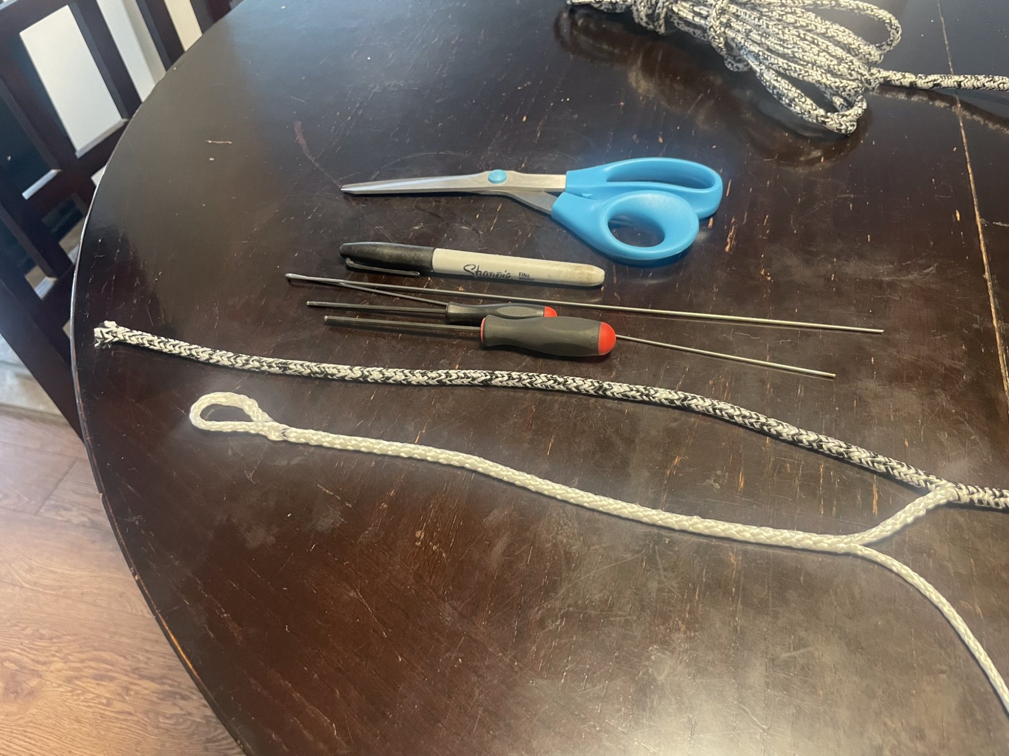

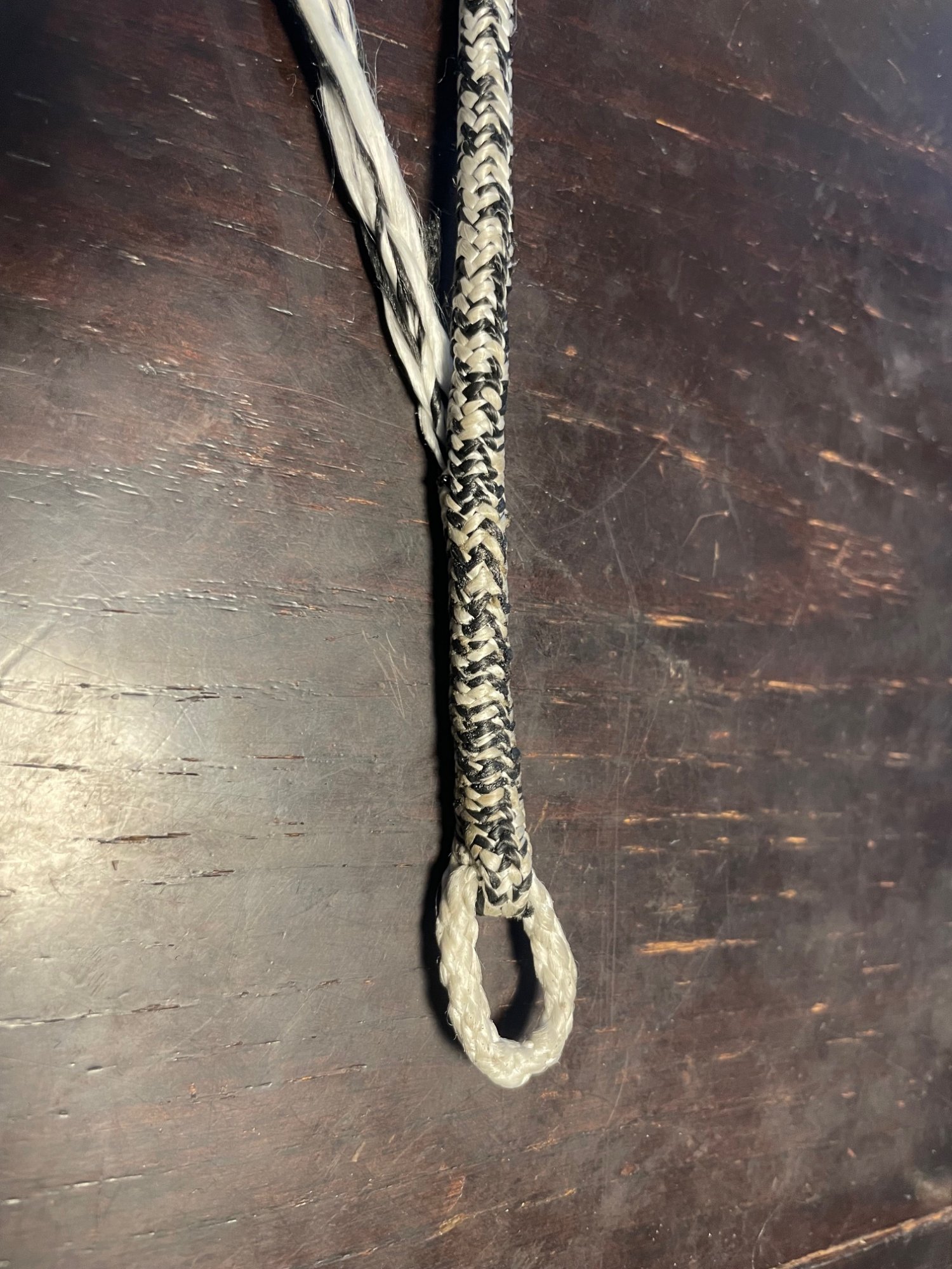

Turns out I have a dyneema core with polyester/dyneema cover. My very first eye splice on 6mm line. I had to try twice. Both times I made it through the locking Brummel, pulled the dyneema core back into itself. I was then able to return the cover back up to the eye. I had troubles after this pulling the excess cover between the eye and back inside itself. I think I went a bit short on the final but I do believe it will be strong. I’m happy. I will do it again for sure.
Ah, that makes more sense for a control line like a tack line. Splicing covered dyneema is something I haven't tried advancing to yet. Good on you for giving that a try.

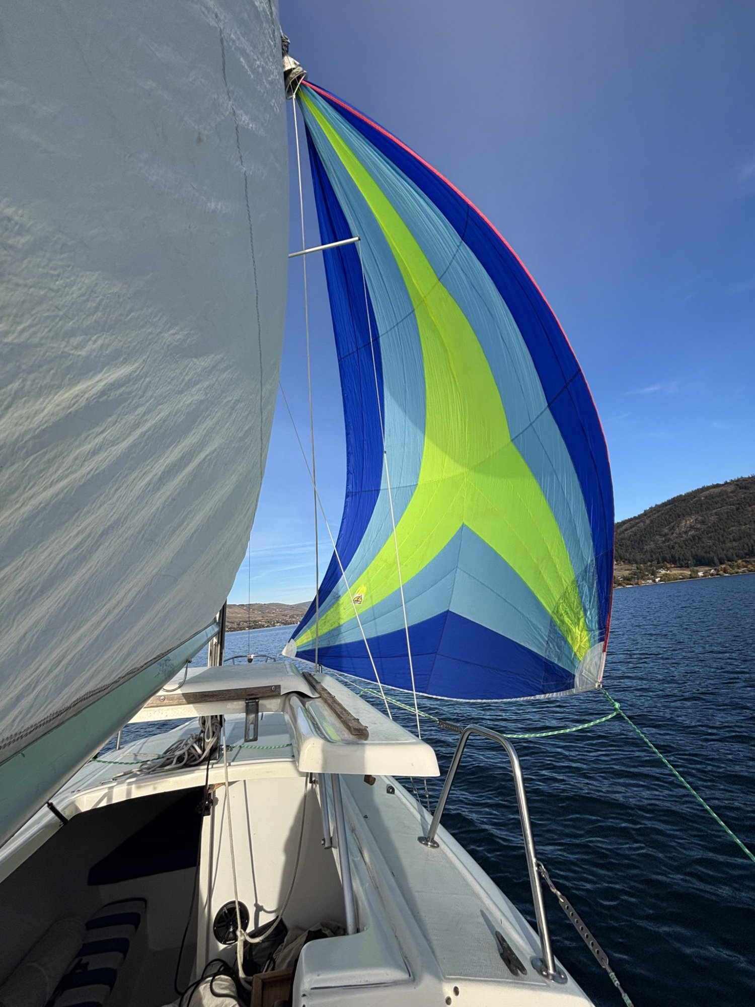

What a day. Almost no wind to speak of but eventually we enjoyed enough to hit 2 knots. That took us out far enough to enjoy lunch. After that we started setting up to fly the Spinnaker. After watching a few you tube videos, I learned that many just cleat that tack line off. I purchased a Lewmar 50mm block for the tack and a couple of 35’s for the rear turn blocks for the Spinnaker sheets. Turns out our cleat is too close to the mount for the tack line block. I ended up using a bowline and a set length tack. We did use our splice :)
We were fortunate to have a very light breeze for the journey home; just enough to fly our Spinnaker. It was gently unorganized. Likely quite stimulating if we had a good wind, but we did it. I must improve my rope handling skills. More organization is required too. Extra cleats on mast and bow.
