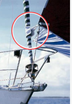

Attach the tack to the end of the bow forward of the jib then to a cleat and clew to spin sheets to an aft turning blocks then to a winch in the cockpit. Refer to the following link on rigging an asym on your sailboat: Rigging the Asymmetrical Spinnaker (fxsails.com). Next study up on deploying, dousing and jibbing the spinnaker. Then go fly it!!

To rig an adjustable TACK line on any boat, attach a block to the stemhead fitting. That's where your forestay and headsail's tack (or RF drum) will attach to the boat. There are normally 3 holes in the stemhead fitting, if not, you'll need to get creative with dyneema or wire. The tack line will run through this block and back to a convenient cleat near the cockpit. It also helps to have a winch nearby, just in case. On my 27 ft. boat I use 5/16 double braid dacron. This line will take a load.... so...the winch and good line will help. I have a snap shackle for the sail connection end of the line.... but I never release it under load, preferring to ease the whole line for dousing.
With the adjustable tack line you essentially have the option of changing the draft of the sail depending on point of sail. The closer to the wind, the flatter you'll want it, so the tack comes down low to the pullpit, which also brings the sail forward. Farther off the wind, easing the tack line will raise it and give you a fuller profile.
Finally, a sprit is very, very cool... but you can enjoy the sail without it. Also, a "tacker" is often mentioned. My North asym came with one made out of sail cloth. But... I don't need it now because I'm rigged for hank on sails. So I attached a snap hook to my tack line that clips to the forestay. I probably use it 15% of the time....

ATN makes a device called a Tacker. It wraps around the furled headsail and allows you to work the sail. Check ATN's website or You Tube..
