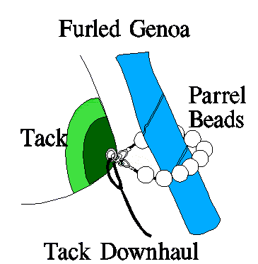

You use an adjustable tack line(or "tack downhaul"). This allows you to adjust the height of the tack (lowering flattens, raising makes it fuller) The picture shows a purchase set up... good idea if you don't have a spare winch. My 27 footer uses a 2:1 system which allows hand adjustment in most conditions.
Some skippers like to attach the tack to the forestay. The picture below shows one method. If you don't have roller furling, a simple snap hook at the upper end of the tack line will allow you clip it to the forestay.
Personally, I don't attach it... because it means you have to go all the way to the pulpit to engage and dis engage... I'd rather stay back near the mast. and do everything from there. On a 25 foot boat I don't think a furling sock is necessary. A spinnaker turtle bag, with a hoop to keep the top open, works a lot better.

Thanks Joe. pictures always help. I guess what I was missing in my vision was the use of the adjustable tack line. though now I can see that having one does provide multiple benefits. somehow I was envisioning the tack of the spin being attached more directly to the base of the forestay, or bowsprit. So as long as the spinnaker I get (haven't purchased one yet) can be raised high enough for the foot to clear the pulpit, I should be golden....... I think ;) .
I have a hank on jib BTW.
Thanks again.

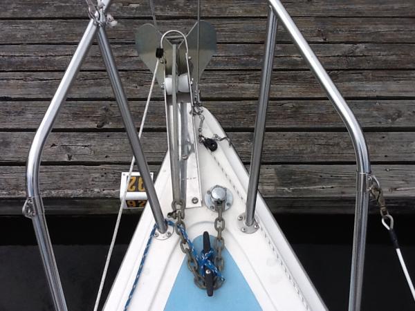

I put a bail on my anchor roller and gave a swivel block on the bail. My tack line runs forward through fair leads on the cabin sides and a swivel block on the bottom of the rear pulpit support to feed it to the block on the bail.
Huummmm. interesting idea. although I don't have a bow anchor launcher.
Thanks!

There is quite a load on the tack... so... whatever you anchor it to should be able to handle those upward forces. Although the sail works quite well without one, adding a bowsprit will improve performance and won't interfere with the jib. The bowsprit must be able to handle the torsion loads though, so if you're going that route, do some research. On my wish list is the very cool Selden kit....nice.
SideBar....... A few years back I got creative and added a Johnson stanchion mount fairlead to the bowsprit, then I ran a rope guy down to the shackle on the stem to give it support. Even so the leverage on the pulpit rail was noticeable... I could see it lifting a bit, even with the extra support. Essentially, I lost confidence in the jury rig and took it down... I eventually found that I liked the way the sail performed NOT ATTACHED to the forestay.

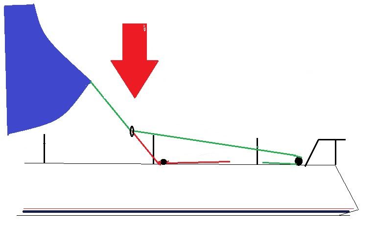

......I see a line spliced into the sheets in your video..... what's it called?... a tweeter, or tweeker, or some such ;) . where do you have the control end of that line. it seems that could get a little messy over the cockpit area??......
A tweaker.... or "twing" is a handy thing and quite easy to set up. The twing acts like a jibsheet fair lead. It also enables you to control the clew height and stabilize it.
The twing is not spliced to the sheet. ... but hey... rather than trying to explain ad naseum try googling "spinnaker twing" for many pictures and articles on how they are rigged(there are numerous methods) and used.

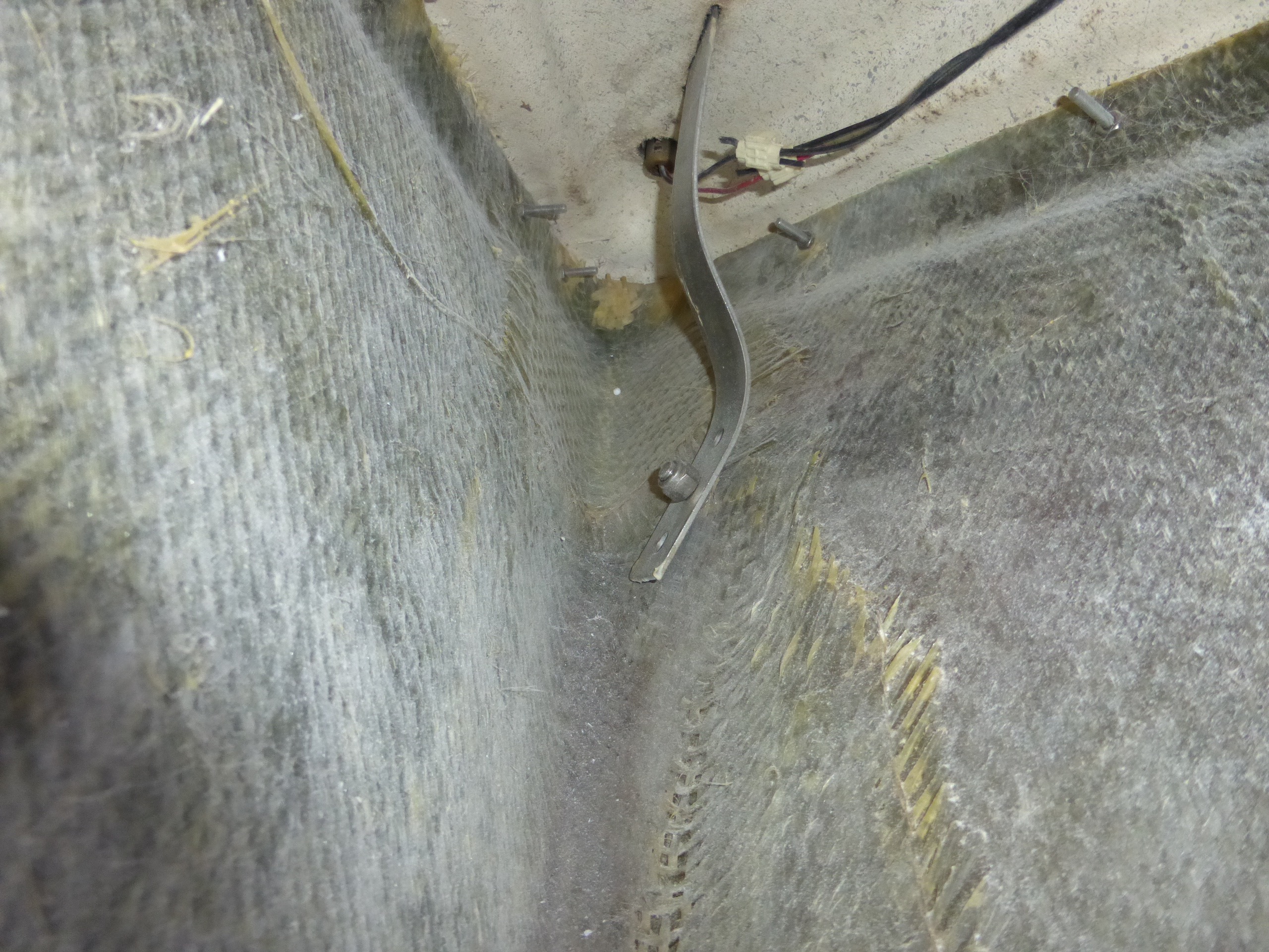

Today I'm doing preliminary work with the goal of installing a short internal bowsprit. the first order of business is to redesign the forestay anchor :yikes:. holy crap I can not believe that Mac would have built this this way, but it sure looks to be OEM from top to bottom. I always thought it was odd that there was only one bolt showing in the hull which I figured went to secure the forestay, but after I get inside there I also see this haphazardly bent chunk of SS that doesn't even lay flat on the inside of the hull where that one bolt goes through. the upper end is free floating where it goes through a slot in the upper deck. the only reinforcement at the slot is a SS "cap" that's pop riveted on the outside. :doh:
I have some SS strap ordered to fabricate a new system that will branch out near the inside of the upper deck and bolt to both sides of the hull. the bowsprit will need to go between the legs of the new one. the current single leg design is right in the way.
The beat goes on............... ;)
[/QUOTE]
My old V224 has (had) the same setup. Thousands of boats were probably made with the same arrangement.
Must not have been too awful dangerous.
I've since changed it anyway due to the anchor roller becoming the fore chain plate....
Yes, you're right of course. It's been a terrific boat for us and we do love it. perhaps I was a bit harsh. I was just surprised to see what appears as a lack of pride in construction of that piece of hardware. lots more good things on the Mac than bad things for sure.

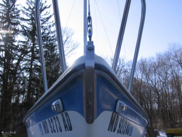

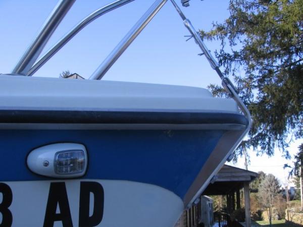

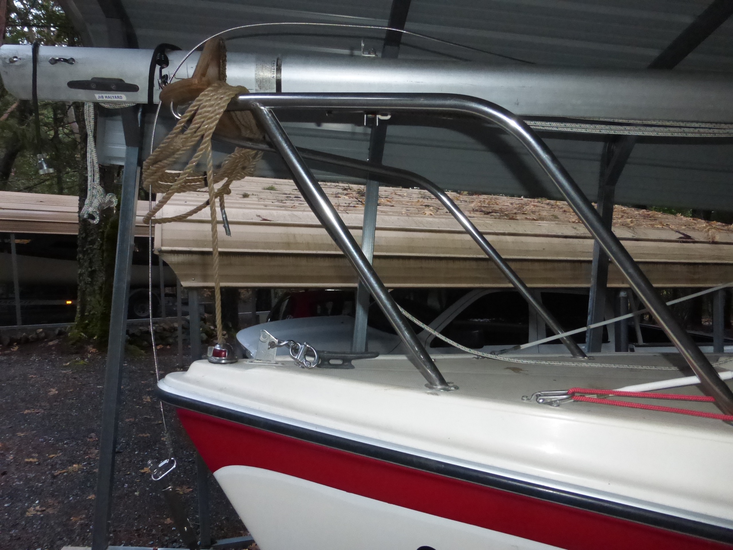

Russ, its easy to make a proper stem fitting.
Well now you went and did it....... I had my plan for a bowsprit all worked out and you go and give me this whole new idea :laugh: .
Actually I could take some design elements of your system and make a base to attach a stand up block for the tack line, right off the bow ........................... hummmmmmmm . My short bowsprit idea would put the tack line forward another 6-8" however, and gain that clearance from the slightly overhanging pulpit..... I need to go stare at the bow a wile longer, but the neighbors are already starting to talk. ;)
