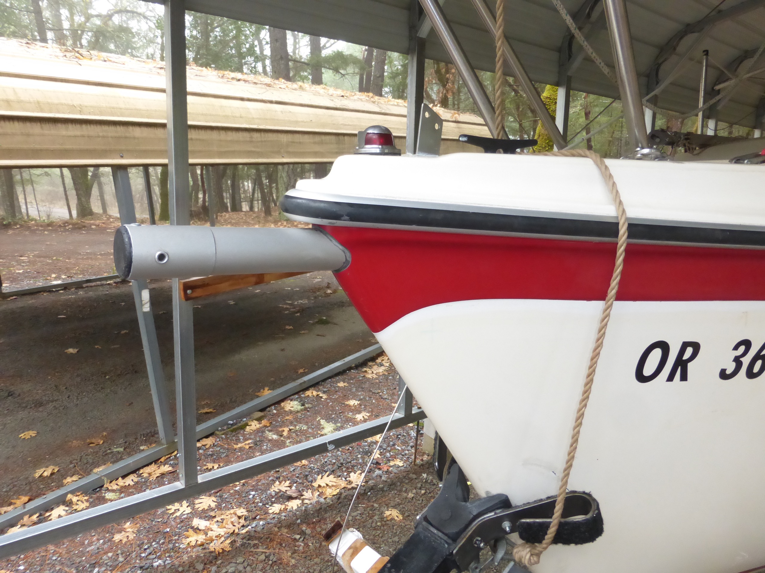

I've continued to work on the bowsprit, but was forced to take a couple days off to go sailing ;) we've been having an indian summer, in the 60s, for the past week or more, so we took advantage.
As with any project, there are compromises to be made. I ended up with a sprit that extends just 8" beyond the bow. this is a fixed sprit, so having it hang out any further just swung the hassle meter too far to the left for me. I'll have to wait until the spinnaker goes up for the first time to really know if my choice was a good ones or not. 8" forward doesn't give a straight shot past the bow pulpit (which is straight above the nose of the bow) to the new halyard block, but hopefully it's close enough to not cause any issues. I do have a backup plan for a removable bowsprit extension if I really find the current configuration unacceptable, but we'll see how this works out first. The reconfigured forestay anchor and the other hard stuff is done now, so future modifications should be much easier ;)
There will be a swivel block attached via shackle in the sprit to run the tack line back to the cockpit. or at least back to the mast, BTW.

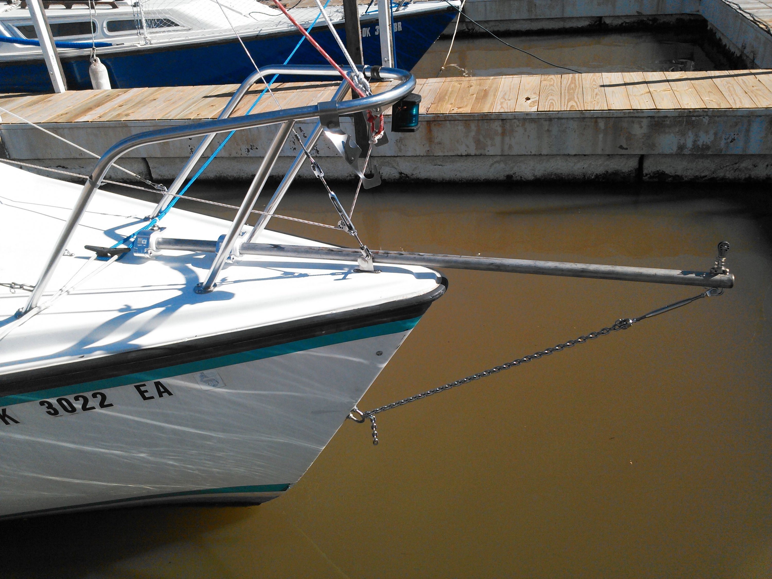

Russ, your bowsprit material looks very familiar. In fact I had comtemplated using an old U2 crossbar for my Mac because of the light weight. I ended up using a scrap ss heavy wall pipe from work instead just because I wasn't sure if the lateral loads would be excexsive for the length I wanted.

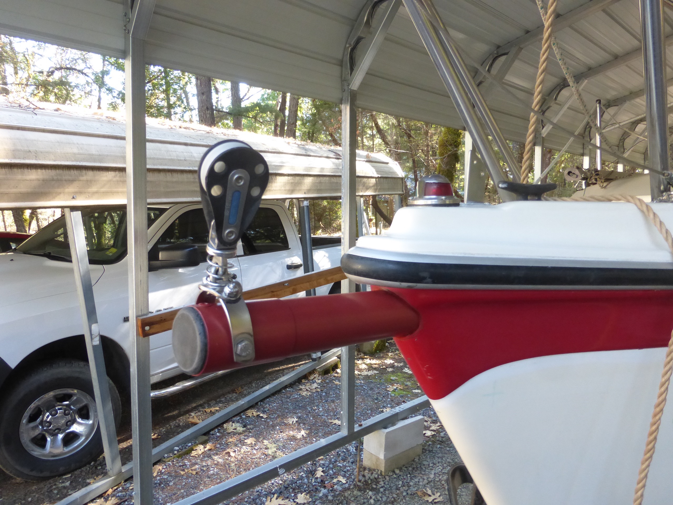

All we need now is some spring weather to try this thing out and see what needs changing or adjusting ;)

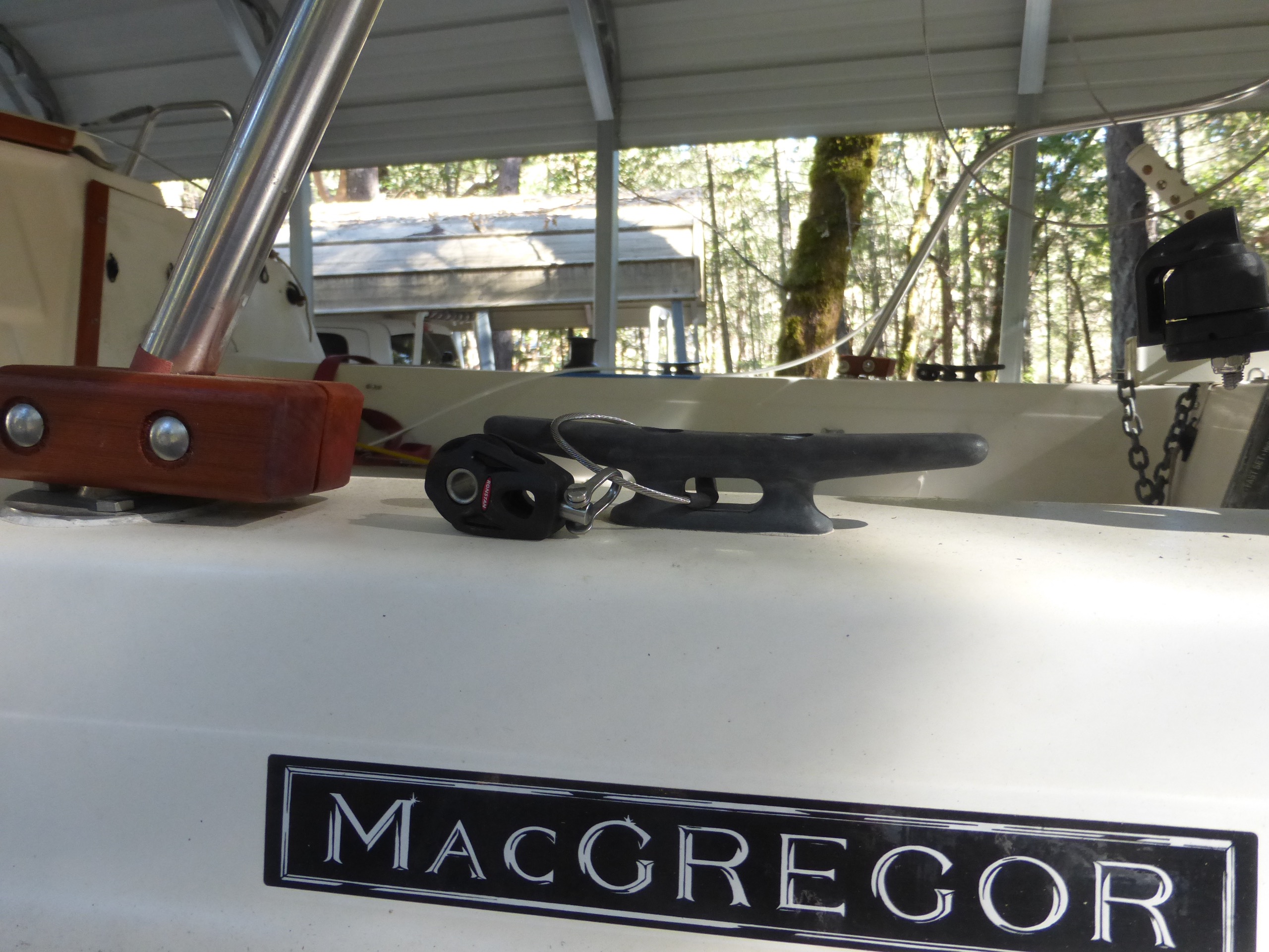

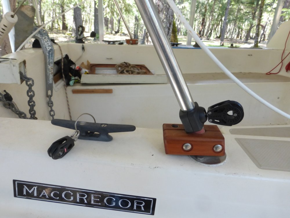

Not sure about the sheet block anchors, but it'll do for now until I figure out a better way. maybe some stand up blocks directly on the deck near the cleat. I used nicopress sleeves, covered them with heat shrink to protect from burrs, so it should be strong enough, but maybe not the most aesthetically pleasing. ;)

I'll have to dig my notes out on the luff length, but mine is also from BWY (Doyle) and I placed my spin halyard block at ~18" above the jib block. I've only hoisted it on the water once so far, and that was in nil - 2kt wind, but I'm happy with all my "compromises" so far. I did change the sheet block placement (see pic) , but just to clean things up a bit. the cabled on block in the horn cleat was removed and the pulpit mounted one replaced it.

Thanks to the THECUSCUS and RussC for the responses and pictures. It looks from the picture that RussC posted the tack is pretty close to deck level. If you were to try to attach the tack to the forestay which is discussed in this thread then the tack would have to be high enough for the foot to clear the pulpit or at least the lifelines. I'm not sure that is what I want to do but it brings in question how high the tack "should" be. I guess as THECUSCUS suggested, using the foresail halyard as a test will tell me for sure where the tack will end up. I like the pulpit mount turning block.
